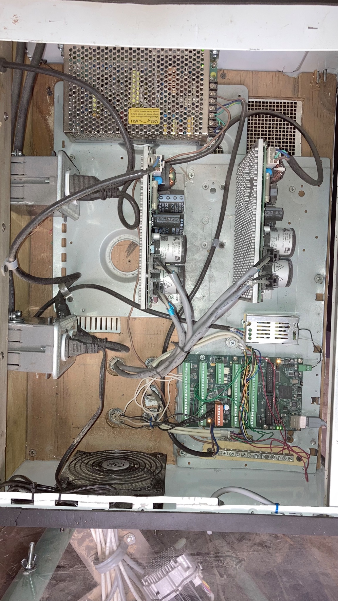

Hello!
I hope your day is going ok. I've taken over my dad's self-made LinuxCNC machine. He's still here but he doesn't use it anymore and told me it's mine so I'm trying to figure out how to use it for making some fancy wood projects. I've spent more than a month trying to figure things out and he doesn't seem to remember a lot of it. Now I hopefully only have a few more things to figure out and I might have it somewhat ready to use properly. Although a lot of time I spent screwing with FreeCAD before deciding to just get Vectric VCarve which I don't regret at all, totally worth the price for the time it saves messing with FreeCAD. FreeCAD is great but I just couldn't get it to do what I wanted properly and was always running into bugs and it was always crashing on me.
Anyway, as far as LinuxCNC and the router itself, here are the issues I'm having with that. Any help or tips are more than welcome. I appreciate anything you can help with. Thank you for taking a look!

Here is a list of hardware if it's relevant:
Mesa 7I76E | manual
Teknic ClearPath-SDSK Servos
Spindle
HY01D523B-VFD | manual
vistaCNC iMachIII P2-S pendant

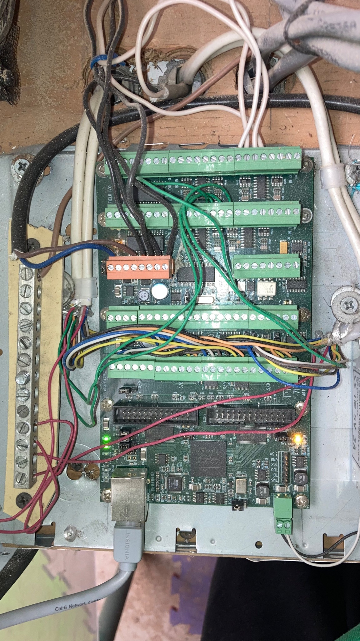

Well it seems we have to get at least 18ft of wire to be able to reach where the switch has to be. First though I'm still trying to figure out how to properly test it before going through all that trouble of mounting it. I found out where to mount it and now just have to figure out how to hook it up and test it. I added some images of the Mesa board that my dad setup. I'm going to have to read a bunch more and see if I can understand it but if anyone has any pointers I'm happy to hear them.

Those should work, I use something similar on most of my machines. They only work with steel, not aluminum.
If memory serves
Brown is +
Black goes to mesa (signal wire)
Blue is -
The sensor usually has a wiring diagram on the sticker
The easy way to test this
Hook up power leave the signal wire unplugged.
Put a piece of steel by it, light should light up on the back of it.
Now plug the signal into the next open digital input on the mesa
Move piece of steel and make sure mesa led lights up (or turns off if it's on by default)
You will need to configure your hal file so it's looking at the right input. Chances are if you used pnf config you did this without knowing it.
Now when you try to home z will go first. Shake a piece of steel in front so it turns the sensor on and off about once a second until the y axis starts going.
If it doesn't let us know what's going on and we will help more.

I just thought I would give an update. We managed to get one of the switches hooked up properly and the z-axis homing working. Woohoo! Thanks to everyone for their help and suggestions and taking the time to read my surely nonsensical ramblings. You helped me a lot.
I played with the motors a bit and set the y-axis motors to increase the stiffness in the fine-tuning which hopefully helps with some of the dots. It doesn't seem to vibrate much after we simulated the y-axis weight on the x-axis and did auto-tuning in the ClearPath MSP software and then copied the config to both of the y-axis motors. I'll try adjusting the I or the deadband after that process and see if that helps now because I only tried those before doing that to try and fix the vibration issue and it didn't work. Auto-tuning on the x-axis simulating the y-axis as best we could is what helped with that.
A note that for the LJ18A3-8-Z/AX inductive proximity sensor switch I hooked the black wire to the field input 8 which was the first available digital input. I'm not sure if 0-3 were digital because they weren't hooked up to anything. The other switches were hooked up to 4-7 and in a video I saw someone say they were capable of analogue so I used 8 instead. I thought I remembered reading something in the Mesa board manual about all of them being capable of analogue but maybe I'm not understanding something properly there which wouldn't be surprising. But it works like this so I don't think I'm going to worry about it. I hooked up the blue wire to the field power ground on the Mesa board and the brown wire to the power on the same orange field power block. This seemed to be the right way. The light on the switch is always on until it detects metal. This actually works.

Sorry, looks like I lost a post or was distracted. The 7i76e which I saw you were using should use PNP prox sensors and your link was NPN.
You can use NPN sensors with a 2.2 k 1 W pullup resistor.
You may be able to set up a brake with your servo drive on the Z axis.

Hmm, so the thing I'm using shouldn't actually work or is it just going to be damaging in some way if I run it like that or cause other issues then? It does seem to be working the way I hooked it up but if it's going to wreck something maybe it's not good to run it like that.
Also, where should I place the resistor? I'll see if I can figure out how to go about doing that if it's something I should be doing to prevent damage somehow.
A brake sounds exactly like what I might want to use too. I'm guessing there are specific types or brands I should be looking for to make it brake when the power is lost to prevent the spindle from falling. I have absolutely no idea how to determine if it's going to be compatible with things or even how to go about hooking one up but I suppose that's some more things I'll have to research.
Thank you!
