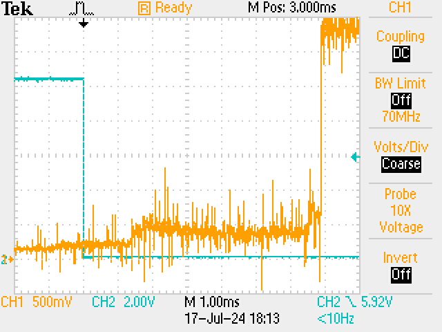

I'm trying to build a simple 3D touch probe (the "6 balls/3 pins" kind). Probing seems to work but it's currently not very accurate (calculated pretravel variation of ~70um). I'm using LinuxCNC 2.9.2 with Mesa 7i92+7i76 on an i3-2100. Probe Basic as GUI.
While looking at my oscilloscope trace of the trigger signal, I was wondering how fast I should expect the movement to stop once motion.probe-input is triggered. Is it normal to expect a 5-10+ ms delay or there is something wrong with my setup? What I'm seeing is that even though the probe triggers immediately after a light touch to the object, the probe switch opens after some time (as if movement towards the target of G38.2 continues). Is this behavior normal?
Even if there is a significant delay, should I expect the value reported in #5061/#5062/etc. to be the exact position when motion.probe-input has been triggered?
Looking at the code (github.com/LinuxCNC/linuxcnc/blob/master...otion/control.c#L693) the position is saved immediately upon triggering and tpAbort is called (tp == trajectory planner?). Assuming that this code is called from the 25us thread, it seems strange to see the probe switch open after 10ms.
Attached is a capture from the oscilloscope. Channel 1 is the voltage at the probe (probe is the lower leg of a resistive divider) and Channel 2 is the trigger signal.
Thanks in advance.

Maybe I am not understanding the question, but after triggering the probe
the joint must obey the ini file set acceleration bounds when coming to a stop
and reversing. This could easily be many mS.

You are absolutely right. For some reason I totally forgot about deceleration. Probably because the probing speed I'm using is too low (50mm/min). I'll have to check my ini settings and try to calculate the total distance required for stopping after the probe triggers.
So, if this is the reason I'm observing this behavior, I should expect the probed position (#5061/etc) to correspond to the timestep when motion.probe-input was triggered, right? So, the maximum expected error to the probed position from LinuxCNC itself should be the distance the probe travels in 25us interval between motion.probe-input checks. Am I right?

Over travel in G38.x does not influence the stored position, it would be fairly useless if it did:
After successful probing, parameters 5061 to 5069 will be set to the coordinates of X, Y, Z, A, B, C, U, V, W of the location of the controlled point at the time the probe changed state.
linuxcnc.org/docs/html/gcode/g-code.html#gcode:g38

(every thread cycle; 25us by default?)
Depends on your Servo Thread, usually 1ms for a Mesa setup.
Yeah. I just found out that I mixed the times of the servo and base threads in my head :) So motion.probe-input is checked every 1ms. That means that I have to calculate how much distance the probe can travel in 1ms to see what's the expected error in my calculations.
