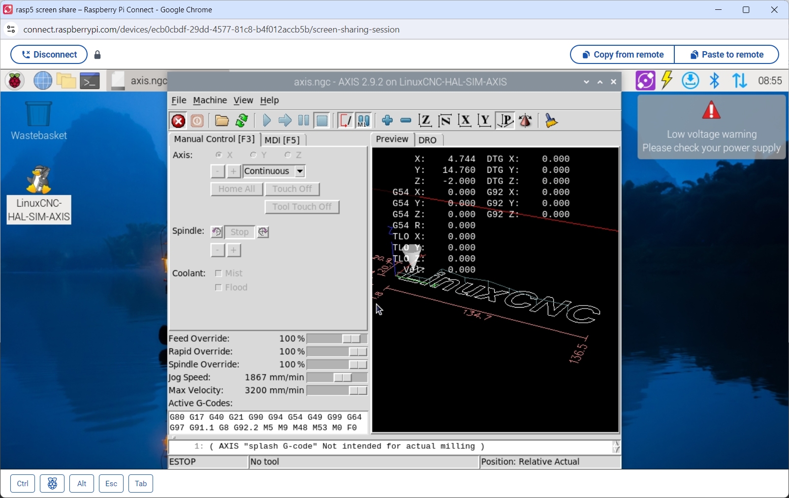

If your problem is to only view LinuxCNC on Windows and you are not interested in the desktop of the Linux machine I recommend using an X-Terminal like MobaXterm
mobaxterm.mobatek.net/
Alternatively you can see how this new feature works
www.raspberrypi.com/documentation/services/connect.html

Raspi connect is something I would not use because of the need for cloud connection.
I advice using only services using local network for machine control.
Replied by ississ on topic I want to create a VNC in linuxcnc running in raspberry pi 5
One drawback for a terminal is that probably you are not be able to connect to a running process (in this case linuxcnc) but you have to start it inside the terminal. For us that have configuration to start linuxcnc automatically on boot this won't work.If your problem is to only view LinuxCNC on Windows and you are not interested in the desktop of the Linux machine I recommend using an X-Terminal like MobaXterm
