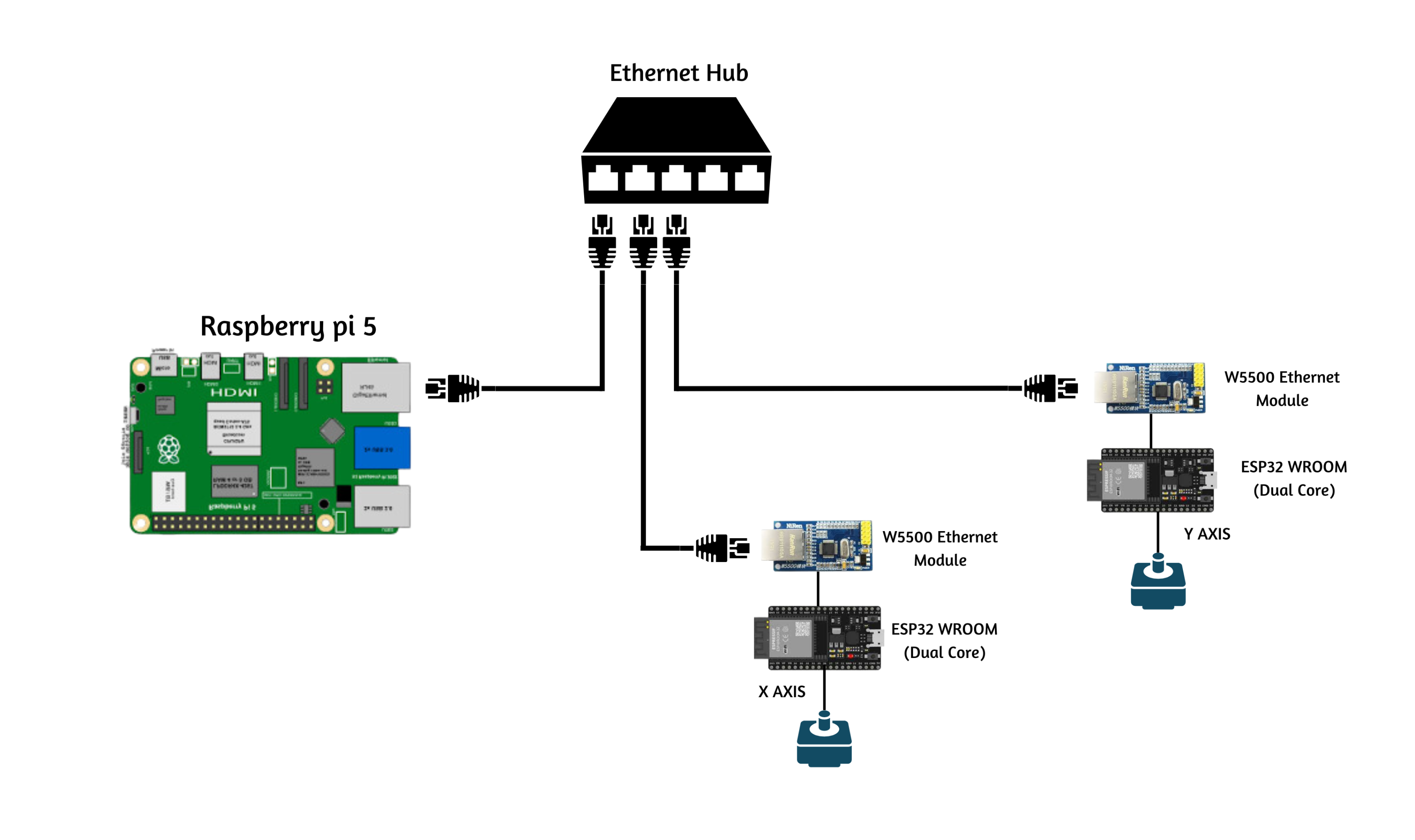

Hello community, I have tried github.com/jzolee/HAL2UDP, an external step generator: ESP32 for 3-axis in a single ESP32. But, I want to use individual ESP32 for individual motors to have extra I/O pins that can be used for other purposes.
See the image attached below for your understanding.
Please let me know if anyone has any idea.
Thankyou
Thankyou

Whilst this can probably be done, it does feel like a lot of work to address a solved problem?
Might it not be better (if you really want to invent your own system and write your own drivers) to use some of the "smart" stepper drivers that accept pulse-rate requests over SPI?
Or, if your priority is a working CNC system, rather than a fun project: store.mesanet.com/index.php?route=produc...rt=p.price&order=ASC

Haven’t you asked this question before ?
Would each board require its own read & write thread ?
By the time you buy 3 ESP32 and the Ethernet modules you can get a Spartan 6 dev board off AliExpress one w5500 Ethernet module and use the riocore firmware and have about 72 i/o pins.
All the drivers for Linuxcnc are already written, there’s a great GUI to config everything.
