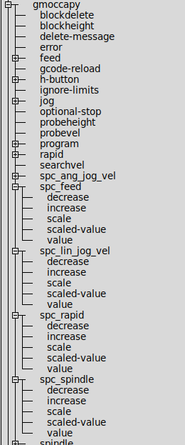

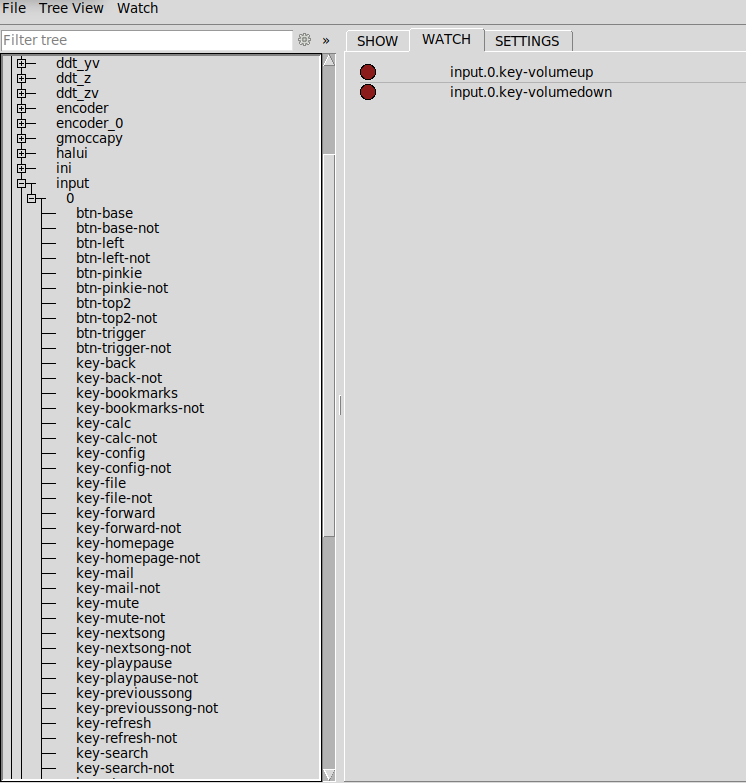

You could try using the 'hal_input' component and see what keys your keyboard offers. These can then be connected in hal to the .increse/.decrease pins of gmoccapy.
linuxcnc.org/docs/html/gui/gmoccapy.html#_hal_pins
example:
1. open a terminal and type:
2. find your keyboard in the output
example: 'Bus 003 Device 002: ID 17ef:608c Lenovo Lenovo Calliope USB Keyboard'
3. Add this to the [HAL] section of your ini file using one of the words from the keyboard identification from above to identify the device (for our example we use 'Keyboard')
4. Start your config, enter the settings page and click on the 'Halshow' button in the lower right corner
5. Navigate to pins/input/0/ and check if any function keys have been recognized:
6. In our example there are some function keys we can use (eg 'input.0.key-volumeup', 'input.0.key-volumedown')
7. Connect these pins to the relevant gmoccapy halpins in the POSTGUI_HALFILE (eg to control the linear jog velocity):
possible pins can also be found in pins/gmoccpy.
linuxcnc.org/docs/html/man/man1/hal_input.1.html

HALCMD = loadusr -W hal_input -K +Keyboard:04. Start your config, enter the settings page and click on the 'Halshow' button in the lower right corner
net jog_speed_plus <= input.0.key-volumeup => gmoccapy.spc_lin_jog_vel.increase
net jog_speed_minus <= input.0.key-volumedown => gmoccapy.spc_lin_jog_vel.decreasepossible pins can also be found in pins/gmoccpy.

But before that, when I run lsusb in terminal, it shows me "command not found". I have to run that through less /proc/bus/input/devices .. to see the unique name for my keyboard. After I add the loadusr command to my ini file in the HAL section, the keyboard button still doesn't show up in my HALshow (I am currently trying all of this on axisgui). It only shows up my gamepad. I tried to input the command directly into the HAL file, but it still doesnt show up. Am I doing anything wrong? As I feel 'lsusb' should have shown something in the terminal

2. If you see pins for your gamepad instead of your keyboard under pins/input/ then that would indicate that the key word you entered in the 'loadusr ...' command is not unique to your keyboard device.
You would have to post the output of 'less /proc/bus/input/devices' or 'lsusb' for better analysis.
