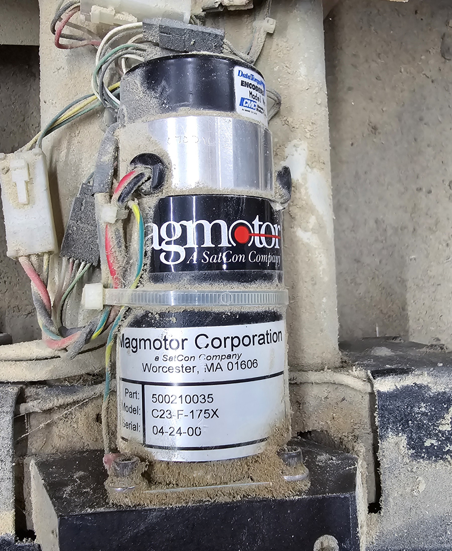

What I do know is it currently has 3 Servo's and amplifiers. They are Magmotor servos with encoders on them. They are driven through Copley Controls model 303, and 306 amplifiers, which is the start of my predicament.

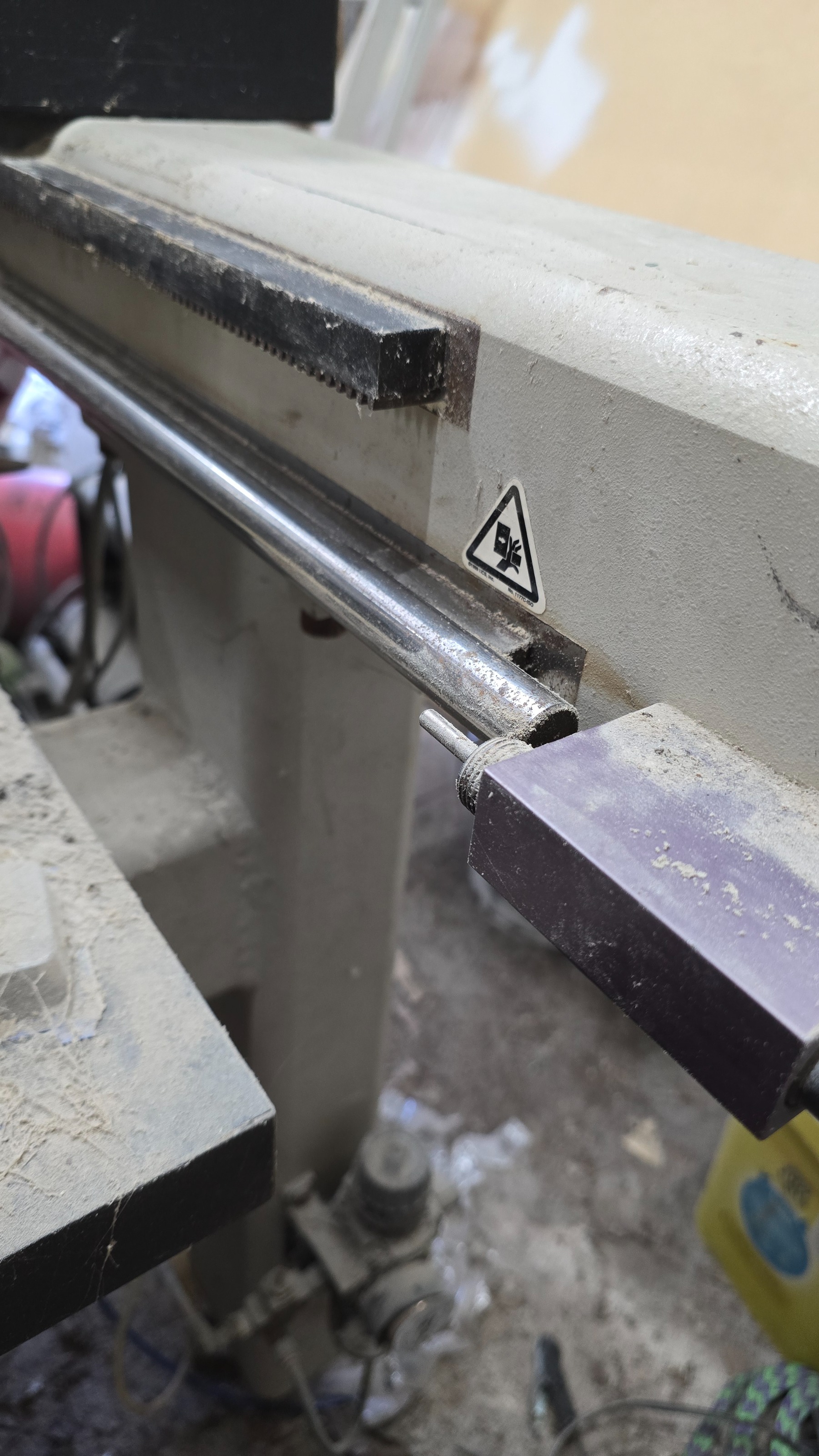

As far as the servos, I'll attach a photo, forgive all the dust and junk, it's been sitting dormant in a dusty shop.
And they are rack and pinion drive. There Are two servos on either side for the Y, and one for the x. Size wise I don't recall, but the pattern from what I could remeber matched a nema 23 or 34... I don't remeber for sure. It looked like a stepper would bolt right in if the servo was removed.

It wouldn't let me upload the photo of the rack and pinion and the servo, so here is the servo. They are all 3 alike if I remeber correctly. They x axis one is covered in junk right now, I can't get to it.
