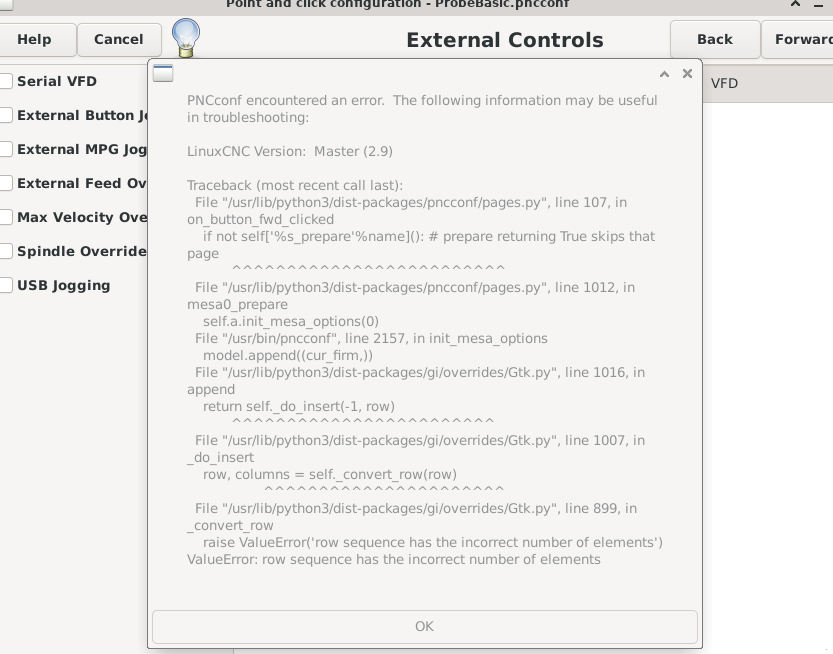

I have encountered this error after restarting a configuration in PNCconfig. I have attached a screen shot.
Please advise on how to proceed.
Regards

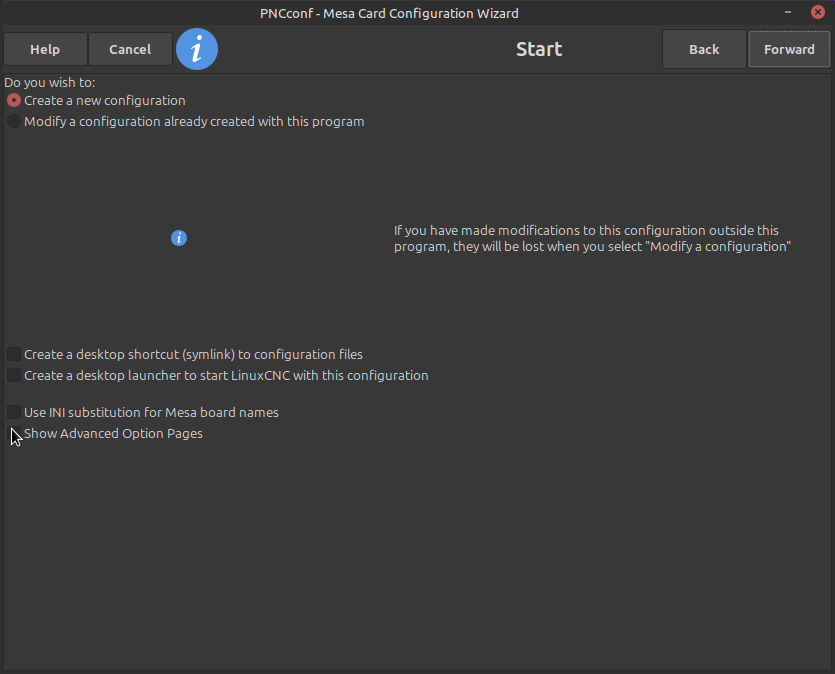

Seems like there was an empty field/value where it was to have a value, so try to skip this part without changing anything, and if that works, go back and change one by one values you need and moving forward to test.

PNCconfig will not continue past the External Controls after error.

After pressing start in PncConf, uncheck the "show advanced option pages" and continue on.

It is still giving me the error. I have tried to run an update but having a hard time finding a link to the repositories to work.

Can you post the .pnconf file that causes the error?

it is working as it should now. Not sure why. If it errors again I will post the file.
