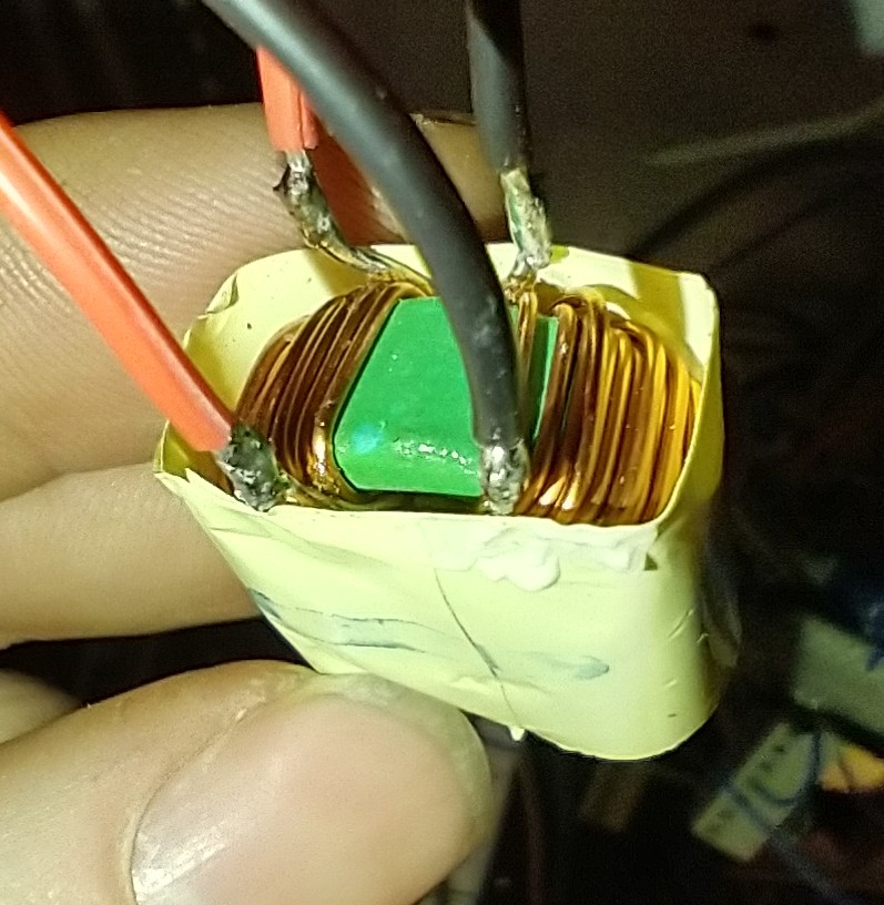

19 Nov 2024 16:34 #314878
by Sziggy_NC
Replied by Sziggy_NC on topic 7i97t Spindle has 0v or 10v
Sadly the choke didn't seem to change the behavior of the spindle. Maybe I am using the wrong style? It is salvage from some e-waste a few years back. I picked it of the few I have since the wire diameter was similar to the 20awg I was using to wire up the mesa card. I'll attach a photo.

- Posts: 18122
- Thank you received: 5337
19 Nov 2024 17:07 #314881
Replied by PCW on topic 7i97t Spindle has 0v or 10v
You could verify that the 7I97 analog output voltage makes sense
(it should be 10V*pwm_value/pwm_scale)
Maybe the drive needs some calibration
Also you might try adding a bit of series resistance in the analog output
for stability (say 47 ohms) in case the spindle drive input has a large capacitance
