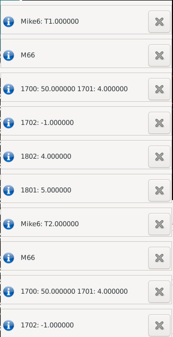

- pe8art
- Posts: 7
28 Nov 2024 13:07 #315486
by pe8art
Replied by pe8art on topic Gmoccapy Toollength sensor routine stops sometimes
I included the debug in the file ( and added some more to see where its stops. )
It seems to stop between :
M6 T#<_selected_tool>
And
G53 X#1801 Y#1802 (Taster Position)
https://www.dropbox.com/scl/fi/e0e86m3nybph5brtqs0gq/debug.png?rlkey=nxuc87agn0ob35qfrmbiw368k&st=20z6b974&dl=0
Tools look like this:
T1 P1 X0.0 Y0.0 Z0.0 A0.0 B0.0 C0.0 U0.0 V0.0 W0.0 D1.0 I0.0 J0.0 Q0 ;1 MM
T2 P2 X0.0 Y0.0 Z0.0 A0.0 B0.0 C0.0 U0.0 V0.0 W0.0 D20.0 I0.0 J0.0 Q0 ;2mm
And

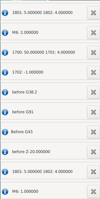

- pe8art
- Posts: 7
29 Nov 2024 10:23 #315558
by pe8art
I have included your code and added some extra debug comments.Consistently it stop changing from tool 1 to 2.
The code I added is:
(DEBUG, M6: #<_selected_tool> )
M66 E0 L0 (Stop read-ahead and wait for code execution to catch up)
(DEBUG, 1801: #1801 1802: #1802 )
(DEBUG, before Z#1800)
G53 Z#1800 (Sichere Z Position)
(DEBUG,Before G43)
G43.1 Z0 (TLO reset)
(DEBUG, before G91)
G91
(DEBUG, before G38.2)
G38.2 Z-60 F500 (messen grob)Attachments:
