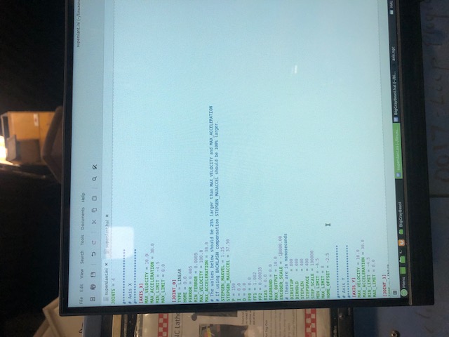

Hi Guys.
I'm trying to figure out my motor tuning for steps per inch. I'm guessing I need to use electronic gear ratio in my servo drive to be able to handle the amount of pulses per inch. Right now if I set an encoder count of (and i'm just playing right now to speed it up) 2500, and a step count of 500000 and I tell it to move .100 it only moves approx. .002 with different variations I can only get approx .011 per .100 request.
So what would be the best electronic ratio
As near as I can figure at this time my ball screws are 5 turns per inch or .200 per rev. (Hardenge SuperSlant, Maybe someone knows for sure the pitch)
it is belt driven from the survo 2 turns of the motor to one turn of the ball screw
The information I find for the motor and encoder says it has 2500 lines per rev.
So I'm thinking 2500x 5(ballscrew)= 12,500 x 2(gearing)= 25000 and this is nothing for a computer to handle but if i work on this figure the axis doesn't move enough to read on a dial indicator.
I am obviously missing something big because of the amount of pulses I actualy have to put out to get any readable movement per .1 request.
In case you might think it helps. My survo's and drives are chinese the drives are lichuan A6 drives Below copied from manual. I only wanted one line but it would only let me copy from top of page to that line.

- Posts: 18080
- Thank you received: 5316
03 Dec 2024 23:32 - 03 Dec 2024 23:46 #315924
Replied by PCW on topic Electronic Gear Ratio on survo drive and setting pulses in ini
I would set the drives steps per turn equal to the encoder resolution
(10K counts per turn with 4x quadrature)
Then the step scaling in LinuxCNC is 100000
(10000 CPT *5 TPI *2 Belt_division)
Last edit: 03 Dec 2024 23:46 by PCW.

Ok I tried the numbers suggested and I'm only getting .002" for a .100" request. I must have something in the driver itself thats not right.
- Posts: 18080
04 Dec 2024 16:18 #315963
.002 motion from a 0.100 command is what you would expect
if you used 100000 as the step scale but the drive was set for
500000 steps/turn instead of 10000.
if the step scale is 100000, you should get 1 turn of the shaft for a .1" move
if the drive is set for 10000 steps per turn.
If not, the drives steps/turn or encoder resolution are probably not set properly

Problem solved.
Nothing to do with the drive and your setting were right on.
I was reading another thread about 'Whitch mode is best for new setups' it has alot of interesting stuff. still ready it as I'm hoping to see how they resolve tying the encoder feedback into linuxcnc.
Any ways in that thread they were talking about missed steps due to step and direction times being to small. I seen the number they were talking about ( in the thousands) and mine are just 400 and 800. Mine was a bit jerky and i figured maybe a bearing I would have to replace later, but suddenly made sense if its missing steps then it would be jerky as it missed and picked up again. I must have been loosing massive amounts of steps.. I changed my numbers to the below and now it moves smooth and the right distance.
Step Time=2000
Step Space=2000
Dir Hold=50000
Dir Setup=2000
I am so happy to me past this hurdle. Now on to the next.
