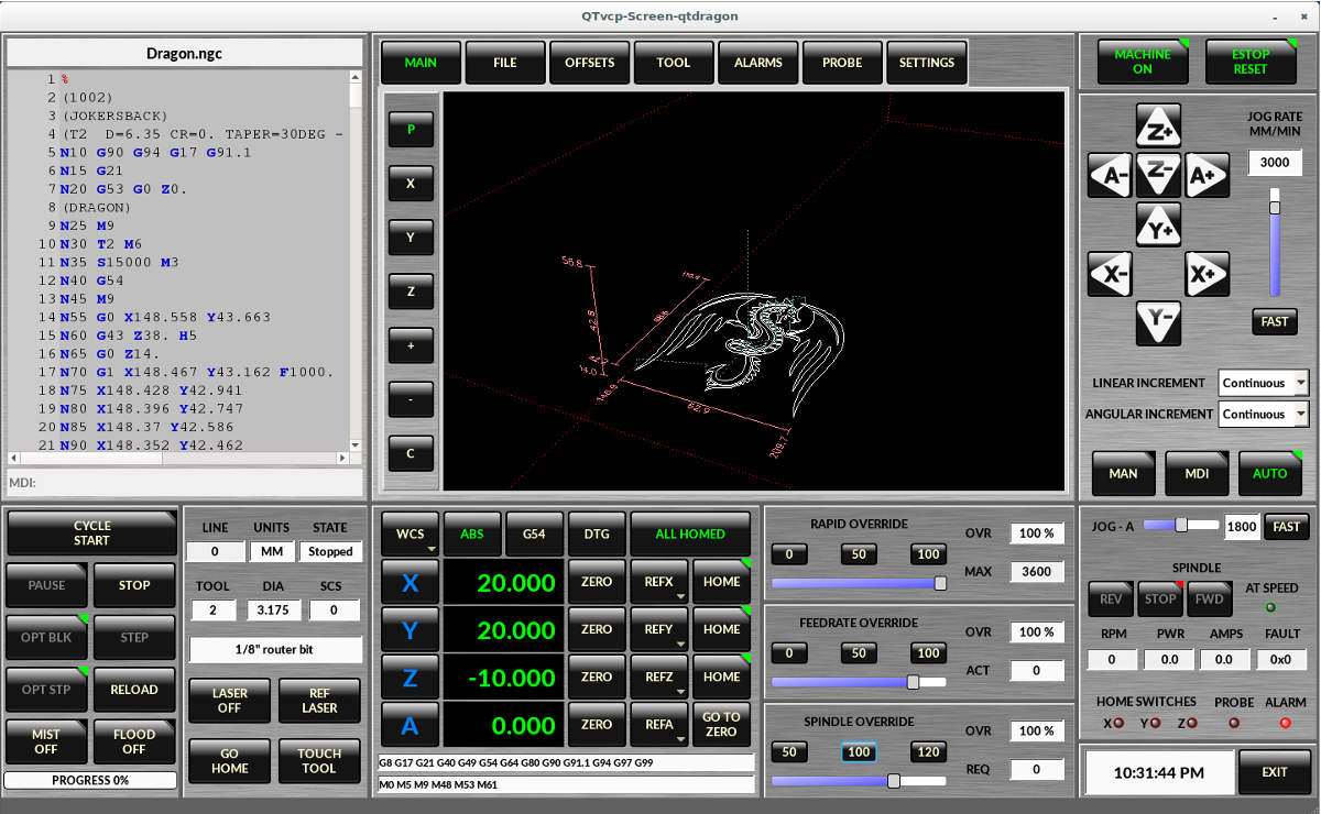

Hi, On the QtVCP website (linuxcnc.org/docs/html/gui/qtvcp.html) I saw a nice modified QtDragon screen.
See attachment.
Does anyone know if this is available somewhere to download?
Jus want to avoid to make it by myself...
See attachment.

Replied by cmorley on topic QtDragon
it's available in linuxcnc 2.9
linuxcnc.org/docs/stable/html/gui/qtdragon.html

In this QtDragon screen, the RPM showed seems to be the spindle-speed-in. Since I am not using any encoder, I want to show the spindle-speed-out instead. Any suggestion how to do this ? I am quite new with Linuxcnc and would appreciate some help. Thanks
- Posts: 7361
- Thank you received: 2173
22 Dec 2024 08:07 #317128
connect spindle.0.speed-out-rps to spindle.0.speed-in
something like this assuming neither of these pins are already connected to a signal:
net fake-spindle-feedback spindle.0.speed-out-rps spindle.0.speed-in

It os working now, thanks for the tip !
