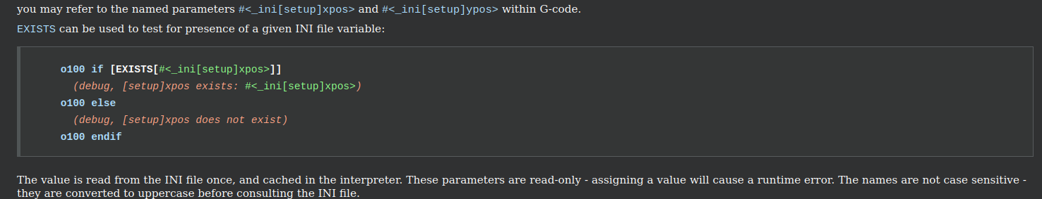

- Posts: 4819
- Thank you received: 2177
06 Jan 2025 02:06 #318202
Replied by Aciera on topic 2.9.3 INI_VARS issue
Looks like this is already documented, see section 4:
linuxcnc.org/docs/stable/html/gcode/over...gcode:ini-hal-params
The following user(s) said Thank You: shipmodeller

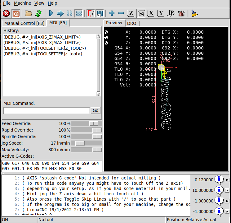

- Posts: 4819
06 Jan 2025 13:20 - 06 Jan 2025 13:28 #318251
Last edit: 06 Jan 2025 13:28 by Aciera.

- Posts: 4819
06 Jan 2025 13:32 #318253
