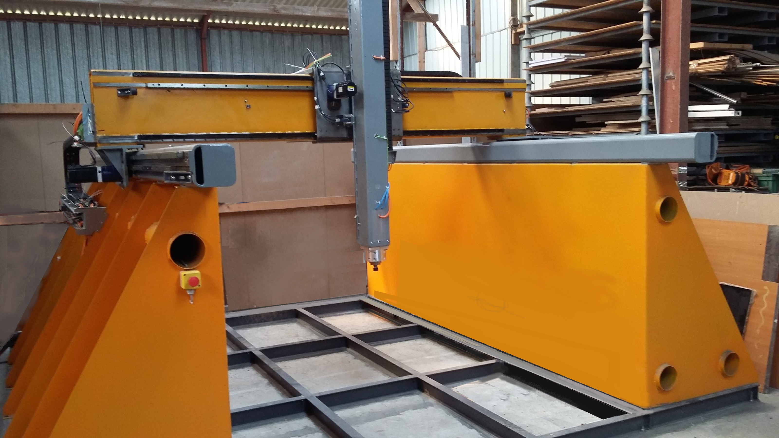

Hello,
I have built a rather large 3 axis CNC mill some years ago, using LinuxCNC/Axis on a standard PC, Step/Dir pulses via parallel port communication, a basic 5-axis BOB and 4 Delta ASD-A2-0743-M with Delta motors. The machine has been working reliably for some years, and although aware of the limitations of this setup, I was quite happy with it. Then one of the Delta drives failed by the end of December, and I'm now trying to fit in a replacement part.
The new drive is the same, brand new, exact reference. I was able to swap the unit and plug it exactly like the old one. I had a back-up of the parameters file last in use on the old drive, that I have uploaded to the new drive with ASDA Soft 5.5.0. I got a warning that the firmware on the new drive was more recent than that in the file (V4,052, Sub:2 ---->>> V4,061, Sub:340), and the soft offered to upgrade the file before uploading it. In the end, it seems that 2 parameters (P2-95, P2-97) were added, with default values.
Problem is that I can get the axis moving through the JOG screen in ASDA Soft, but not with LinuxCNC jog : the position displayed on the screen changes, but the machine's axis does not move, and the motor makes no noise at all (there is no feedback from the drives to LinuxCNC due to parport limitations).
When I have tried to Home All axis, the Z (vertical) and X (gantry, 2 drives/motors) were OK, but the Y axis, that of the new drive, keeps "moving" virtually on the screen while nothing actually happens on the drive (?) and motor.
I think, but I'm not quite sure, that the machine's axis moved on the very first attempt, albeit in the direction opposite to expected.
I dont' get any error code on the drive's panel, and no errors in LinuxCNC either.
I have probably missed something basic, but I can't figure out what. Any idea ?
Thank you for reading this far, any help is appreciated.

Replied by tommylight on topic Solved - LinuxCNC does not work with new Delta ASDA-A2 drive
First, make sure the drive is set to step/dir control mode.

Hello @tommylight, thank you for your suggestion.
I'm off the machine at the moment, and working through the Delta documentation and build notes from back then. I suspect that the backup parameters file might be wrong, I'll check tomorrow by downloading the X axis parameters first to compare.

M drives are Can bus. They can be switched to analogue or pulse though. Most likely it is defaulted to Can bus operation.

Hello,
Got the drive working again today, the parameters for Control Mode and Pulse Type were indeed wrong (so you were both right
Turns out that my backup parameters file was not good at all, I ended up just copying the working parameters from one of the X drives to the new Y drive. Both axis have the same mechanical setup, gear reduction ratio etc...
@ihavenofish : you are right, these drives have CAN bus capability. I made this choice at the time as I was not quite clear about the various options. Now, I wish I had chosen the E version that offers EtherCat...
I'm thinking about upgrading the whole setup to EtherCat, possibly running LinuxCNC from a RaspBerry. Pi. That would allow me to get rid of the PC/Parallel Port limitations, move all the hardware inside the control cabinet, and have more I/O to finally add some extras to the machine.
Thank you all for your help, great to see this community thriving !
