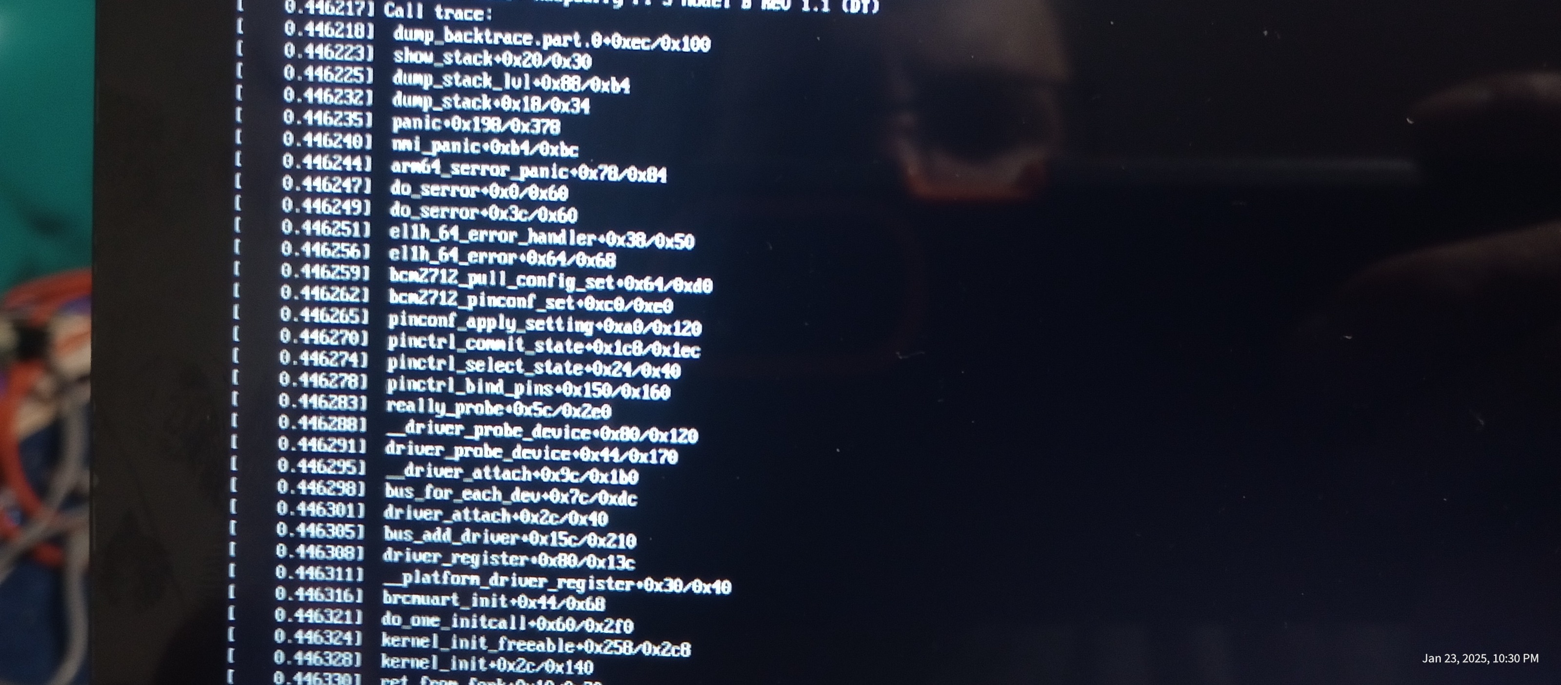

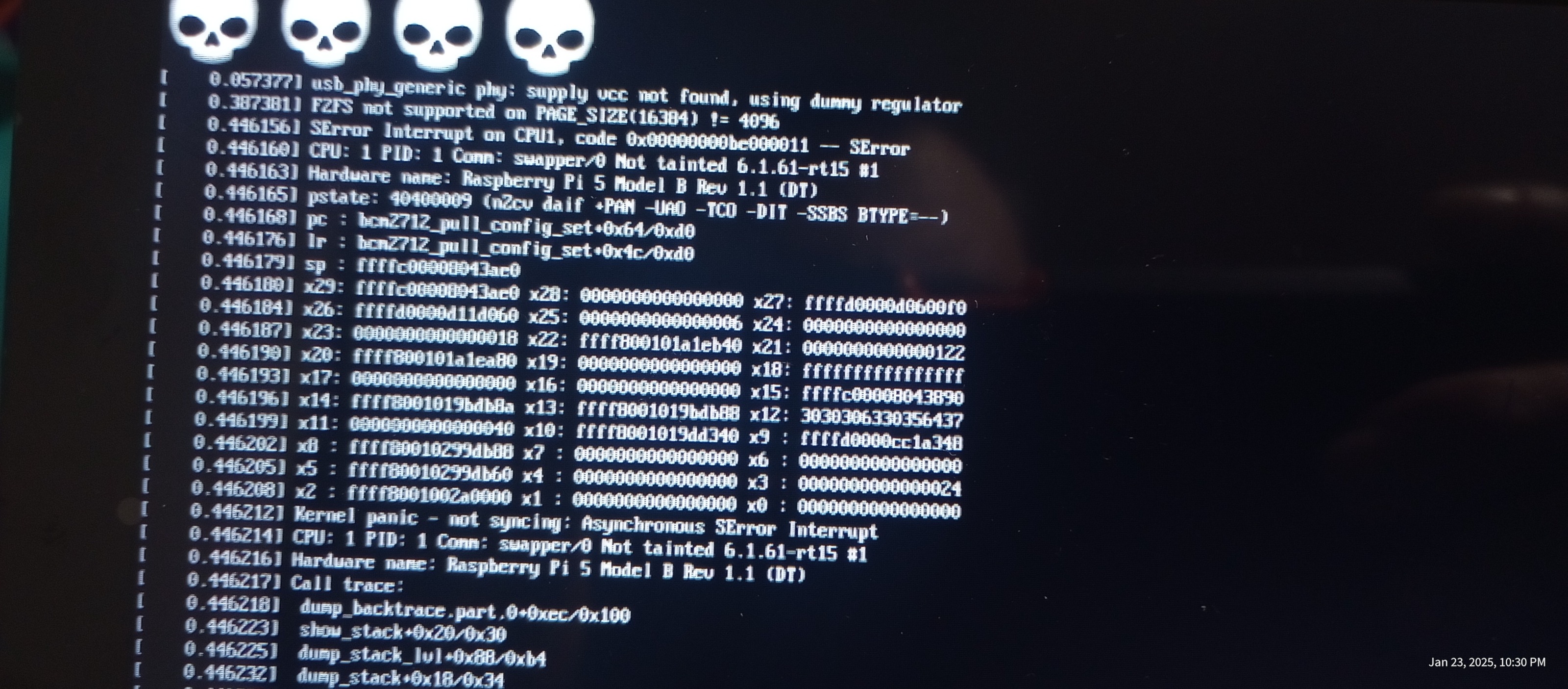

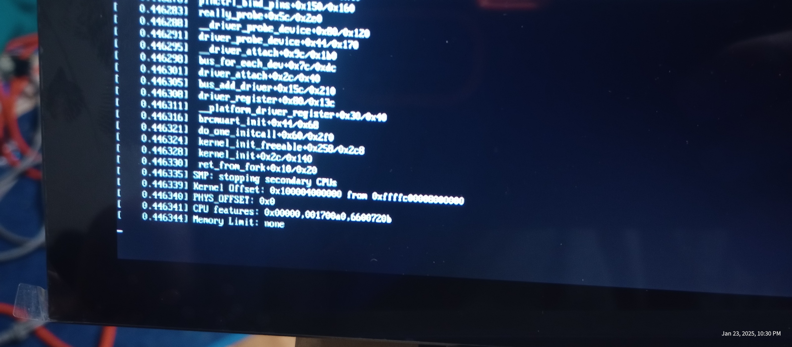

I cant get Linuxcnc to boot on pi 5. 4 skulls and page full of text. what am i ding wrong? 120GB pi 5

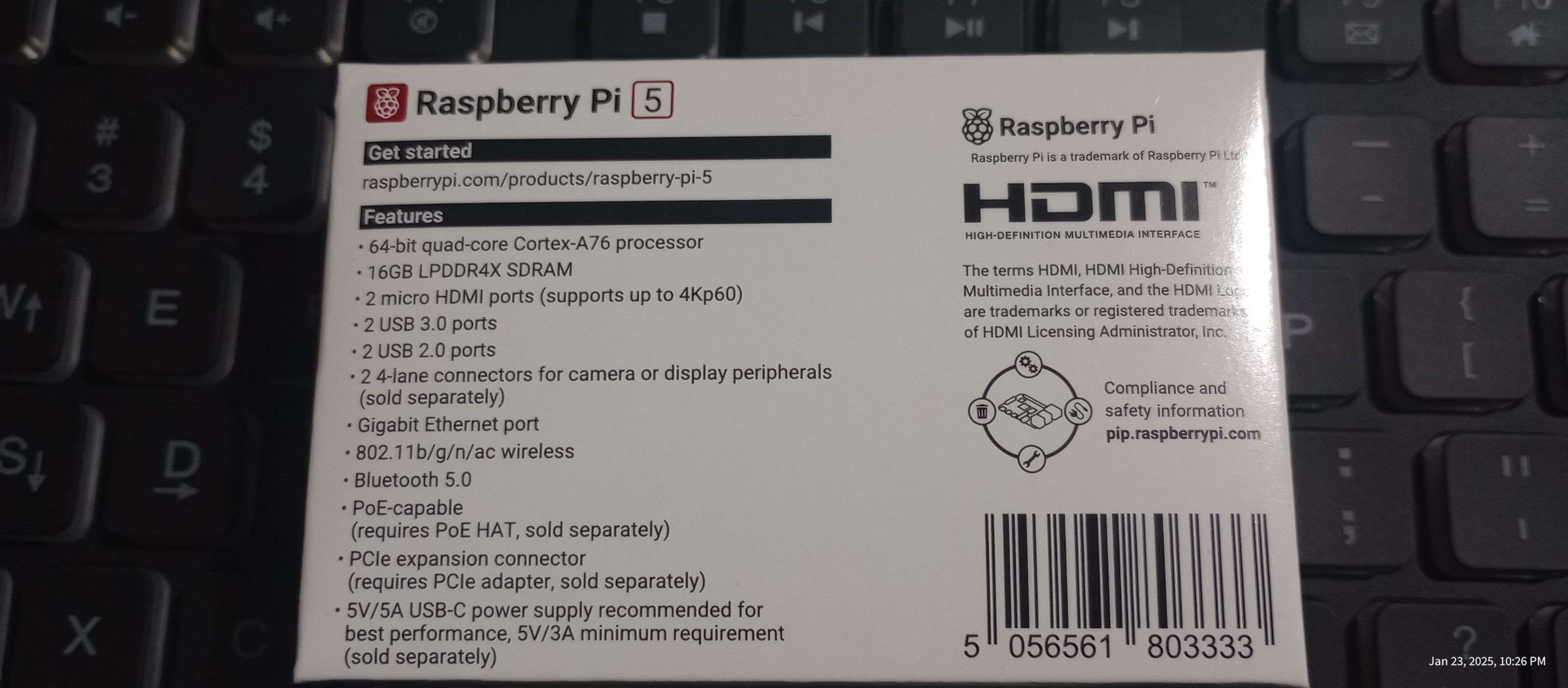

What is the spec of your RPi5 ?

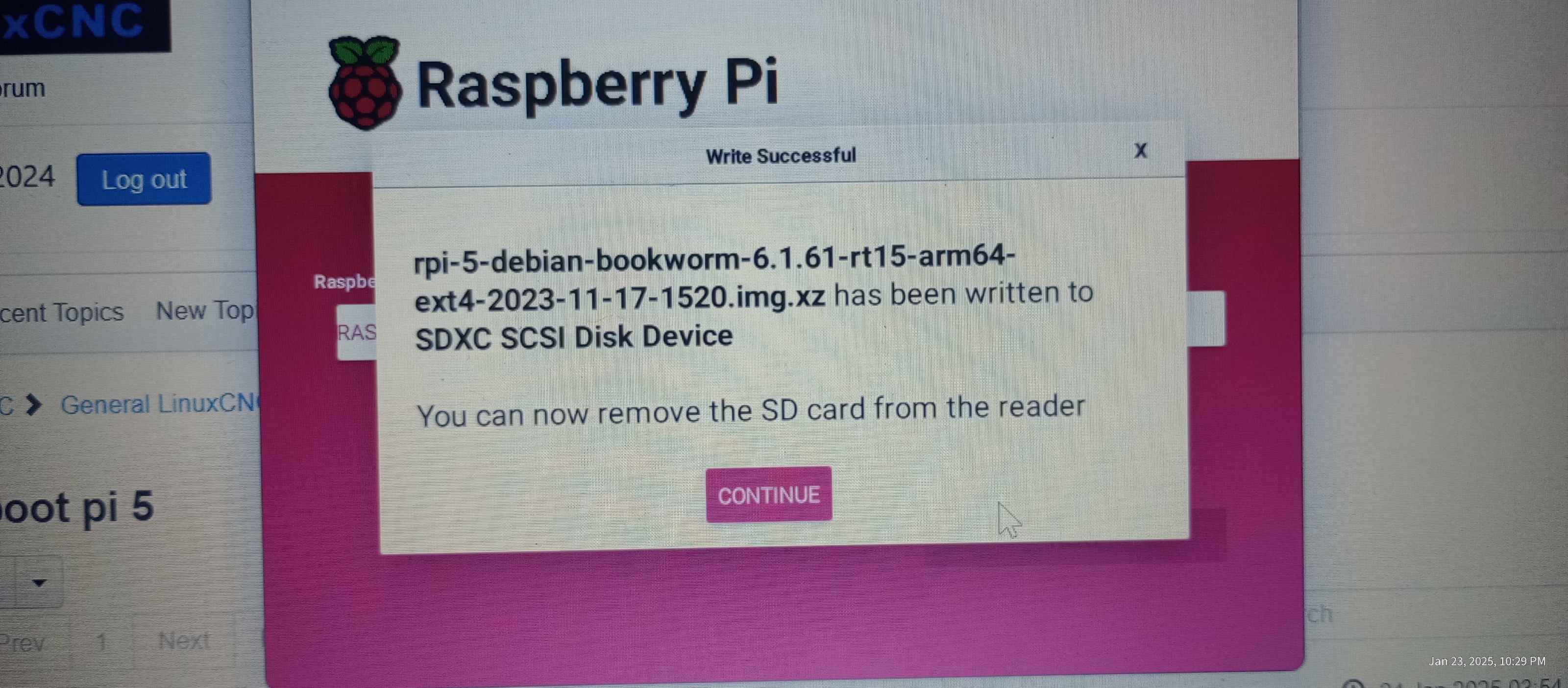

What image did you try ?
How old is your Rpi5, when did you buy it ?
Could you possibly take a picture of the screen ?

Just bought it. 16gb

Ok that's been known not to work, the 16GB is a new board and you have been only the second user to bring up an issue.
I've just upload a new image, not tested on 16GB model but 4GB. It may work on the 16GB model.
