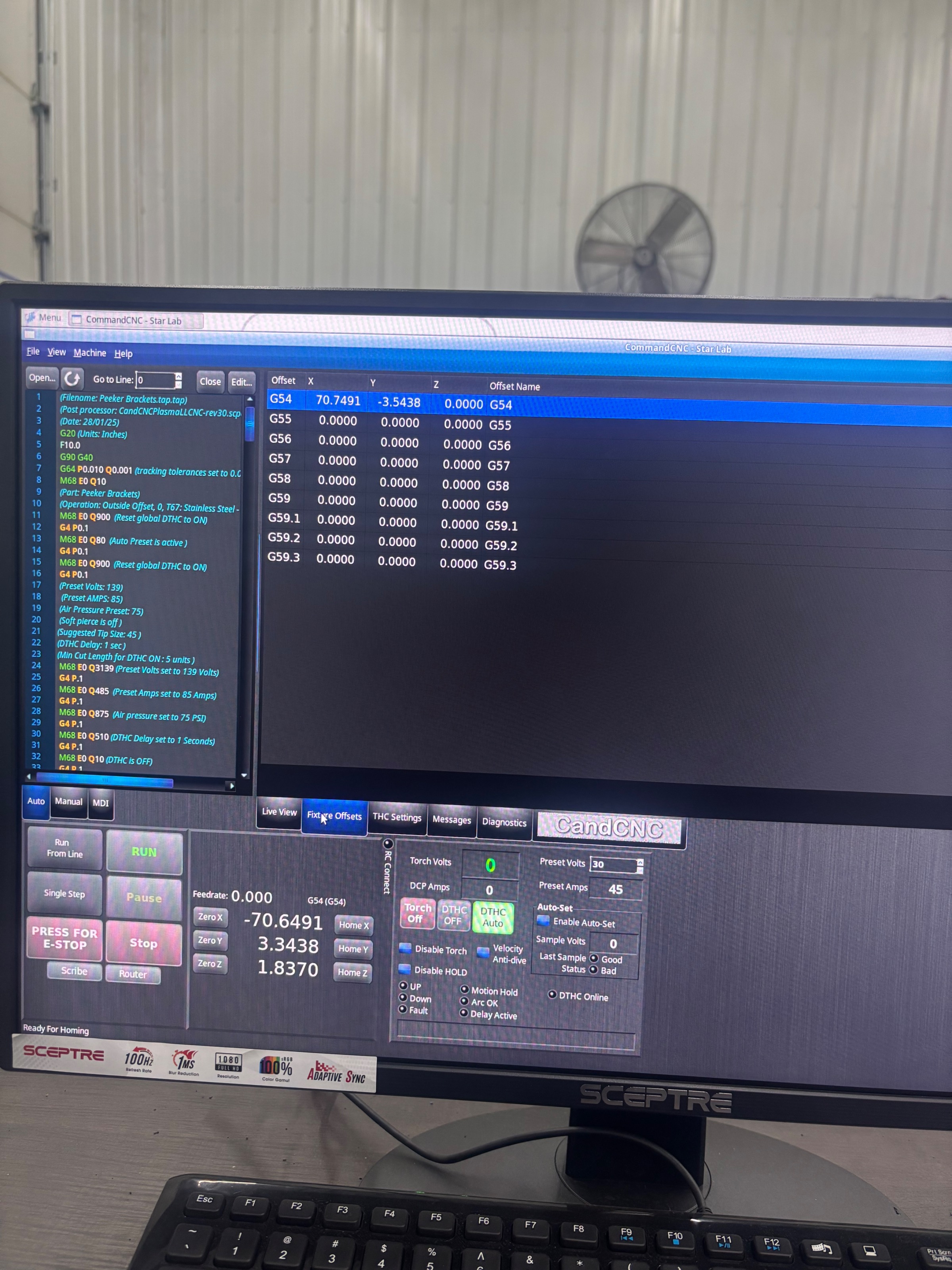

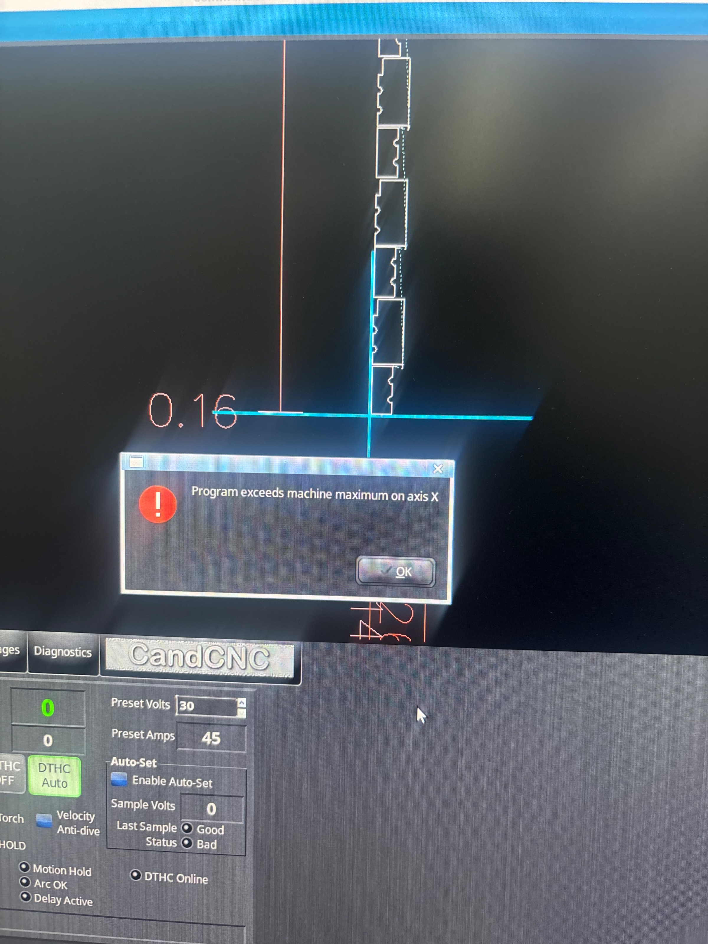

Okay, I put created a new project in sheet cam and put the run post processing and went over into CommandCNC - Star Lab and when I hit Run From Line it says Program exceeds machine maximum on axis Y and axis X. please help!!

So i went to my fixture offsets and it say G54|X-70.7491|Y-(-3.5438|Z 0.0000| Offset name G54. the rest of the offset names have 0

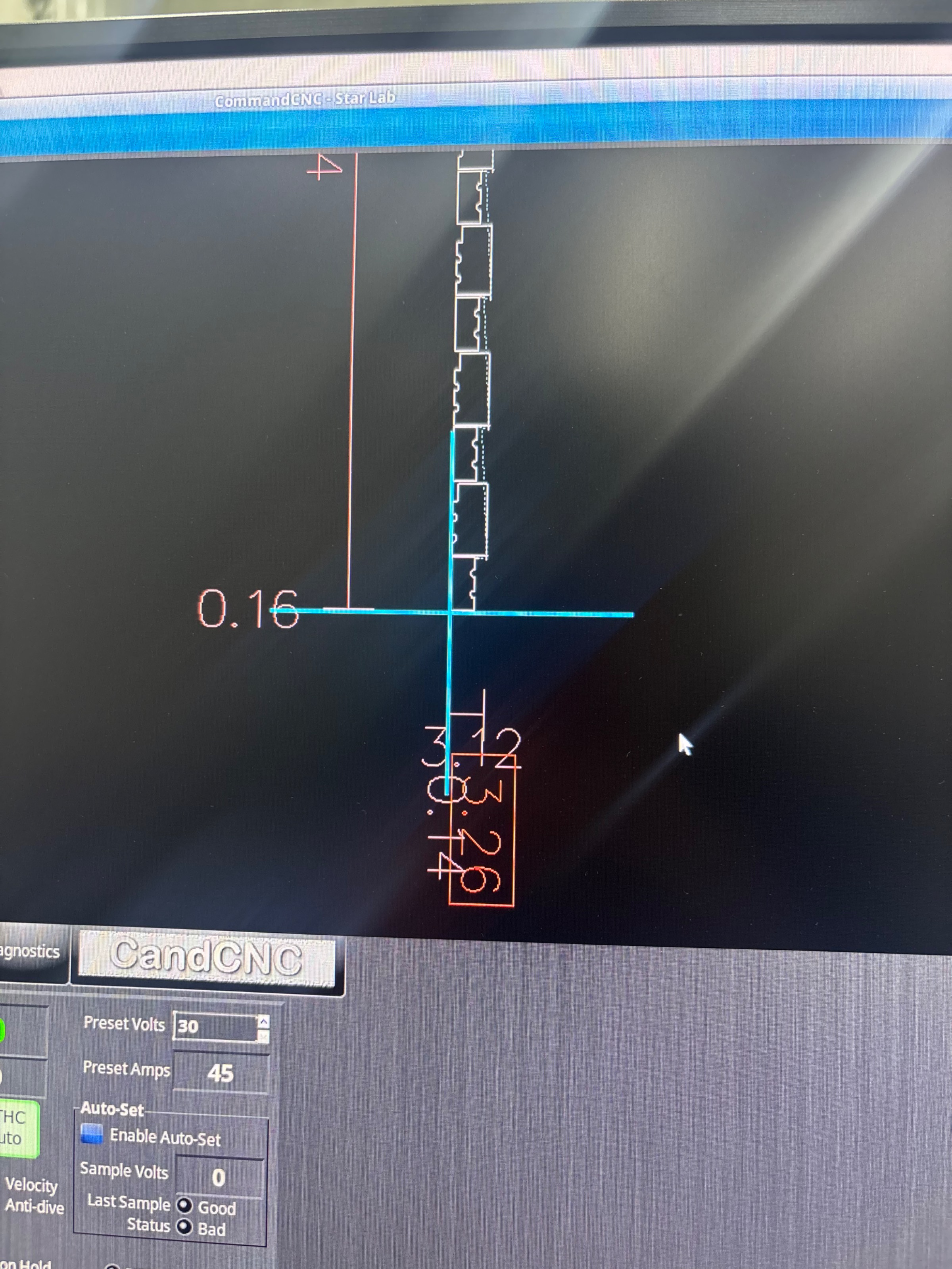

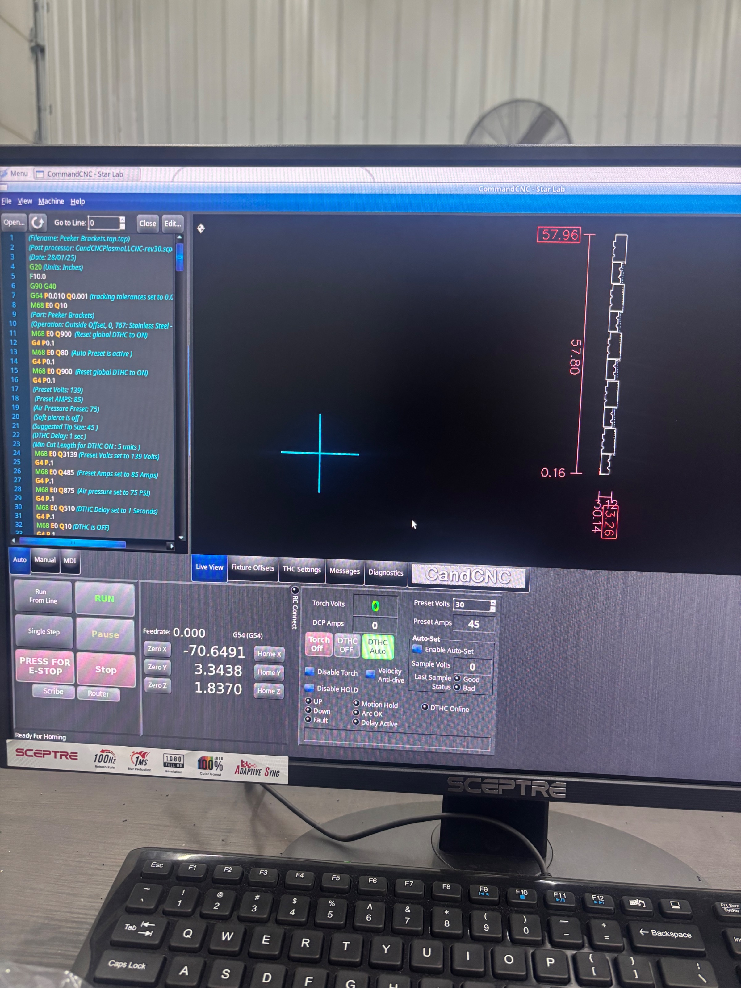

Impossible to diagnose with the information given. A screenshot of the preview might shed some light on the matter.
29 Jan 2025 16:54 #320122 by waldo
Here are the pictures

On the first picture, it shows up at the offsets as 70 on X, while lower it shows -70?
On the third and fourth picture, the starting points are OK for both X and Y, but end points are over the limits on both X and Y, meaning even if you move the offsets for X it will still not fit on Y as there are no offsets on Y.
What is the table size?
Is the Plasma (you should have mentioned it is a plasma) set in metric or imperial?
What CAM are you using?
29 Jan 2025 20:02 #320130 by waldo
In my fixture offsets it shows 70 for X and on the lower half it shows -70 for Y. I believe the table is a 8 x 12, Star Labs. How would i check if it is metric or imperial? I also use SheetCam TNG for my CAM
