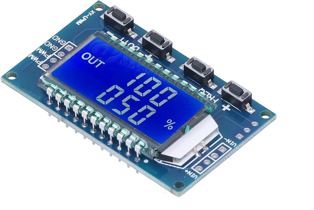

I tried one of those PWM generators which works fine. It allows to control the speed of the motor, no issue. I can adjust the motor speed by setting the duty cycle to anything between 10% and 100% and it seems to be what I need.
Now the questions: Is it correct that in my situation the spindle interface of the 7i76 is just the wrong choice for my BLDC amplifier?
How do I make a PWM control for my spindle with the 7i76 (6i25)?

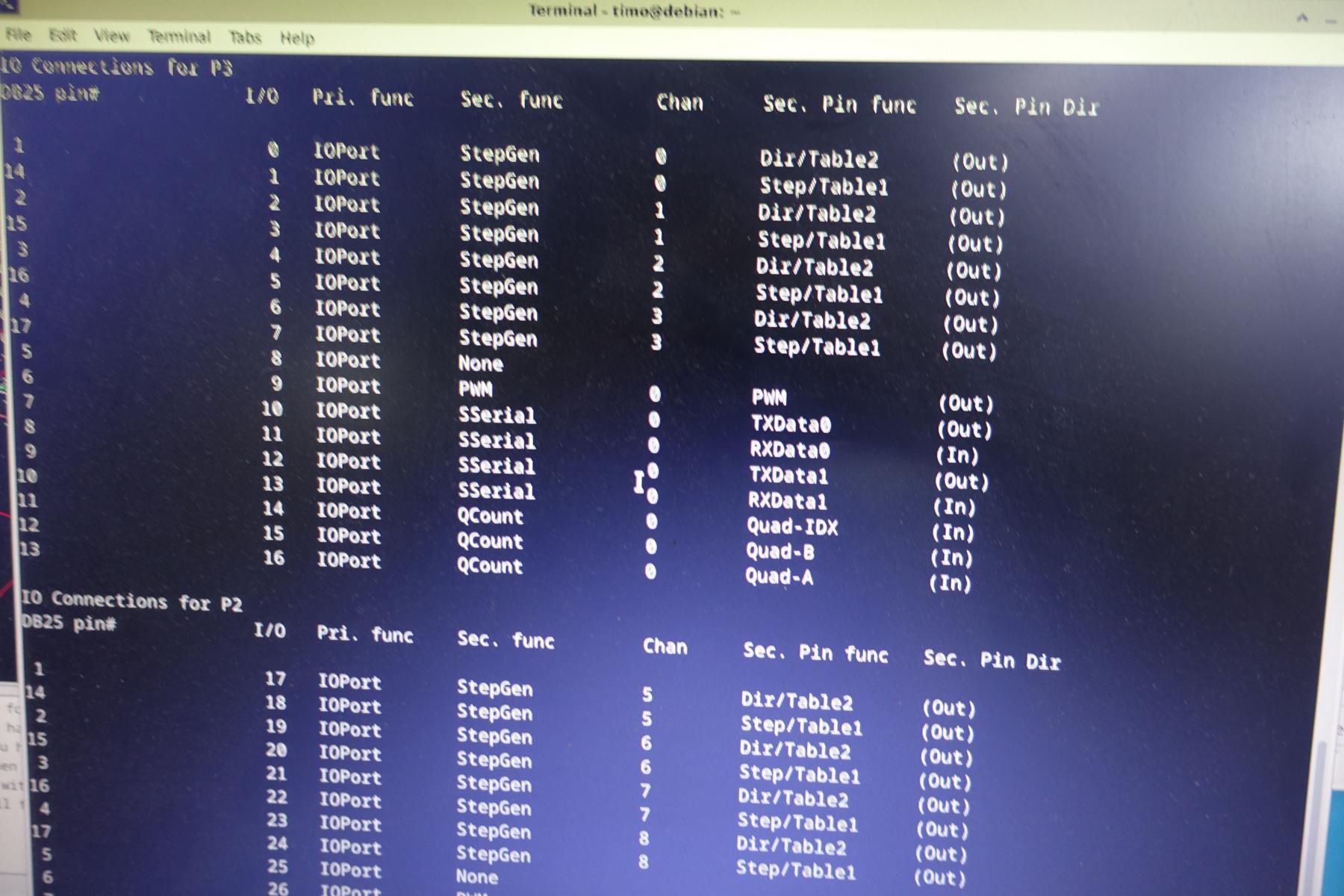

I used sudo mesaflash --device 5i25 --write 5i25_7i76x2_1pd.bit --reload
Now I cannot get the direction change working. Is the direction pin of the stepgen still working?
I am using TB3 Pin2 und Pin3 for the PWM.
I tried to find a direction pin.
I can switch the spindle on and off via Axis UI and can also change speeds. (but not the directions)

I do not really understand. If I flash another bit file (obviously it has two pwm gen) it shows four lines. (that is not a fix, because I wanted to use a stepgen on pin4 and Pin17)
IOPortTag & x"00" & PWMTag & PWMBDirPin, -- I/O 06 PIN 4
IOPortTag & x"00" & PWMTag & PWMAOutPin, -- I/O 07 PIN 17
IOPortTag & x"01" & PWMTag & PWMBDirPin, -- I/O 08 PIN 5
IOPortTag & x"01" & PWMTag & PWMAOutPin, -- I/O 09 PIN 6
The version with one PMW shows only one line. One line seems to be "empty".
IOPortTag & x"00" & NullTag & NullPin, -- I/O 08 PIN 5
IOPortTag & x"00" & PWMTag & PWMAOutPin, -- I/O 09 PIN 6
Is there something missing? I would have expected something like:
IOPortTag & x"00" & PWMTag & PWMBDirPin, -- I/O 08 PIN 5
Greetings Timo
p.s. Do I understand it right that the gpio.008 is not predefined connected for this pwmgen, but could have been used for something else as well?
I am still curious if the tags in the firmware would change anything in terms of use.
Now I put folllowing lines in the .hal (particular unsecure if the setp is what is to be done)
setp hm2_5i25.0.gpio.008.is_output 1
net spindle-ccw spindle.0.reverse => hm2_5i25.0.gpio.008.out
That switches the polarity on the TB3 pin4 and TB3 pin5, that again changes the direction of the motor.
Do not fully understand why it does not switch between 0 and 4.9V. It switches between -4.9V and 4.9V.

The outputs on TB3 pin 4 and 5 should be used individually,
that is, you would use the appropriate output and
GND (TB3 pin 1) NOT both outputs to create a 5V signal
Which output you chose depends on the direction polarity.
On later bitfiles I have changed from PWMDIR to GPIO
on some configurations because it is more flexible
(many systems do not use the DIR pin and it is unavailable
as a general purpose output in these cases)
And yes, GPIO8 can be used for any type of output.
