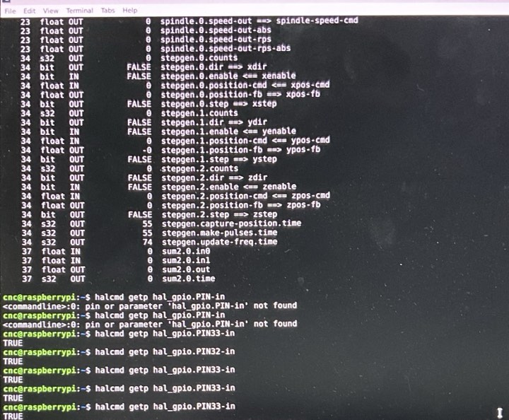

I am using byte2bot and currently trying to use homing. I pressed the limit switch, but it still doesn’t trigger the homing.
Regardless of whether I press the limit switch or not, it always returns TRUE.(Like the attached picture.)
Here are my HAL and INI files.

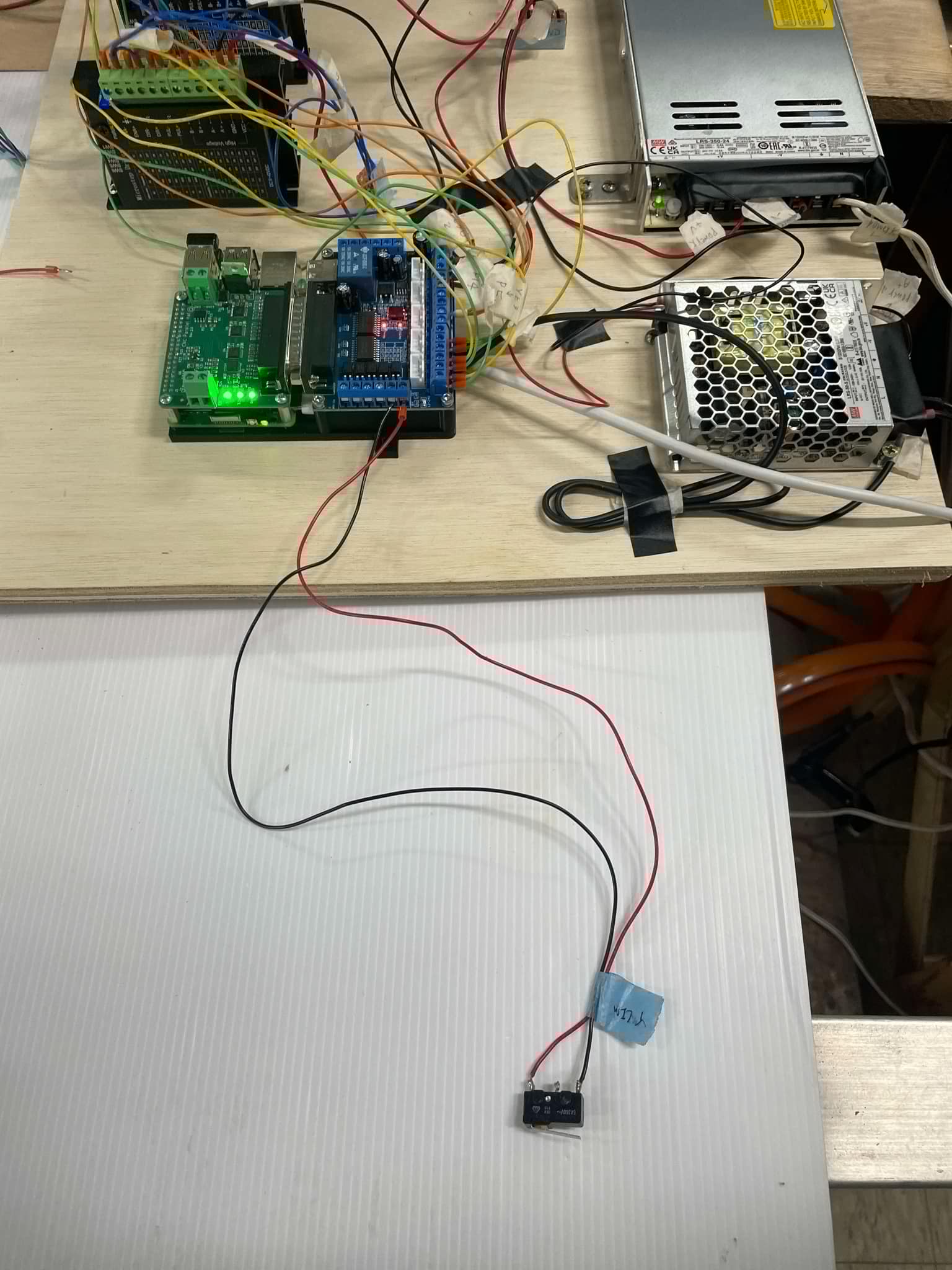

1 year 7 months ago #323338
by Clive S
Replied by Clive S on topic Byte2Bot Homing Question

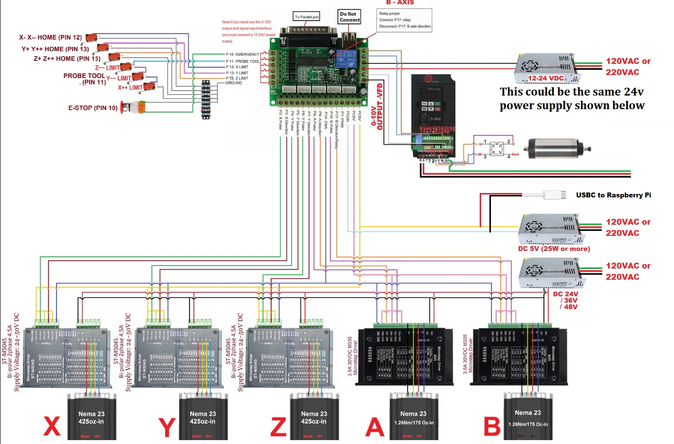

For that board to work with the inputs you will have to connect a 12-24V supply to the terminals on the relay side of the board.

In the config below you will have to change the GPIO assignments to match the Byte2Bot board.
forum.linuxcnc.org/9-installing-linuxcnc...-4-5?start=10#321296
