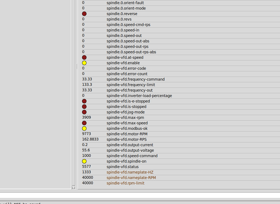

i managed to make it work, but having a weird issue, 1000 speed command is almost giving me a 10krpm,
what could be the issue here ? i am manually testing it with hall show,
i have attached my vfd hal and ini files, for testing with hall show i # all nets
