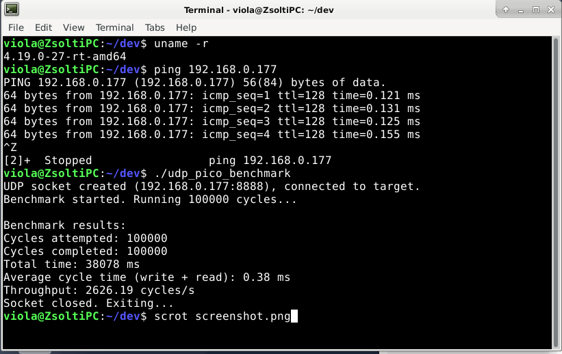

Hi everyone,
I recently ran a benchmark test on my LinuxCNC setup to measure the data request speed, and I thought I’d share the results with you all. I’d love to hear your thoughts or any suggestions for further optimization!
The setup was connected as follows: [Linux 4.19.0-27-rt-amd (core i5) PC (3 byte send 5 byte receive)] -> [switch (TL-SG1005D)] -> [W5100S-Pico]. This was a non-realtime throughput measurement, and the result I got was a stable 2500 requests/second, which I think is pretty solid. I’m curious about your experiences—has anyone else done similar benchmarks, and what do you think of this performance?
Thanks in advance for your input!

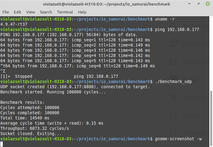

i do not post it but i compiled my benchmark to windows also with nearly same results, so the pico is the bottleneck here.

i have options to push the poll rate even further with PIO&DMA + using the W5100s interrupt pin.I won't be bored for a few days.

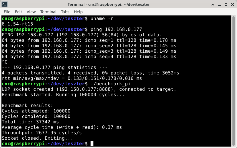

26 Mar 2025 08:10 - 26 Mar 2025 08:11 #324962
by atrex77
Replied by atrex77 on topic Developing a Raspberry Pi Pico-based I/O Board for LinuxCNC
Update: I'm making progress toward my goal. Here's a new screenshot of the burst transfer rate. I've moved away from Arduino IDE and switched to using the Pico-SDK and VS Code for coding. Added serial terminal to the code to set the IP address later without coding, the Pico now uses DMA and Burst SPI data transfer instead of byte-by-byte transfer. I don’t think I can push the transfer rate any further. Unfortunately, neither the PCB nor the components have arrived yet, so I can’t proceed with the I/O. In the meantime, I’ve started experimenting with the step generator.
