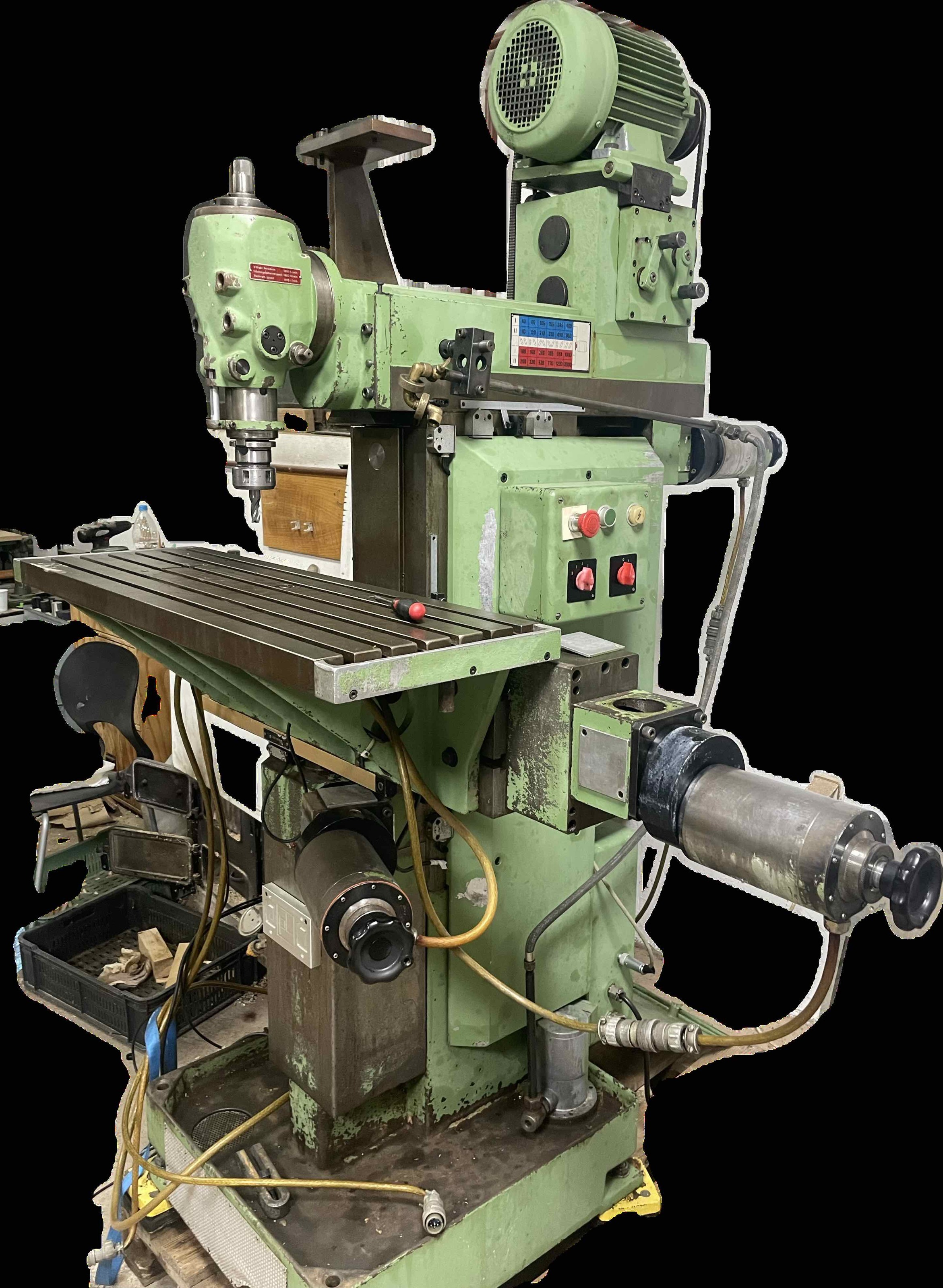

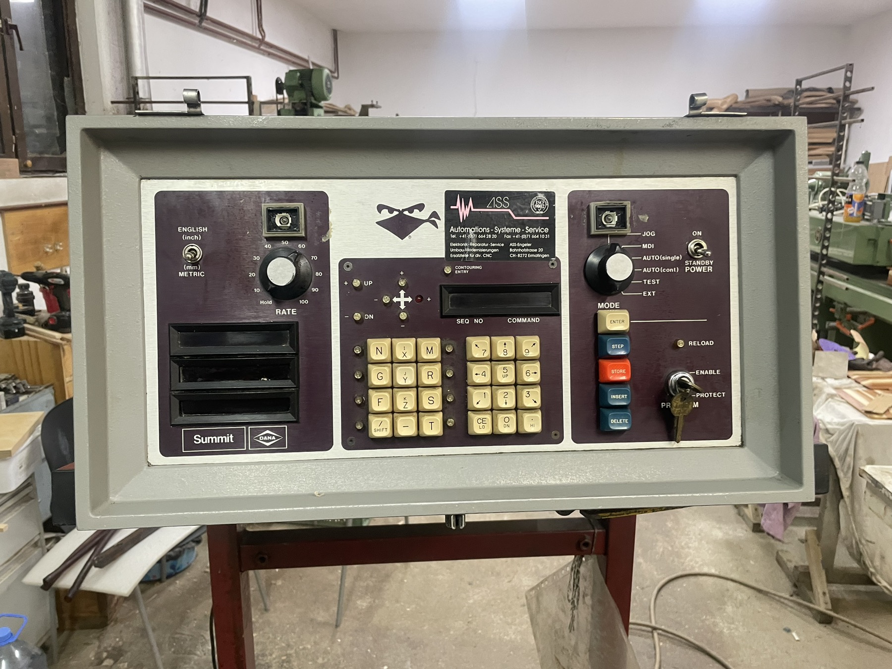

Hi
Has anyone had experience with this controller? I plan to do a retrofit, but these drivers are not very clear to me, i.e. I'm not sure if they have an analog input somewhere? Thanks

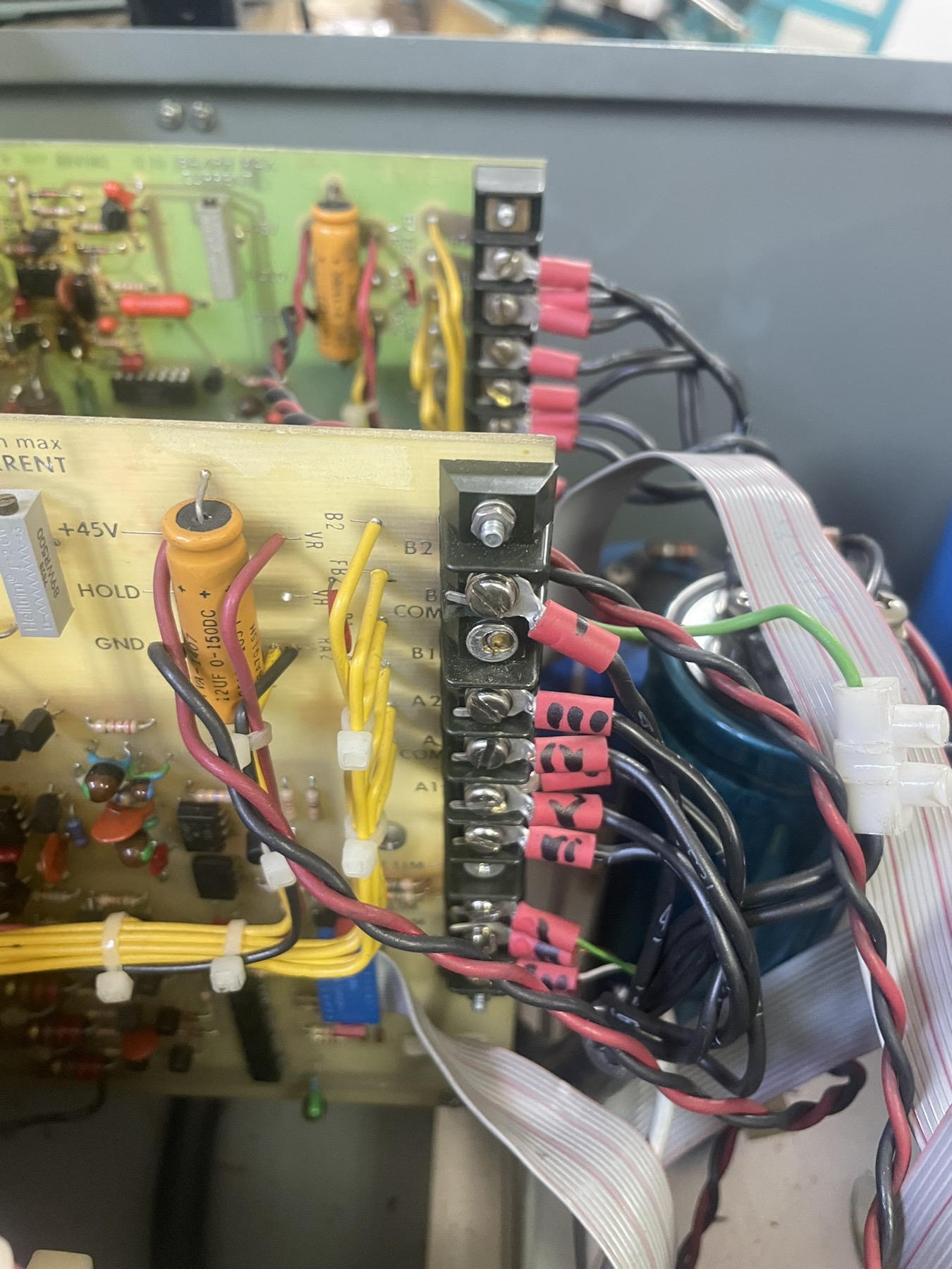

25 Mar 2025 09:39 #324878 by tommylight
Replied by tommylight on topic bandit controller retrofit
Pictures of complete boards, and do motors have any labels?
If not, open one of the connectors and take pictures of the wires inside.

25 Mar 2025 15:27 #324914 by Masiwood123
Replied by Masiwood123 on topic bandit controller retrofit
yes, the machine is from Switzerland, the controller is from the USA, there are no markings on the motors, but they are servo type from some information, it has the possibility of jog only because the controller is from somewhere in the 70s, it also has some mdi options, but I did not manage to start any command except jog.

25 Mar 2025 15:31 #324915 by Masiwood123
want to take a picture tomorrow of the entire controller and driver details, there are a total of 6 wires going to the motor, I have never seen such a motor before, it seems to me that there are no brushes, that it is some type of servo, the idea is to do a retrofit in case the drivers have an analog input via 7i77 or to insert new servo motors and 7i96s.

26 Mar 2025 09:38 #324966 by Masiwood123
I can only do ``Jog``, nothing happens in MDI select, there are letter markings but I don't have instructions for programming certain steps, the machine has no home, only limit switches and measuring scales ttl, that's why I was interested if anyone knew what type of driver it is due to the possible retention of the existing motors if I do a retrofit.

26 Mar 2025 10:18 #324971 by Masiwood123
additional driver images

26 Mar 2025 10:34 #324976 by Masiwood123
Yes that's really confusing, the cable from the motor has 8 wires, I suspected that it might be a stepper,but isn't it. Yes, that's the only way I can move the axes, in ``jog'' mode.
