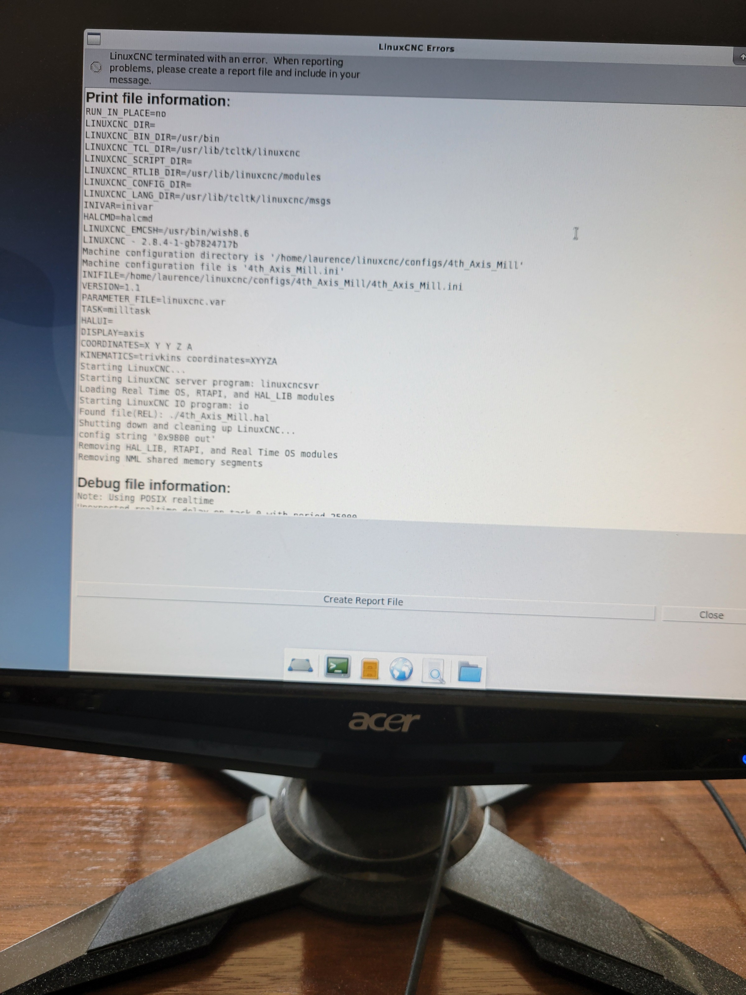

I need help setting dual Y, X, Z and A axis . A is rotation. The config wizard won't set up YY with A axis. I have a functional XYYZ program that I copied the additional Y axis ini and hal file components from and added to an XYZA file I was able to configure in config wizard. Maybe someone can see what I am missing as I get all kinds of errors. The Dual Y Axis Mill works fine.

Here is the error report. Had to take pictures. Working on pc windows. Linuxcnc is on separate pc no wifi.
Thanks in advance
Thanks in advance

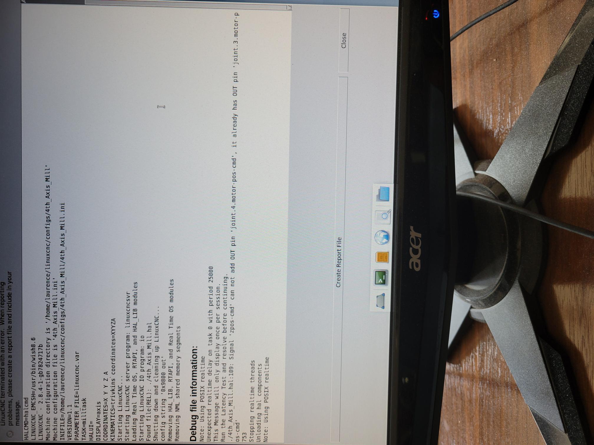

27 Mar 2025 12:54 #325081
by Routerworks
Replied by Routerworks on topic Need help setting up XYYZA for stepper motors
Here is the lower half of the report

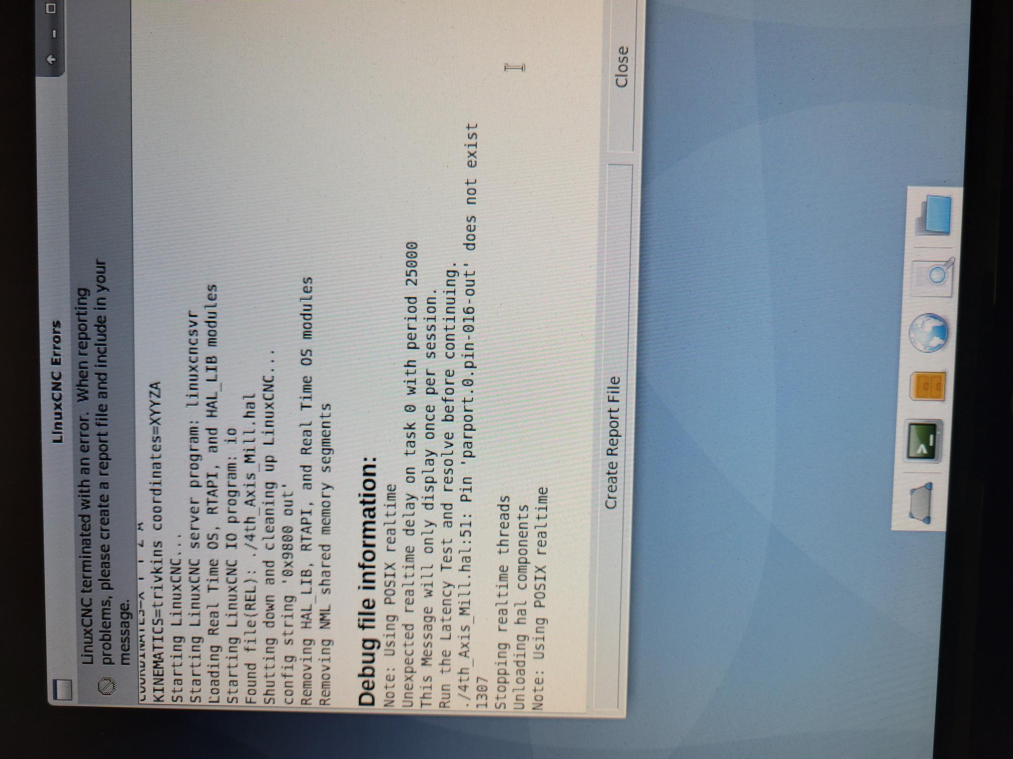

27 Mar 2025 12:59 #325082

The red text probably should be:
setp stepgen.4.maxaccel [JOINT_4]STEPGEN_MAXACCEL
net apos-cmd joint.4.motor-pos-cmd => stepgen.4.position-cmd
net apos-fb stepgen.4.position-fb => joint.4.motor-pos-fb
net astep <= stepgen.4.step
net adir <= stepgen.4.dir
net aenable joint.4.amp-enable-out => stepgen.4.enable
Note that you also need to connect the astep and adir signals to the appropriate
parallel port pins similar to this (z highlighted ):

27 Mar 2025 18:09 #325125
by Routerworks

That's an odd error as a parallel port in mode "out" should have pin 16
Can you comment out any line that causes an error, launch LinuxCNC
and then in a terminal type:
halcmd show pin parport
and show the results here
