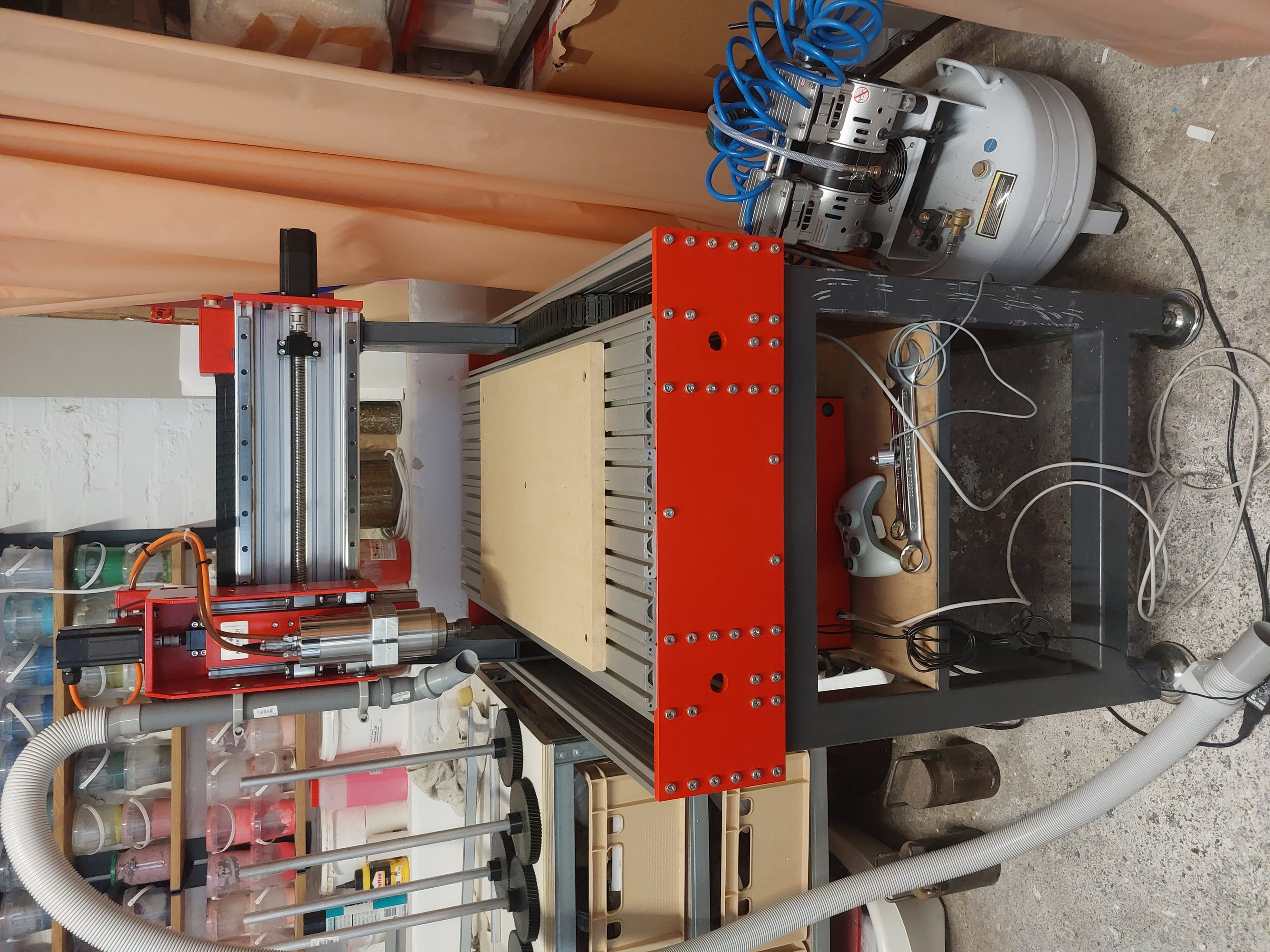

Hello everyone,I've recently converted a second hand CNC router from Mach3 with ESS to LinuxCNC with a Mesa 7i96s board. I've used PNCconf to generate my initial configuration, but I'd appreciate if someone could review my settings and let me know if everything looks okay.Machine Specs:
changes/upgrades
As I am already in the process of messing with the machine, would you recommend any meaningful upgrades or changes to it? I will mostly mill soft materials like wood but also want to try aluminium.
- X460, Y750mm, Z300
- 20mm linear rails
- 10mm pitch ballscrews, 20mm diameter
- Construction: aluminum profiles bolted to 12mm steel plates, welded gantry sides
- Motors: Y-axis 6.8Nm stepper, Z + X-axis 3Nm stepper
- Drives: DM556 V1 48v
- Spindle: 24K RPM 2.2kW ER20
- inductive endstops
- good latency values mostly sub 3000ns servo
- Step On-Time: 5000 nanoseconds
- Maximum Velocity: 3000 mm/min
- Maximum Acceleration: 400 mm/sec²
- X travel: -2.0mm to 460.0mm (STEP_SCALE = -200.0)
- Y travel: -2.0mm to 750.0mm (STEP_SCALE = 200.0)
- Z travel: -300.0mm to 0.01mm (STEP_SCALE = -400.0)
- Step timing: DIRSETUP/DIRHOLD = 10000ns, STEPLEN/STEPSPACE = 5000ns
- I see a
signal in my HAL file that doesn't seem to be connected to anything - is this a problem?Code:z-neg-limit
- Are my velocity and acceleration values reasonable for this type of machine?
- Any other issues or recommendations before I start cutting?
changes/upgrades
- should I change the microstepping ( it is 10x at the moment)
- other stepper motor or drivers?
- switch to s curve compact fork?

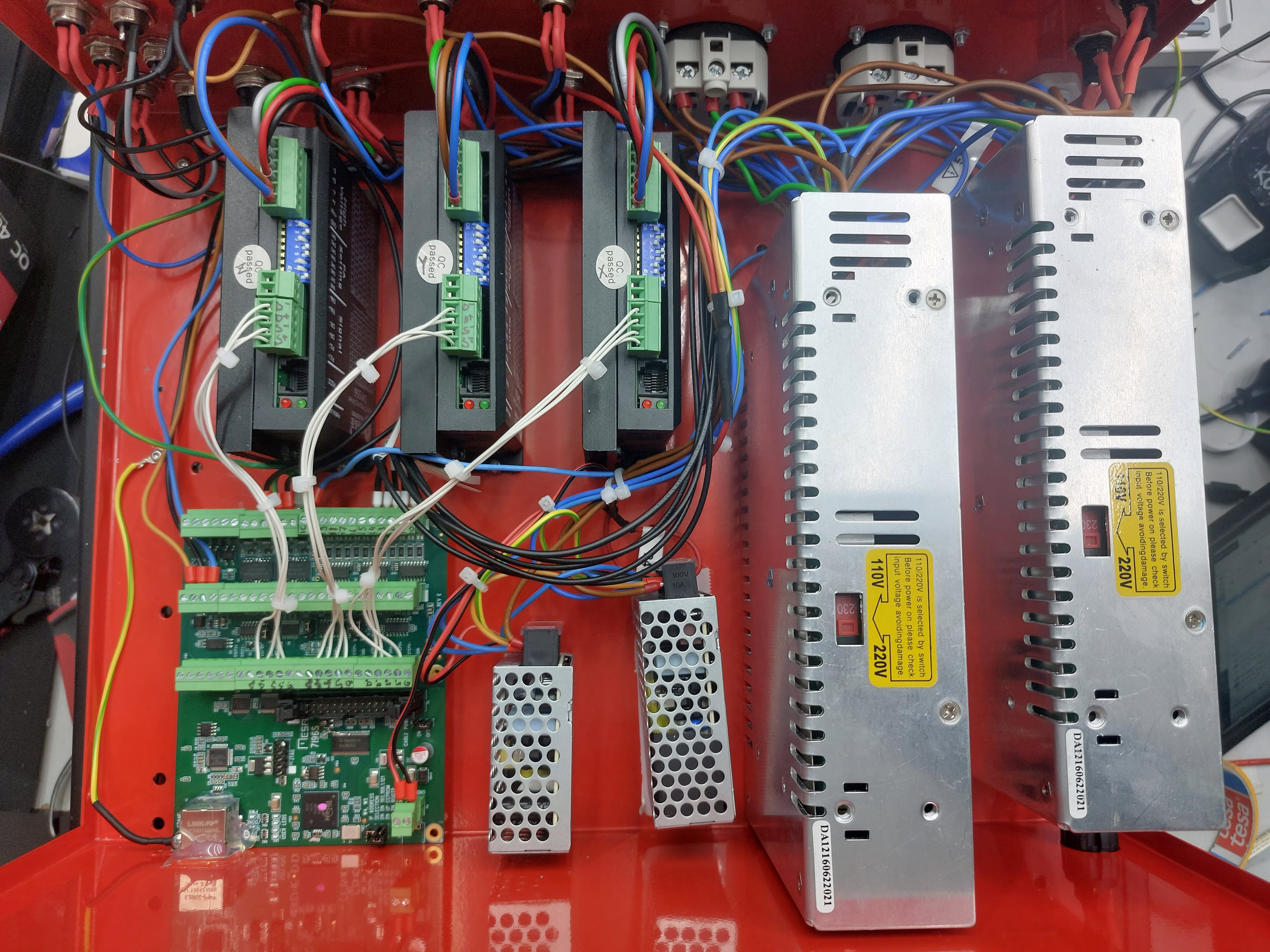

1. should be connected to z minimum limit in hal, will check later if i can
2. yes, they are OK
3. yes, remove one of the big power supplies, one of those is more than enough for 3 drives.
1. yes, use 8 or 16, not 10
2. no, those should do just fine.
3. no, it is still in development, make the machine work first, fancy stuff later.
2. yes, they are OK
The following user(s) said Thank You: konrad
1 year 7 months ago #325505
by konrad
Replied by konrad on topic config all good on mesa 7i96s?
thank you, I switched the drives to 16x and configured probe basic and a tool changing subroutine, seems to be working fine.
Probably the two power supplies are not necessary, but it was like that when I bought it. Any cons leaving it as it is?
