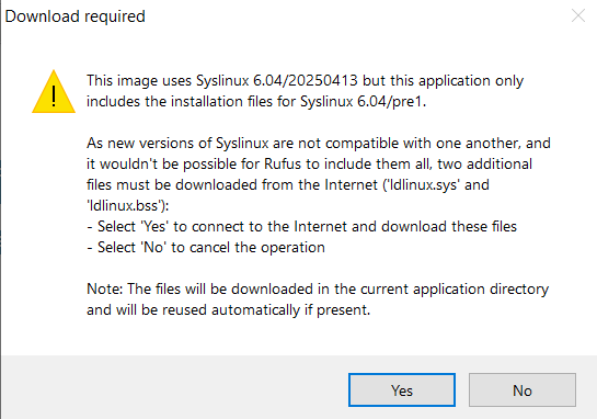

14 Mar 2026 08:30 #344235
by liutas4x4
Rufus found problem with linuxcnc_2.9.8-amd64.hybrid.iso -- missing files was created by liutas4x4

14 Mar 2026 11:42 #344245
Replied by rodw on topic Rufus found problem with linuxcnc_2.9.8-amd64.hybrid.iso -- missing files
Yes, this is one of the reasons why I ditched Rufus and now exclusively use and recommend balena etcher on all platforms

14 Mar 2026 22:42 #344280
Replied by tommylight on topic Rufus found problem with linuxcnc_2.9.8-amd64.hybrid.iso -- missing files
Ventoy is a different beast, but it does simplify everything USB, all it takes is just a simple copy of the ISO file. That is it, nothing more.
But installing it might just end up sideways, it does warn a lot to be careful, and takes about 1-2 minutes to install.
I use it a lot, daily, on many USB, SSD and NVME, a lot....saves a lot of time for testing and installing operating systems, works even for WinXP and Win10, and a lot of Linux distros.

15 Mar 2026 00:22 #344285
I might have not been clear on my previous post, Ventoy and Rufus are not the same thing nor do they serve the same purpose"
Ventoy = bootable USB drives, install once, use as you see fit just by copying and ISO files to it, multipe ISO and IMG files supported, all on the same USB and all bootable from a menu
Rufus = Balena etcher = tools to write an ISO/IMG file to a USB = single ISO/IMG

24 Mar 2026 19:09 #344683
by liutas4x4
Replied by liutas4x4 on topic Rufus found problem with linuxcnc_2.9.8-amd64.hybrid.iso -- missing files
Many thanks to the community.
I choosed Ventoy. Very useful tool.
Rufus stays for workaround with Win 11 install.
Balena sometimes is problematic with arm images for me.
Good luck for you all,
