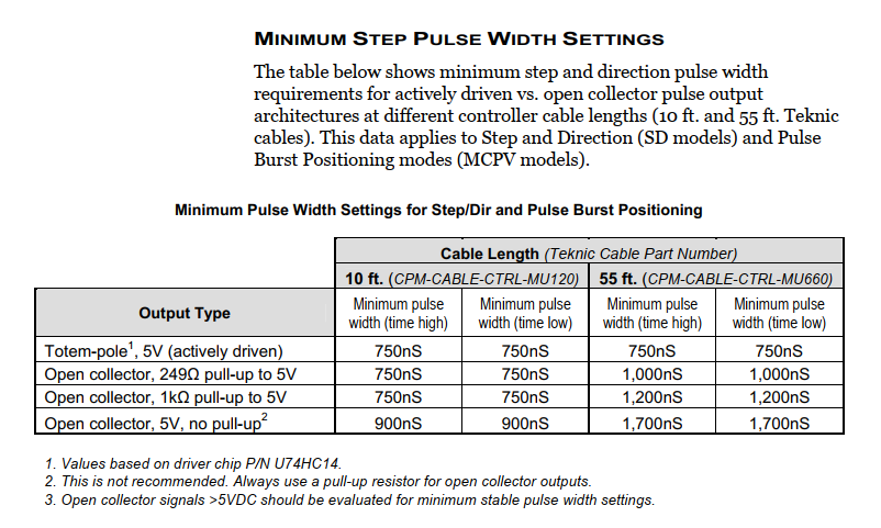

5. NOT step timing: Tested DIRSETUP/DIRHOLD at 2000, 5000, and 10000ns. 5000 was slightly better but didn't solve it.
If changing the step timing changes anything that suggests that something is marginal
electrically or timing wise
Have you tried doubling the step time?

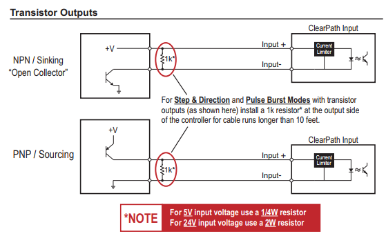

Are the drives step/dir connections single ended or differential? (single ended is suggested for opto-coupled inputs)
Does the DRO show the error? if not it's most likely not the Trajectory Planner

by spumco
Clearpath brushless servos use single-ended opto-coupled inputs. The 'drives' are built in to the motors - there's no separate drive, and they're powered by (up to) 75VDC.
Replied by spumco on topic Axis position shift during helical boring - Fusion 360 Personal + Mesa 7i96s + C
- maruf1777
- Posts: 11
17 Mar 2026 10:29 #344415
by maruf1777
Replied by maruf1777 on topic Axis position shift during helical boring - Fusion 360 Personal + Mesa 7i96s + C
Indeed I Did Wired it
TB1 Pin7 Input A-, B-
TB1 Pin5 Input A+
TB1 Pin3 Input B+
TB1 Pin5 Input A+
TB1 Pin3 Input B+

Linuxcnc doesn't generate a step signal. All planner calculations are based on position (float64 number) and velocity signals.These numbers (not steps or pulses) for each servo cycle are sent to the Mesa board, where "stepgens" converts them into pulses.
These are the connections in hal:
joint.N.pos-cmd -> hm2.N.stepgen.position-cmd;
Each cycle, Mesa sends back the counted number of generated pulses for reporting:
joint.N.pos-fb <- hm2.N.stepgen.position-fb;
The difference between the sent position and the feedback is tracked using the joint.N.f-error pin.The path planner (on the computer) and stepgen (inside the Mesa board) do not influence each other, but each performs its own role in the chain.
I hope you understand that, in this logic, the position can't simply shift in the planner. If there was an error, it would mean it was transmitting an incorrect coordinate to the mesa, and the same incorrect coordinate would be visible in your DRO (since it's also connected to the joint.N.pos-cmd == axis.N.pos-cmd signal). And the incorrect path would be drawn in the graphics window. The "live plot" draws either based on the pos-cmd or pos-fb numbers. there's a switch for this.
If "LinuxCNC believes the machine has returned to the correct point," then the planner has indeed returned to that point and is transmitting that exact position command to mesa.If the error occurred in stepgen inside mesa, then the position-fb counter would have returned an incorrect number of counts (as a float64 number, not pulses).
If your servos don't report their own following error, then there remains the possibility of an error between Mesa => Servo. Due to electrical interference/noise, not all pulses could have been received by your servo - it thinks it's following the path, but in fact, not all the pulses reached it.
This is confirmed by the fact that you saw a connection between the error and pulse timings.

I would also try:
1. Single ended step/dir wiring:
7I96S +5V --> MOTOR STEP+
7I96S STEP- --> MOTOR STEP-
7I96S +5V --> MOTOR DIR+
7I96S STEP- --> MOTOR DIR-
2. Increase the step length (double if possible)

The standard encoder for Clearpath is 800 counts/rev. With 4mm pitch screws that's about +/- 20 microns before the servo vomits.
OP...
I've had issues with clearpath step/dir that were resolved using the resistor they indicate in the user manual. Your cables may not be very long (mine were ~20 feet), but it did help with lost pulses from the PLC to the motor.
Note that I never had an issue with direction changes, only the motors not moving as far as I'd expected. I chased couplings, planetary reducer shaft clamps, and everything mechanical until I put the resistors in.
Also, Clearpath has an input filtering setting in MSP software; might want to play with that if you think some of the pulses are going astray.

How much is that in distance?
OP...
