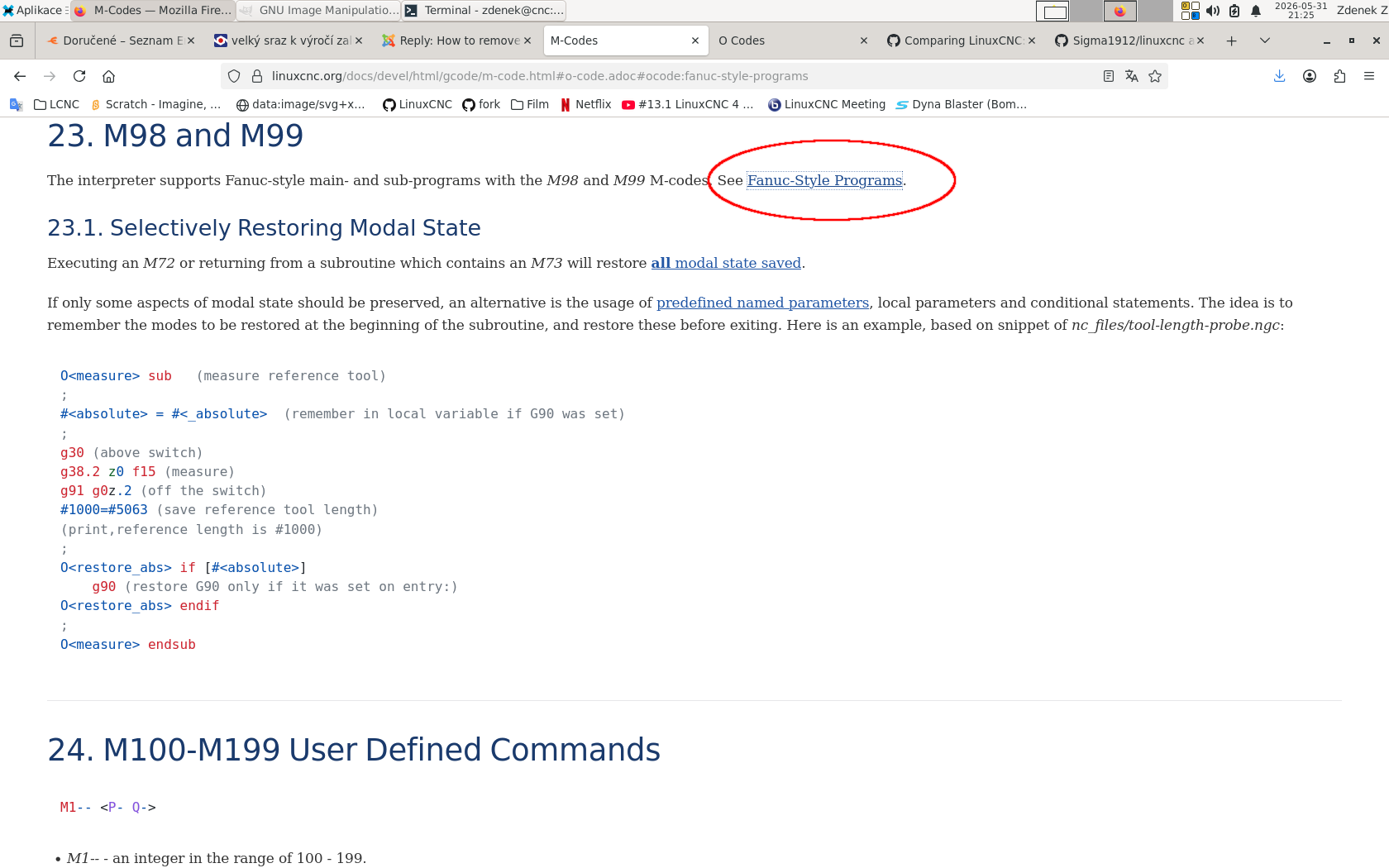

I would like ask you for add this information in manual for M2 and M30 definition.
linuxcnc.org/docs/devel/html/gcode/m-code.html#mcode:m2-m30
How M99 works? What M99 do? I didnt find definition.

31 May 2026 19:13 - 31 May 2026 19:16 #346816
Replied by Aciera on topic How to remove automatic g54 after M2/M30 ?
see updated link above, also note changed usage as I wanted to follow the 'disable_g92_persistence' setting.
for M99 see (I have never used it myself):
linuxcnc.org/docs/scratch/html/gcode/o-c...fanuc-style-programs
