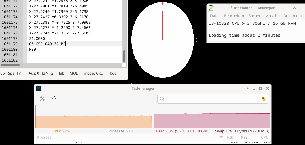

I used the 3D job i was working on today, set xy and z-steps to very low values, in the cam. The resulting file has 1601179 lines / 38.1 MB It took about 2 minutes to load. Then i doubled the file to 3202358 lines. 16 GB Ram and 1 GB swapfile was insufficient, Linuxcnc crashed. It seems, if there is enough memory, very large files can be loaded.
