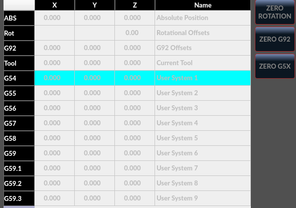

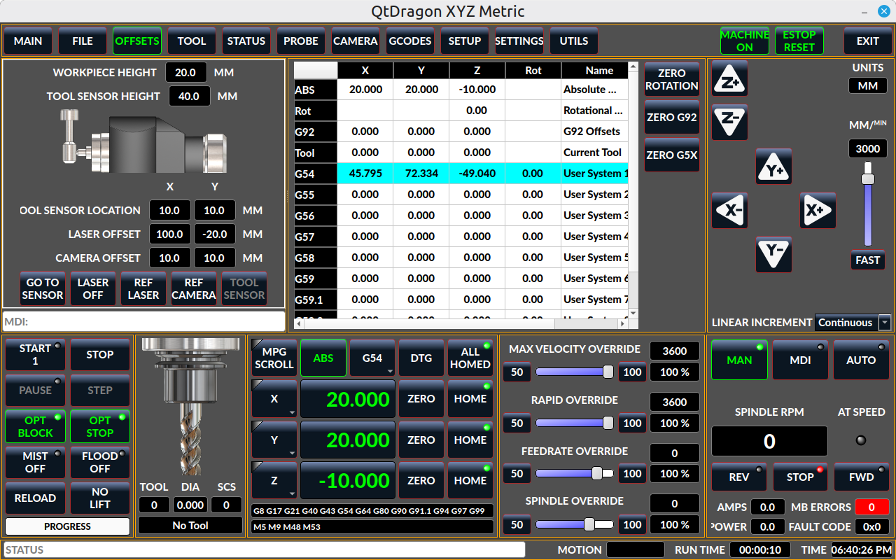

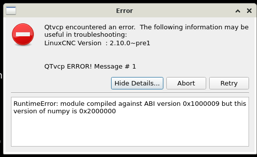

Today a question was asked on the forum: why so many gui in linuxcnc?
I always thought that it shouldn't bother anyone because at worst they don't have to use it.
But today I started wondering if this garbage can makes any sense.
Well, I have always been curious what this Qtdragon is and whether it can be useful for something.
Since I always compile linuxcnc from source, I never managed to get this GUI to work.
Recently RuntimeError: module compiled against ABI version 0x1000009 but this version of numpy is 0x2000000...
I can't downgrade numpy to version 1, because I need version 2 for other programs, and besides, apt, together with numpy, wants me to uninstall a dozen or so other packages because they have dependencies.
I downloaded qtdragon from github.com/persei802/QtDragon_hd.
The repository looks fresh, but it's not and it want the old numpy...
Today curiosity got the better of me and I launched Qtdragon with linuxcnc_2.9.10-amd64.hybrid.iso.
Here Qtdragon started up, but my worst suspicions came true.
I simply have the mind of an engineer and I hate "artists" who spoil formally good designs to make them bad but nice...
What's the point of a small gray font on a gray background?
LinuxCNC is not a game that you can run in a dark room and then a dark interface actually makes sense.
LinuxCNC is a machine control that can be dangerous and there is no room for anything "nice".
It is no accident that the e-stop button has a different shape and color than the start button, so as not to look for it and not to confuse it with another one when the machine starts to live its own life...
I know that someone will soon start explaining to me that the authors do it for free and I should be grateful to them.
No, that's not true.
If something works badly or doesn't work at all, there is no reason to be grateful, because why should it?
The rule is simple - if you do something, do it well, and then people will be grateful to you, even if they have to pay for your work...

Replied by cmorley on topic Is there any idiots guide to GUIs?
Always interested in contructive feedback good or bad - really am.
But stuff like this makes me shake my head a bit.
Compiling problems aren't usually QtDragons fault - you didn't mention what system you are compiling in so no one could help or evaluate the problem.
I'm sorry Qtdragon didn't suit you out of the box, but there is quite alot you could change.
For instance based on your pic, you could turn on the machine and home it, then the colors change from disabled to enabled and look like this:
Qtdragon has optional stylesheets to easily change colors, there are several built in.
If fonts are a problem you can change them too.
linuxcnc.org/docs/stable/html/gui/qtdragon.html#_stylesheets
If you asked nice I bet someone would have even helped you get something that works better for your eyes.
Or don't use it at all. Choice is yours.

28 Sep 2026 07:33 #349956
by tuxcnc
My system is Debian 13.7 and the LinuxCNC sources are from the Git repository, main branch, i.e. version 2.10.
There is some misunderstanding here, because when LinuxCNC is compiled, the Python scripts are not compiled, but only copied to the right place. This means that if the scripts author screws up, it's his fault, because compilation itself doesn't change anything.
So we have the following flower:
This is what happens after compiling LinuxCNC yourself.
However, there are two live images that I ran.
1. linuxcnc_2.9.10-amd64.hybrid.iso
2. linuxcnc_2.10.pre1-amd64.hybrid.iso
Qtdragon starts in both, but neither suits my system.
In linuxcnc_2.9.10-amd64.hybrid.iso there is numpy 2.2.4 but LinuxCNC is 2.9.
In linuxcnc_2.10.pre1-amd64.hybrid.iso there is LinuxCNC 2.10, but Debian 12 with numpy 1.24.2.
Someone's sources have obviously gone wrong...
As for these "gray on grey" numbers, I wrote that I ran Qtdragon for the first time in my life and just took a look. I opened the tab called "offsets", so I thought there were offsets there and it didn't occur to me that it would only work after homing, because offsets have nothing to do with homing the machine.
Well, now I noticed that someone stuffed a machine position into the offsets, for unknown reason, because they can be seen much more conveniently in the window below. I started to wonder what else the authors of Qtdragon would surprise me with, but I think I'm less and less curious about it.

First, about compilation issues.Compiling problems aren't usually QtDragons fault - you didn't mention what system you are compiling in so no one could help or evaluate the problem.
