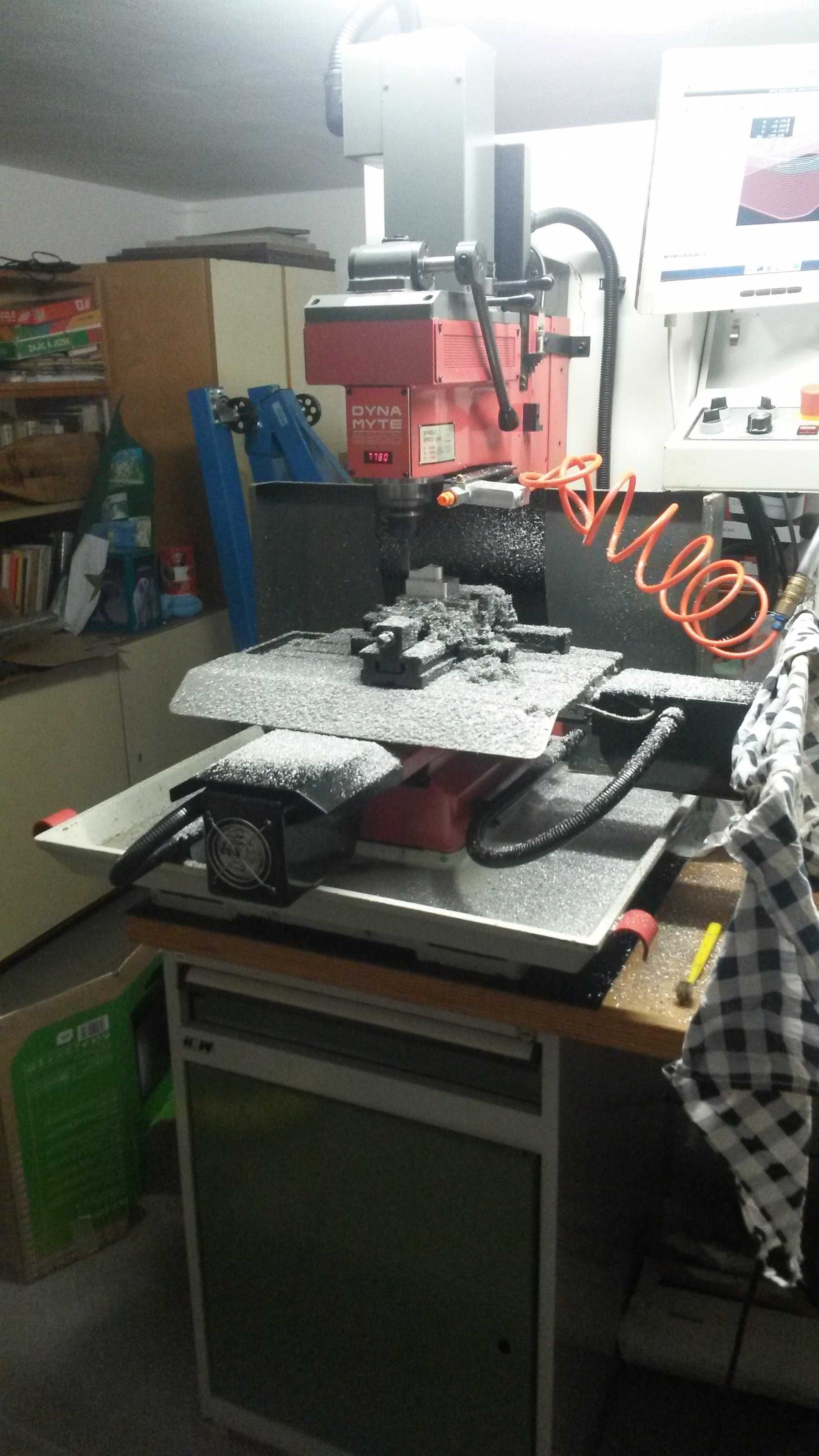

i have converted my 3axis mill DM2800 to LinuxCNC, using Mesa 5i25-7i76.
My spindle is 750W Step/dir AC servo without encoder feedback to the system.
It is setuped with pncconf.
I have no Encoder mounted on the spindle
Is possible to do regular rigid tapping G33.1 with this configuration?
My program stops before the line with G33.1. I believe it is waiting for encoder feedback which is missing.
My idea to link in HAL the Step/dir spindle signals to spindle position system input. PID
But i do not how....
Somehow create Open loop system, i know the syncronisation will be not precise, but since i will have the toolholders with length compensation, it will work...
Thanks for Help
Tom.

No, you can't do rigid tapping because the position of the spindle is unknown.
Specifically the system has no way to know when the spindle actually changes direction so that it knows when to change the Z axis direction.
Adding an encoder may not be very difficult, and the 7i76 has an encoder counter for the job.
It _might_ be plausible to use the Hall signals as a surrogate encoder, but I suspect that the resolution would be too coarse.

I believe in principle this would be possible, but I think it would require the mesa card's stepgen to synthesis an encoder/index output. Currently it does not.
maybe it could be calculated with HAL components based on the stepgen position?
Interesting question.

This might work for an actual stepper motor drive, but my impression was that the pulse stream was sending velocity commands. If it is actually sending position, then it is possible that the stepgen counts might be usable as position feedback.
I think that a simple custom HAL component could be used to synthesise index-enable and position reset.

thank you very much for fast feedback, i am really beginner regarding LinuxCNC but in the HAL manual is written
motion.spindle-speed-in - (float, in) Feedback of actual spindle speed in rotations per second. This is used by feed-per-revolution motion (G95). If your spindle encoder driver does not have a velocity output, you can generate a suitable one by sending the spindle position through a ddt component. If you do not have a spindle encoder, you can loop back motion.spindle-speed-out-rps.
I understand this like if i just add a line to my hal
net spindle-vel-fb <= motion.spindle-speed-out-rps
I do not believe it is so simple, have so far no chance to test, my machine is at my parent's house.
My actual HAL follows
net spindle-vel-cmd-rps <= motion.spindle-speed-out-rps
net spindle-vel-cmd-rps-abs <= motion.spindle-speed-out-rps-abs
net spindle-vel-cmd <= motion.spindle-speed-out
net spindle-vel-cmd-rpm-abs <= motion.spindle-speed-out-abs
net spindle-on <= motion.spindle-on
net spindle-cw <= motion.spindle-forward
net spindle-ccw <= motion.spindle-reverse
net spindle-brake <= motion.spindle-brake
net spindle-revs => motion.spindle-revs
net spindle-at-speed => motion.spindle-at-speed
net spindle-vel-fb => motion.spindle-speed-in
net spindle-index-enable <=> motion.spindle-index-enable
sets spindle-at-speed true
Regards Tom

That's for G95 feed-per-rev
G33.1 rigid tapping (and all threading motion) uses the position feedback in motion.spindle-revs
Also, the motion will not start until spindle.index-enable goes false.

Probably a emulated index comp that takes position (say stepgen FB position),
mods by one and simulates the index logic would do all thats required
