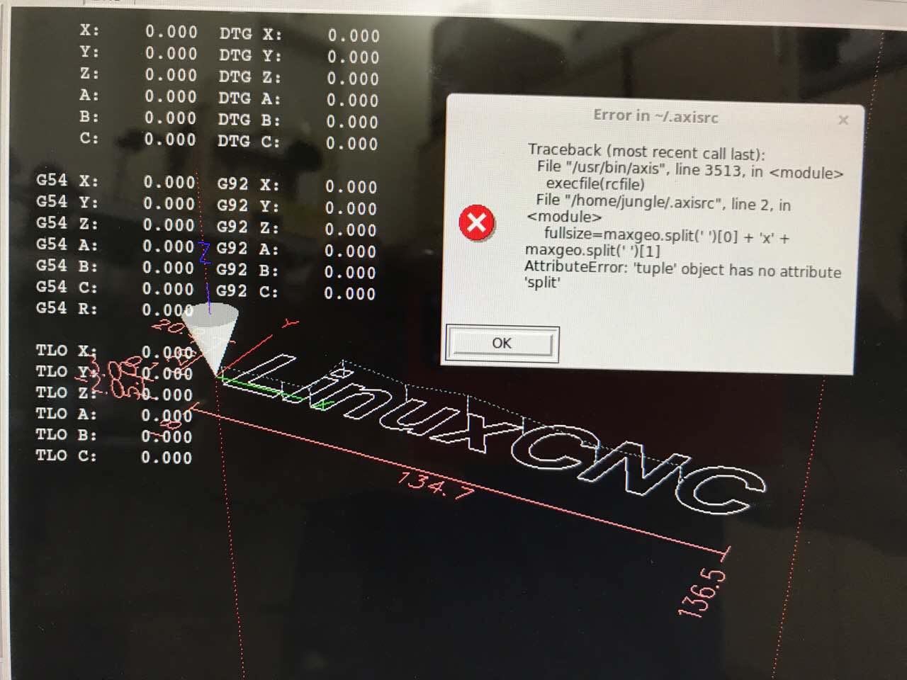

I am British from the UK. However I live and work now in HCMC (aka Saigon) Vietnam, Basically ALL is Vietnamese language and impossible to find any Linux Chaps here that speaks english, as I said in my previous post, curently using a 6-axis chinese Mach 3 controller to get up and running, and trying to switch to LinxCNC.
Finding myself learning Linux, Python, LinuxCNC all at one time which is allot.
Last night I installed Cinamon - MINT 18.1 and was able to download LinuxCNC and compile from source. The cool part is now my Dell 22 inch Touch Screen WORKS!!!
I have here on the Bench got 1 Switch tied to Home ALL Working and axis XYZA working
WHen I say Working I got the drives turning NOT moving anything
Been editing the HAL and INI file copy and pasting from the XYZA created by Pncconf Wizard copying the A-Rotary stuff and making a B and C version of the same. But Linus will not start at all.
I am using the 6i25 in the 5i25 Mode
I am using 2 7i76 daughter boards
Port 3 is XYZ
Port 2 is ABC
So that is the Latest from JUNGLE LinuxCNC today.
Any Help Appreciated
Port 3 is XYZ
Port 2 is ABC

I'd suggest you run linuxcnc from the command line and watch for the errors. If linuxCNC does not start it is usually a syntax error and it halts as soon as it finds the first one. So fix it and try again and see if there is another error and move onto it.

This is ther terminal Dump On Startup from the Command Line

is home/jungle/.axisrc a custom file?
It does not seem to be in a standard LCNC location. It looks like in line 2 of that file, you are trying to split a string but the object is a tuple (a pair of values) not a string. I think it is an error of your doing, not a problem with LlnuxCNC.
- Posts: 12178
- Thank you received: 4155
21 May 2017 07:58 #93433
Replied by rodw on topic LinuxCNC Job CONTRACT - OFFER MEsaIO
Looking at your error dump, you have also edited your files on a Windows machine and the line endings are wrong format. use dos2unix to convert your config files to Linux format. See www.linuxcommand.org/man_pages/dos2unix1.html
See messages near the end of file for file names.
If you must edit on Windows download the free notepad++ text editor but it is better to do all editing on a Linux machine.
Clearly something wrong with font handling, but fix the obvious first.
