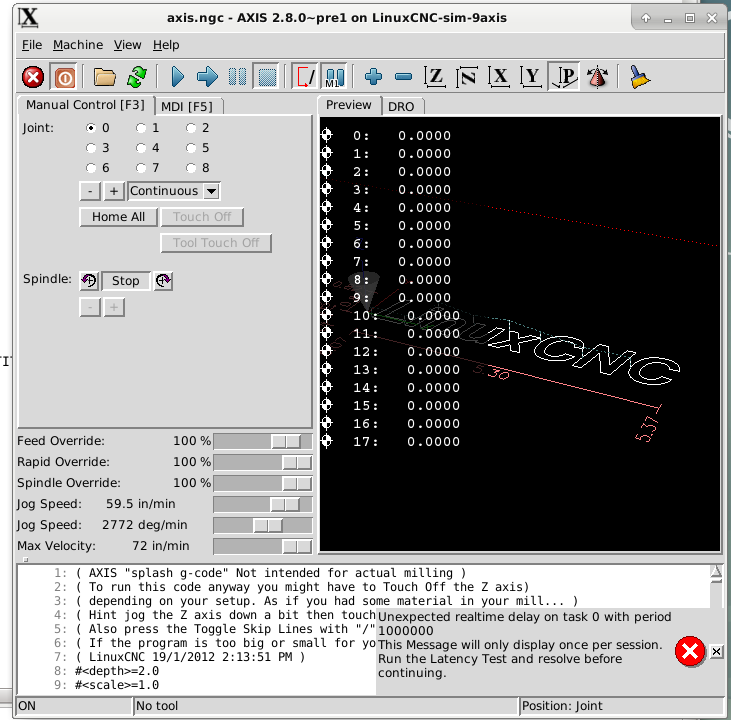

29 Aug 2017 23:01 - 29 Aug 2017 23:02 #98168 by andypugh
Replied by andypugh on topic What Mesa card for that?
I don't think you need extra G-code coordinates to drive more joints. And no matter how many joints there are the tool tip position and orientation is completely described by XYZABC.
So, I think that all is needed, in theory, is to increase EMCMOT_MAX_JOINTS
github.com/LinuxCNC/linuxcnc/blob/master...tion/emcmotcfg.h#L23
A bit of work is needed to make Axis display a radio button for all the axes, and currently the number of PIDs in HAL is limited to 16 (easy fix).
But other than that, things seem to work.

30 Aug 2017 06:58 - 30 Aug 2017 07:02 #98184 by bkt
Replied by bkt on topic What Mesa card for that?
thanks for indicate my the right file.
I not thinks was so big problem modify axis gui. A 19" screen resolution 1280*xxx is big enough for containing all checkbox needed.
Monday I try to improve these modification. If work I will share the result on my github.
regards
giorgio
