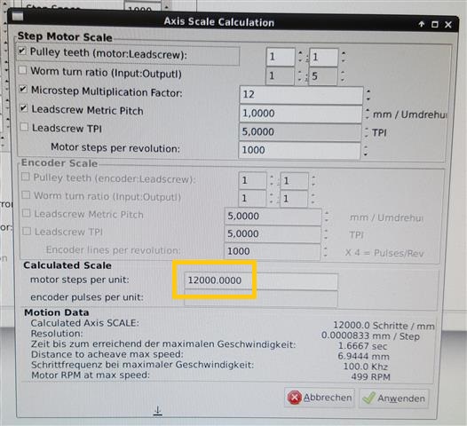

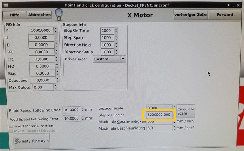

23 Oct 2017 20:05 #100693
by Jan Weber
Replied by Jan Weber on topic How to completely disable PID on a MESA 5i25 / 7i76 setup...
I still had Problems with my MESA-Setup, because it looked like I didn“t disable the PID-controller.
The reason for my servo-drivers showing error as soon as the motors startet moving was something else:
The scale calculation of the stepconf-wizard is obviously faulty. I entered my data in the fields so the result should be 12.000 steps per revolution for my test setup.
The wizard enters a value of 5.000.000 in the .ini-file as the steper scale. This is why the motors start moving with acceleration parameters far beyond the possible limits.
Can someone crosscheck this with his machine?
Jan
Jan

- Ferdl
- Posts: 6
10 Feb 2019 07:44 #126130
by Ferdl
Replied by Ferdl on topic How to completely disable PID on a MESA 5i25 / 7i76 setup...
Hi Jan,
this is a bug in the PncConf Wizard. I had the same problem the last days if I enter my values into the wizard the saved calculation was a mess. The reason is if you linux cnc installation has german language setting. The wizard can not work with the differenze between dot "." and comma ",".
I changed my language to english and the problem was gone.
I'm not sure where I can report this? I think this problem occurred many times if the user setup an german language.
Have fun
Ferdl
Have fun
Ferdl
