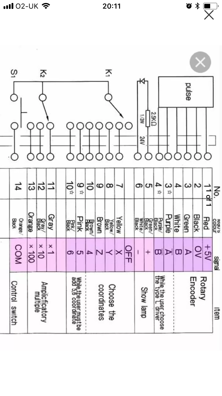

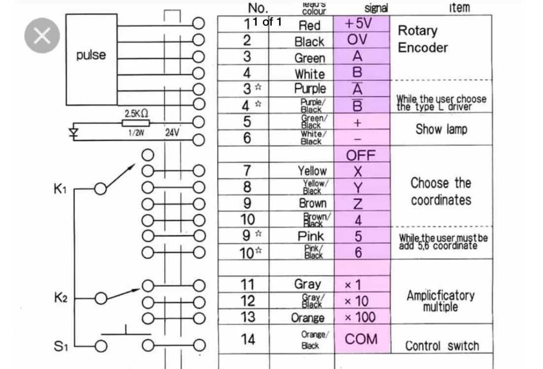

Hello I have the I/0 boards 5i25 and 7i76. So far I managed to wire up a stepper drive and get it to move. I’ve no other experience with linuxcnc or Mesa cards.
I recently bought an mpg pendant which is a 100ppr pulse generator with two switches, one for axis select x y z a and one for increments.
I would like to connect the mpg to the 7i76 and make it work but I don’t know how to do that and your help will be much appreciated.
Many thanks
Many thanks

You probably want to use an mpg encoder on the 7i76 rather than the spindle encoder. To do that you need to set the 7i76 to mpg mode. This converts some of the GPIO pins to encoder inputs.
Page 18 here: www.mesanet.com/pdf/parallel/7i76man.pdf
Note that these are single-ended encoders, so I think you just ignore the /A and /B pins.
To set the 7i76 to MPG mode change the "loadrt hm2_pci" line in the HAL file to include config="sserial_port_0=20xxxxxx"
(keep anything else that already exists in that config string)
Then you should see hm2_5i35.0.7i76.enc0 and enc1 which should increment as you turn the knob.

Once you get it enabled, there is a worked example of a single axis MPG for a 7i76e on my build thread
forum.linuxcnc.org/show-your-stuff/32029...tter-build?start=200
You just need to add the axis selection switch to this which is not difficult and there is a good example in the MPG docs.
linuxcnc.org/docs/html/examples/mpg.html

‘Then you should see hm2_5i35.0.7i76.enc0 and enc1 which should increment as you turn the knob.’
I think I’ve changed to mode 2 and I’ve been back through the pncconf wizard and it all looks the same to me?
Can you tell me where I might see that please? Is it in the Hal file?
Many thanks
Many thanks
- Posts: 19908
- Thank you received: 4660
26 Oct 2017 15:46 #100855
Replied by andypugh on topic 5i25+7i76 wired pendant help please
Yes, you will see it in the HAL. Pncconf has done its job at this point, you are at the hand-customisation stage.
(and pncconf doesn't know about smart serial modes as far as I know, and will in fact revert your config if you run it)
I would now suggest wiring up the pendant ant watching the HAL pins change in Halshow (use the Watch tab, as that updates live). If the wiring is correct you should see the encoder counts change and various things happen on the GPIO.
