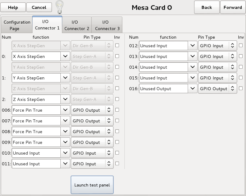

I just got a Mesa 7i76e card, and I cannot figure out what the pin mapping is between PnCConf's Pin numbers and 7i76e's pins.
Right now I am trying to get TB6 Output pin 7 to be high (for testing purposes). I have tried setting that pin to 'Force Pin True' and 'GPIO Output', but it doesn't seem to work.
I have attached a screen shot of my PnCConf configuration tab.
Can someone help me understand how the pin numbering works in the PnCConf?
Much appreciated,
Larry

All of the pins on that screen refer to the pins used for step/dir on the 7i76. (They can be used for GPIO when not used for step/dir.) The 32 input and 16 output field io points can only be seen if the 7i76e is plugged in and properly powered up.
Are you sure you've properly configured the Ethernet connection to the 7i76e? Are you running a version of Linux with a Preempt-RT kernel?

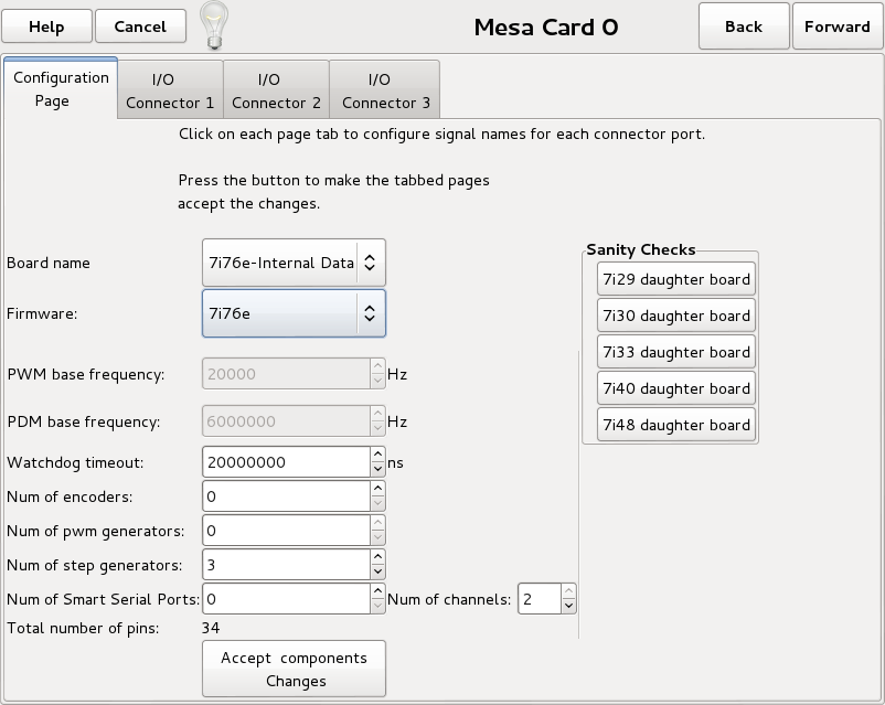

What version of linuxcnc are you using and what does the configuration tab look like?
Chris M
And that is where you select the field i/o .
Chris M

Shouldn't the number of smart serial ports be set to 1 (near the bottom of that screen?

Yes! Setting the smart serial ports to 1 gives me the 'i/o ss#0' tab.
Thanks for the help!
