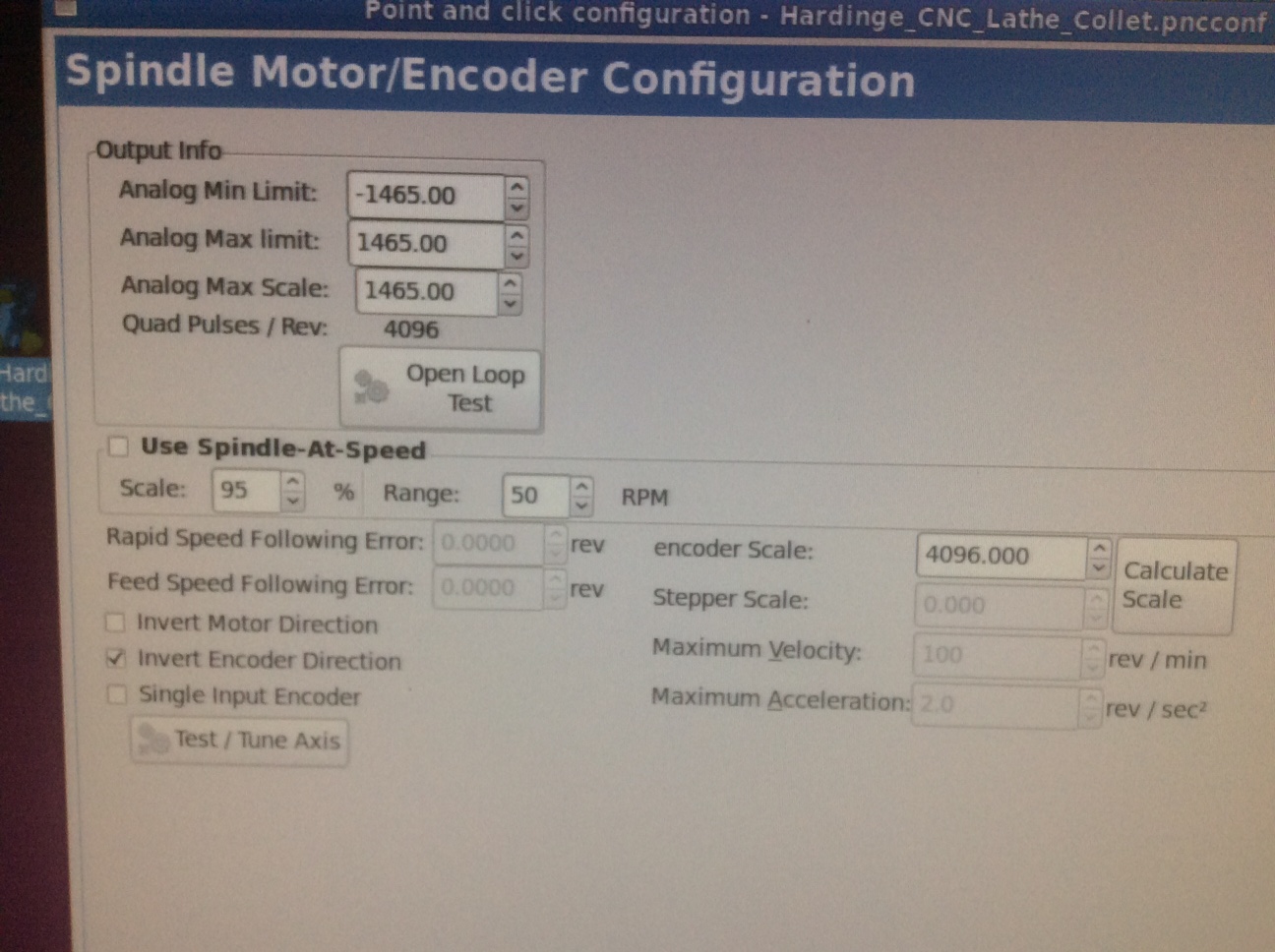

I've used PnCConf to configure a 5i25/7i76 setup for a lathe on Version 2.5.5 of Linuxcnc. It's all gone well, so a big thanks to Mesa and those who develop/support Linuxcnc.
I have configured the spindle drive using the TB4 spindle output to control a ABB VFD, and the TB3 encoder input to read a spindle encoder. Reading a few other posts, I've managed to get spindle enable, direction, and speed sort of working, and would be thankful if someone could run a critical eye over the following settings, and let me know where I've messed it up. Note that the maximum rpm of the spindle motor is currently set at 1465rpm, and the encoder is quadrature 1024ppr.

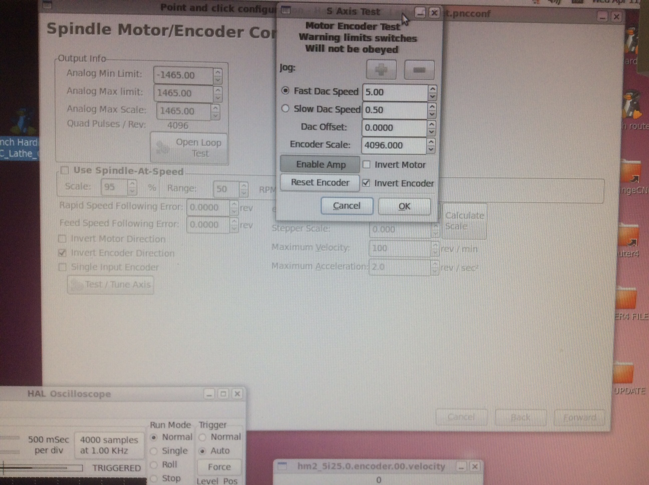

Well, nothing desperately wrong, just little buggy things. When operating with the Manual Control (F3), I can get full spindle speed at 100%, but spindle speed drops to 0rpm when the Spindle Override slider is at 28%. (This could be a separate VFD issue.) When running the spindle in reverse in Manual Control, the + button slows the spindle down, and the - button speeds it up. And I did have the S Axis Test feature working, but now it has stopped.

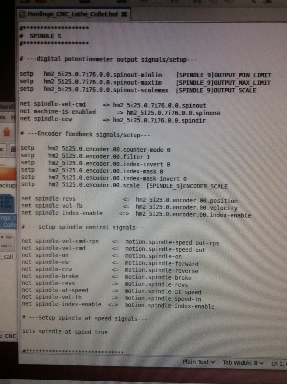

I've dived into the danger zone HAL file and had a crack at: tacking -abs onto the end of some spindle motion signals; and/or adding completely new lines in the spindle control signals section based on what I've read in similar posts. The results were as expected - spectacularly unsuccessful, varying from no effect, to crashing the program on start-up with a "motion.spindle-speed-out-rps-abs pin does not exist" error. (I did read in the basic HAL manual, that, "If the signal does not exist net creates the new signal", so this adds to the confusion.)
The below text is the spindle section from the original HAL file before I started editing it. I am going to keep fiddling with it, but if anyone could point out the bleeding obvious to me it would be greatly appreciated.
Time for a quad-shot espresso,
Steve

01 May 2018 07:02 #109900 by andypugh
Replied by andypugh on topic Another 7i76 Spindle Setup Question
net spindle-vel-cmd-rps    <=  motion.spindle-speed-out-rps
net spindle-vel-cmd        <=  motion.spindle-speed-out
net spindle-on             <=  motion.spindle-on
net spindle-cw             <=  motion.spindle-forward
net spindle-ccw            <=  motion.spindle-reverse
net spindle-brake          <=  motion.spindle-brake
net spindle-revs           =>  motion.spindle-revs
net spindle-at-speed       =>  motion.spindle-at-speed
net spindle-vel-fb         =>  motion.spindle-speed-in
net spindle-index-enable  <=>  motion.spindle-index-enable
This block sets up all the spindle _signals_. You probably don't actually use all of them.
Somewhere else in the HAL file, in a section you haven't shown, is likely to be the part that links the spindle-vel-cmd signal to the 7i76 analogue output.
I expect that all you need to do is to change the single line:
to
net spindle-vel-cmd        <=  motion.spindle-speed-out-abs
The following user(s) said Thank You: Skippy1
