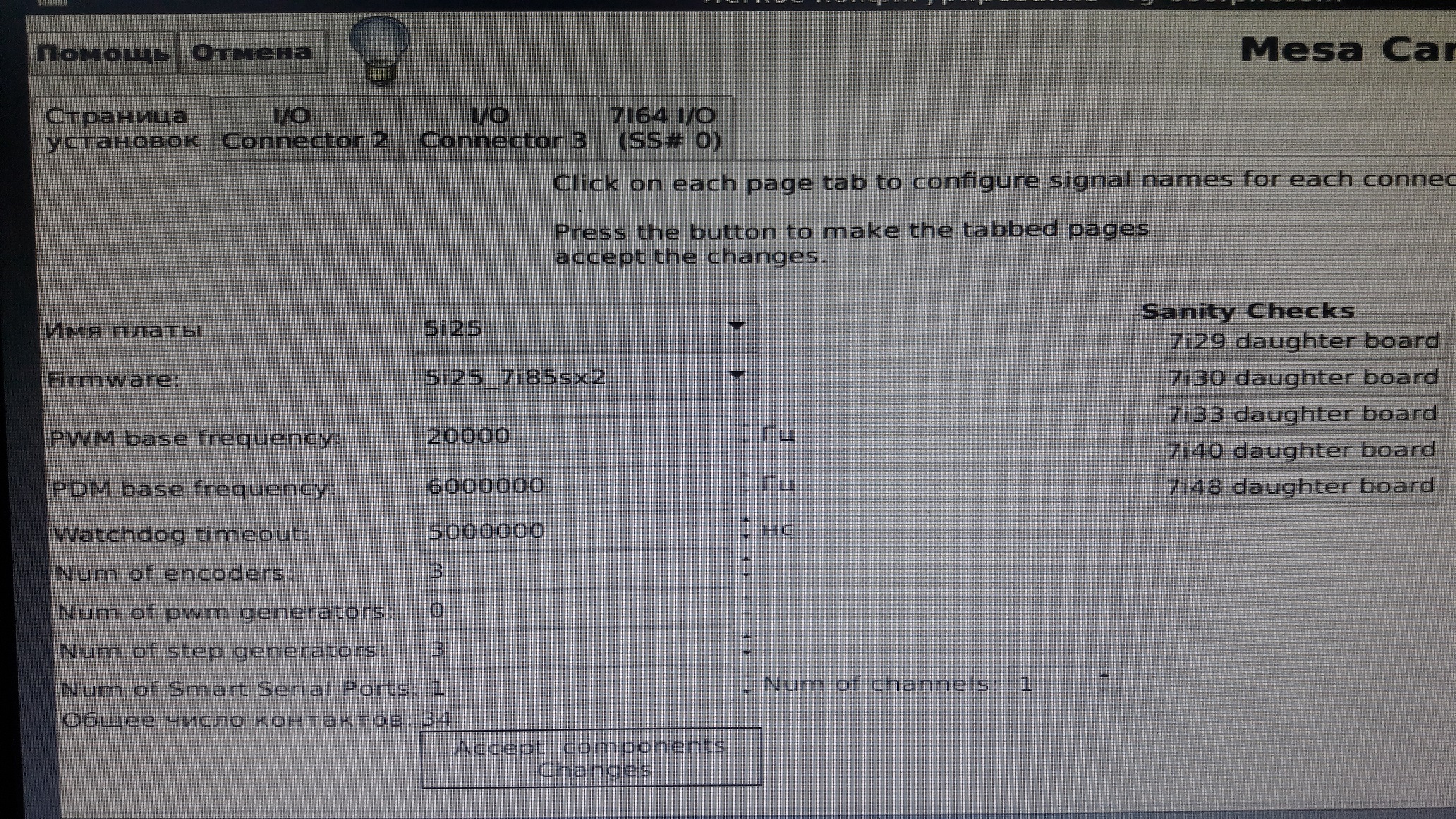

- lsv80
- Posts: 7
08 Feb 2019 09:47 #126005
by lsv80
Replied by lsv80 on topic Mesa 5i25+7i85S+7i66

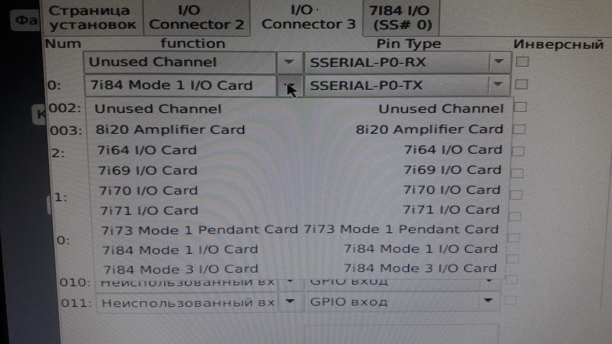

- Posts: 18122
- Thank you received: 5337
08 Feb 2019 10:49 #126010
Replied by PCW on topic Mesa 5i25+7i85S+7i66
Yes pncconf has no direct support for the 7I66 but you can make a generic 7i85sx2 configuration
and add the 7I66 I/O to the hal file
If you make a generic 7I85sx2 configuration and start it, you can list all the 7I66 pins with:
and then use the 7i66pins.txt file as a "donor" file for copy pasting into the hal file and
connecting them to the desired LinuxCNC pins/signals.
halcmd show pin | grep 7i66 >7i66pins.txtand then use the 7i66pins.txt file as a "donor" file for copy pasting into the hal file and

08 Feb 2019 11:51 #126012
by lsv80
I so and wanted to do as you wrote, but I cannot see this board 7i66.
I can't turn off this red light on 7i66.
Do I need to install the driver "sserial" for 7i66 or is it already preinstalled?
I tried to install this driver, but my command fails "sudo ./updatess 7i66 5i25 2".
