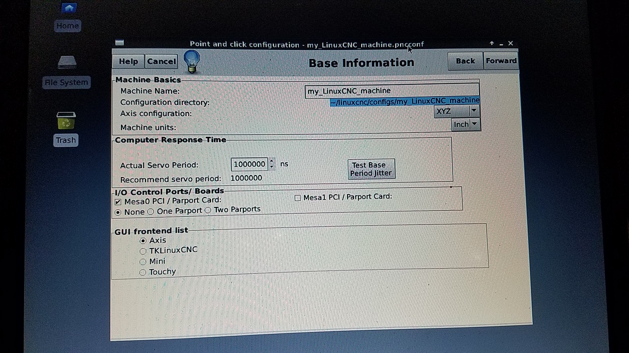

Hey Guys,
I apologize if this has been answered elsewhere but I am having a hard time figuring out what I need to do to configure these cards in the Pncconf Wizard. Much of the information I come across is from 6 or 7 years ago and I imagine things have changed since then. I have a fresh, updated version of LinuxCNC V2.7.14 loaded up on the computer. I have a brand new 5i25 and 7i77 plugged in and the jumpers in the correct position to provide 5v to the daughter card. My first problem I come across is when I try to run the Pncconf Wizard, I am missing the fields of information to select the card and PCI port number as shown in the photos. My second question at the moment regards firmware selection. I am only running one 7i77 but I do not see that as an option in the available firmware configurations, I see 7i77x2, 7i77x2 with one 7i77, but not a 1x 7i77 firmware config. Which firmware should I choose to run only one 7i77?
Is there a step/steps I have missed to cause these problems?

1. There is no need for a PCI port number/address
2. 7I77x2 with one 7I77 is the appropriate selection

Which screen are you referring to?
Mesa card options are set on the /Mesa Card 0' page.
That should be about 6 'clicks' in (depending on options and versions)

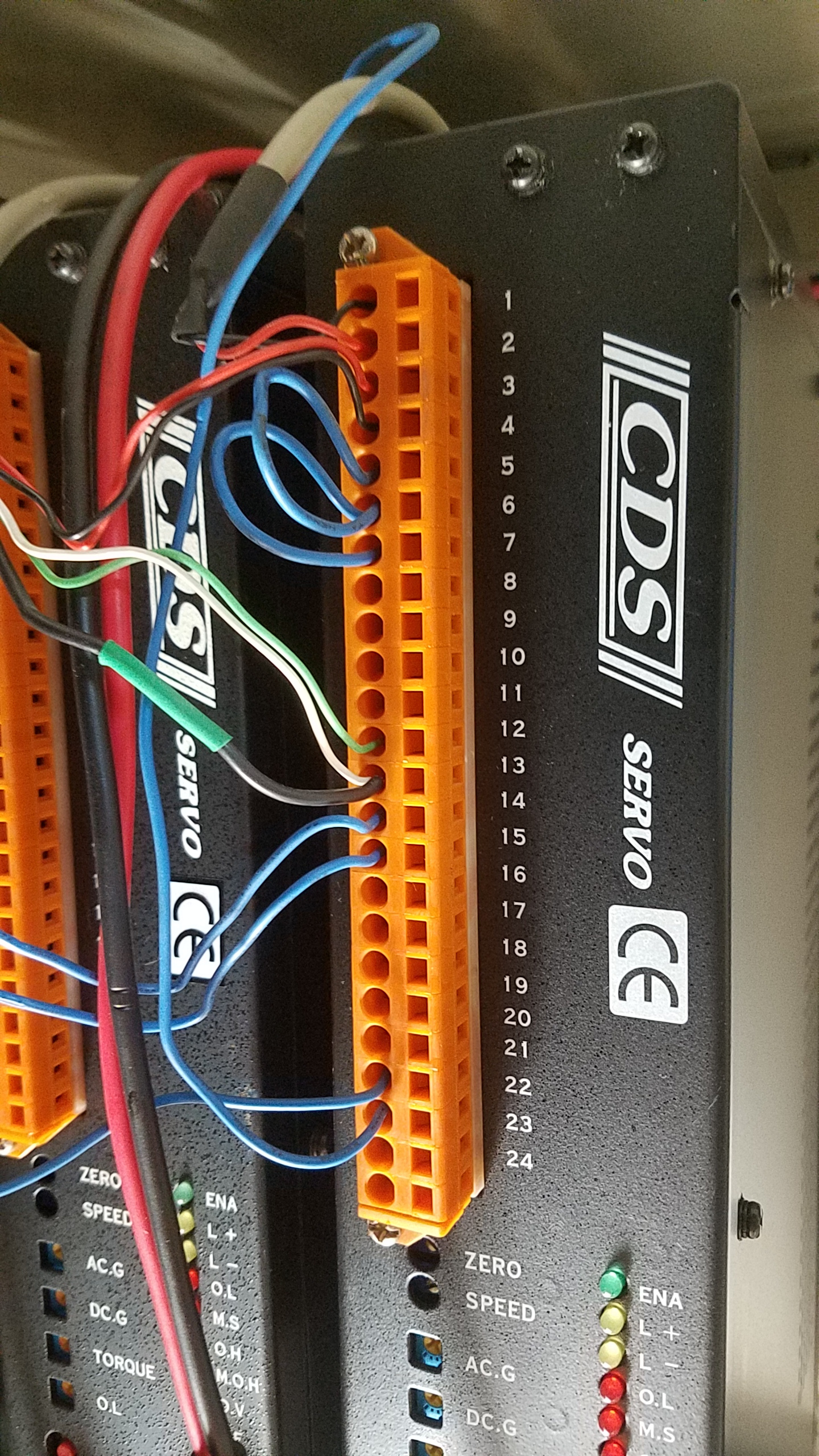

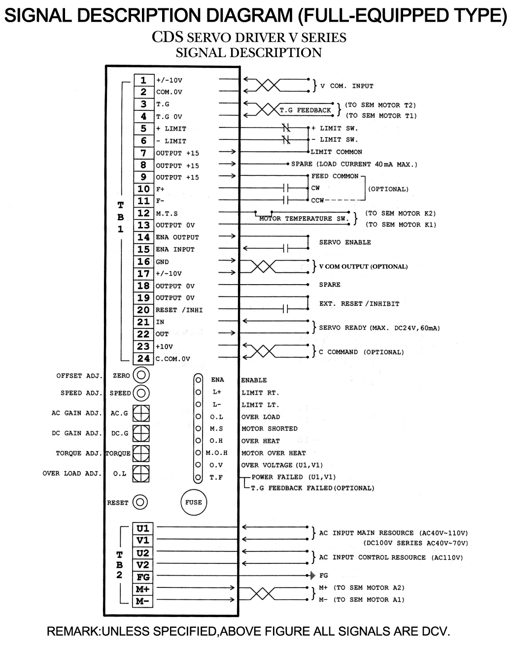

Excellent! This is the first time I have seen that particular servo tuning tutorial. Something immediately jumps out to me, under Prepare to tune", bulletin point 4, John says "Verify feedback direction (expect runaways) you may have to change the sign of the analog outputs." Can you elaborate on what he means by "change the sign of the analog outputs." The first thing that comes to my mind is the +-10v analog output and the associated 0v com wire. I say this because when I began working on the machine in question (an H.H. Roberts TW-31-MV by the way) I noticed that it looked like the servo drives were wired in reverse. I have attached the drive connections PDF and also a closeup of the drives as they were originally wired. You can clearly see the +-10v red wire and the black 0v com wire are backward according to the connection diagram from the manufacturer. At first, I had just attributed this to a peculiarity with connections on the defunct Anilam controller. Might they have done this intentionally to allow compatibility with an unusual encoder orientation?
I am farmiliar with basic AC/DC circuitry having soldered together electronics kits since I was a child, I am however not familiar with industrial motion control yet, I recently finished with a computer integrated machining program at our community college and have begun working in the industry operating an EDM machine for a local tool and die maker. However, since taking on the project of retrofitting this machine, I have learned am very fascinated with the control behind a CNC machine and have decided to go back to school part time in the Mechatronics program so I can gain a much deeper understanding of everything involved with industrial motion control. Also, because if I want to get anything done at work, knowing how to operate the machines apparently isn't enough, you have to know how to diagnose and repair the damn things if you want to make regular progress with my current employer. But I want to again thank you all because I would not be on my current track without your help!!!
