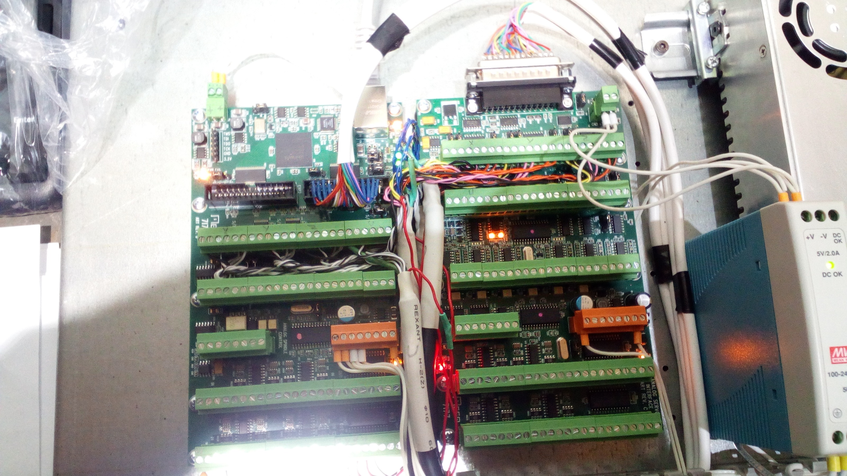

Good time!
I am building a 3.5 axis machine for wood processing. To drive the axes, Chinese-made servos are used, which perceive step and direction signals, but have encoder outputs for the CNC system. I would like to have feedback on the axis, but the 76E board does not work like that. On the shelf in the workshop there was a 7i77 board, which theoretically can help me read encoders. I made a connecting cable for them.
As I understand it, I need to flash the 7i76E board to work with 77. How to do this? PnCConf
Please tell me where to look and what to read on this topic. I'm just starting to study the Mesa boards and their settings

Why are you not using +-10v analog velocity control for those servos? Usually the chineese drives can do +-10v. then you just take encoder directlyu in the 7i77.
Use mesa flash for changing the firmware.

Get the support files from mesanet.com for the 7i76e, unzip them, find one that has 7i76e and 7i77 in the name with the .bin extension, open a terminal and type
mesaflash --device 7i76e --addr 10.10.10.10 --write name_of_the_bit_file.bit

Actually not true. With a closed loop setup the stepgens are controlled with a velocity command and a PID loop and tuned exactly the same way as an ordinary analog velocity command servo and have the same feed forward capabilities.
There are more inexpensive options to add encoder feedback to your 7i76e than a 7i77, such as a 7i85 or 7i89. (I understand that the 7i77 may have been at hand, but you may want it for a different project down the road.)

I will ask for help again. I executed the command in mesaflash, but after its successful execution in pncconf no new firmware options appeared to choose from.

1. After you flash a FPGA card, you must either power cycle the card or use mesaflashes --reload option:
mesaflash --device 7i76e --addr 192.168.1.121 --reload
(this loads the FPGA with the newly updated flash memory image)
2. I'm not sure how much the --sserial option reports but you should see the new pinout with:
mesaflash --device 7i76e --addr 192.168.1.121 --readhmid
