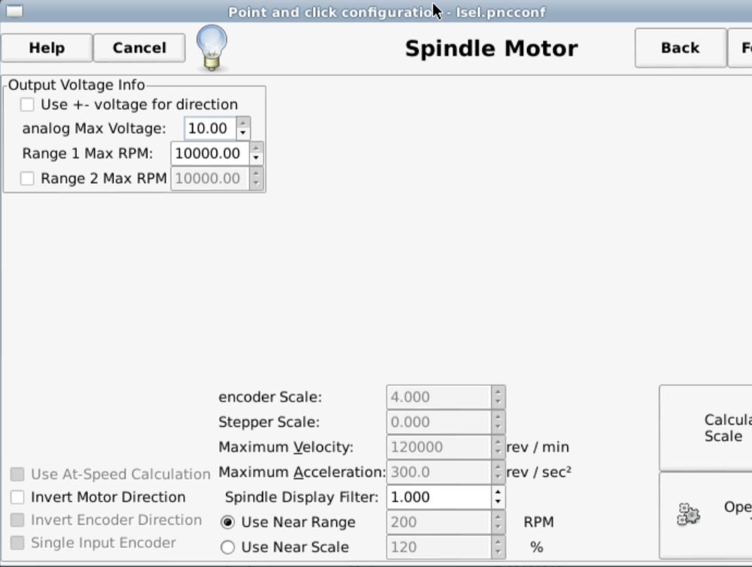

Hello
I have 5i25 and 7i77 cards. Now I try to setting spindle in pncconf. My spindle has 24000rpm. How can I add this spindle rpm to configuration ? The limit in pncconf is 10000rpm ( 0-10V). When I change 10k rpm to 24k rpm manually in .ini file it doesn't work.
See attachment
See attachment

25 Mar 2020 02:24 #161395
Replied by cmorley on topic PnCConf spindle max rpm limit issue
What version of linuxcnc are you using?
You will have to stick with 10000 and then edit the INI file after.
In the INI file you'll see something like this at the bottom:
Change all (four) of the 10000 to 24000, keep the signs the same as your file.
Chris
[SPINDLE_0]
P = 0.0
I = 0.0
D = 0.0
FF0 = 1.0
FF1 = 0.0
FF2 = 0.0
BIAS = 0.0
DEADBAND = 0.0
MAX_OUTPUT = 10000.0
OUTPUT_SCALE = 10000
OUTPUT_MIN_LIMIT = -10000
OUTPUT_MAX_LIMIT = 10000
Chris

I just noticed you didn't select +-10 volt output so this would be they way it should be:
I'll increase the limit to 100 000 in the future
Chris
[SPINDLE_0]
P = 0.0
I = 0.0
D = 0.0
FF0 = 1.0
FF1 = 0.0
FF2 = 0.0
BIAS = 0.0
DEADBAND = 0.0
MAX_OUTPUT = 24000.0
OUTPUT_SCALE = 24000
OUTPUT_MIN_LIMIT = 0
OUTPUT_MAX_LIMIT = 24000
Chris

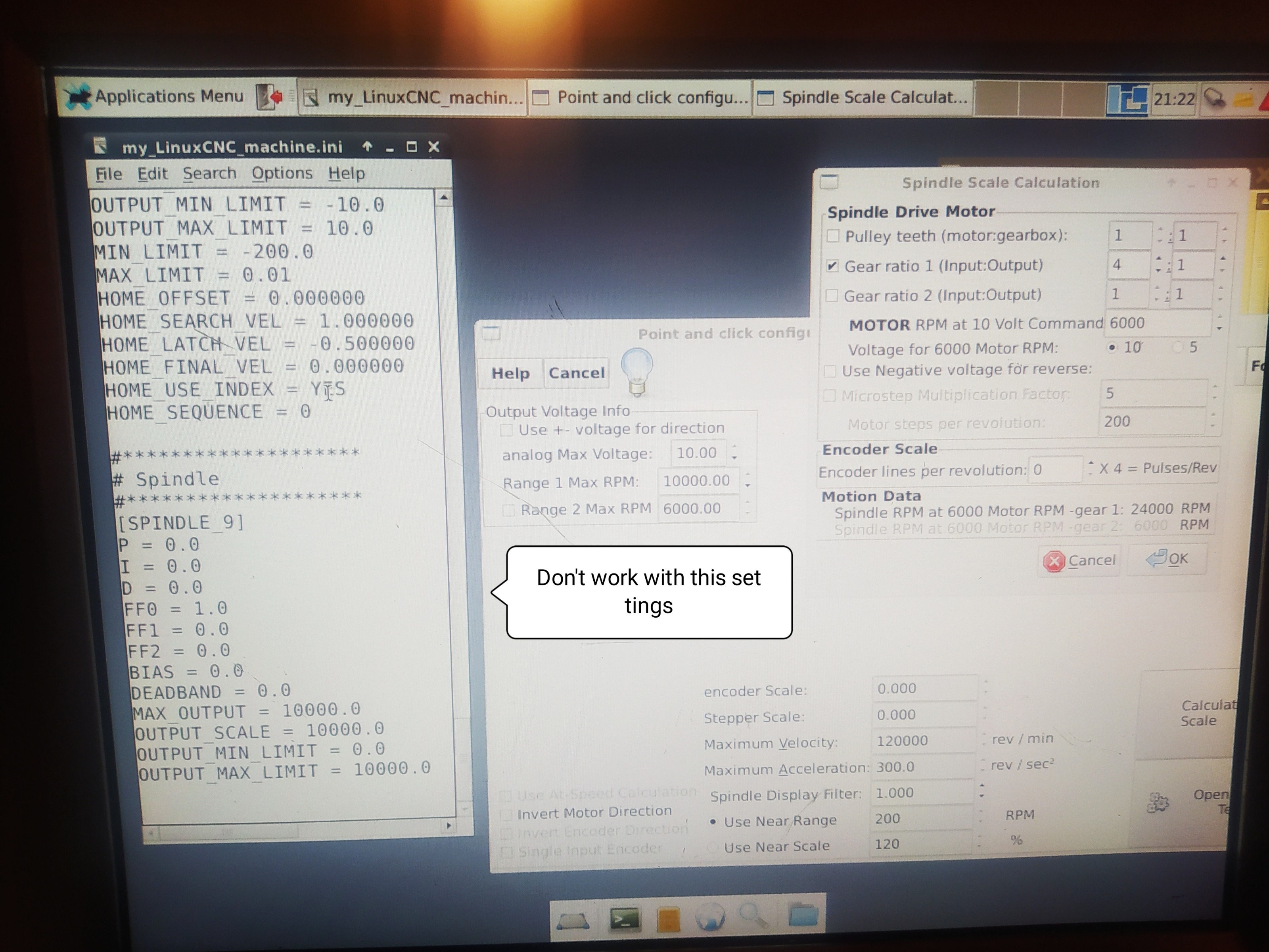

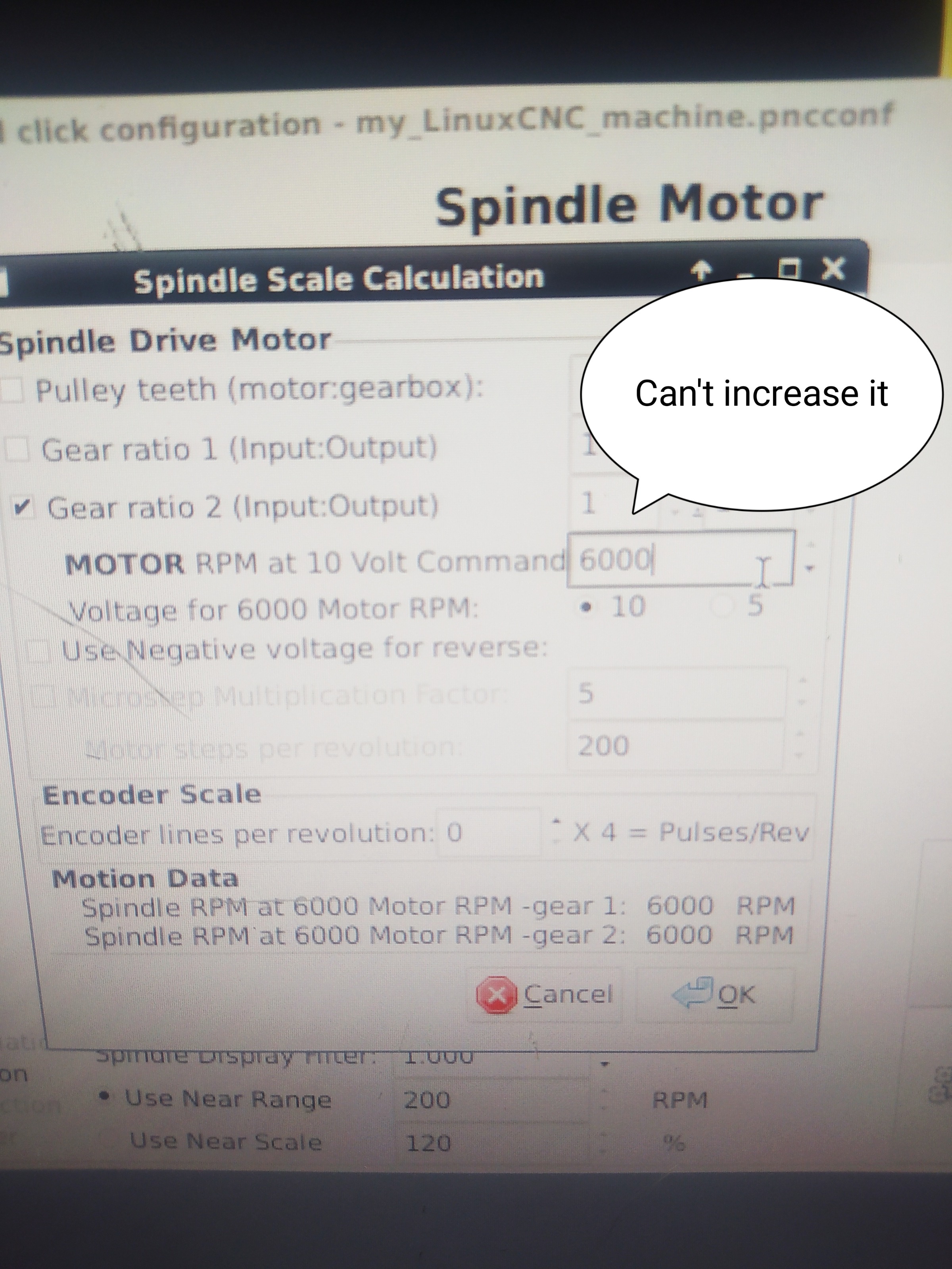

I have version 2.7.0. I tried to put settings as You said but it didn't work. Work propertly with settings:
[SPINDLE_9]
P = 0.0
I = 0.0
D = 0.0
FF0 = 1.0
FF1 = 0.0
FF2 = 0.0
BIAS = 0.0
DEADBAND = 0.0
MAX_OUTPUT = 6000.0
OUTPUT_SCALE = 1.0
When I try to change MAX_OUTPUT = 24000.0 then Linux see still this 6000rpm.
When I set M3 S1000, then spindle has 4000rpm etc....10V at analogout5 is when I set S6000 or more.
I'm beginner in linuxcnc
Thanks for understanding.
[SPINDLE_9]
P = 0.0
I = 0.0
D = 0.0
FF0 = 1.0
FF1 = 0.0
FF2 = 0.0
BIAS = 0.0
DEADBAND = 0.0
MAX_OUTPUT = 6000.0
OUTPUT_SCALE = 1.0

Well I can;t see how that works at all.
Can you post your config files?
