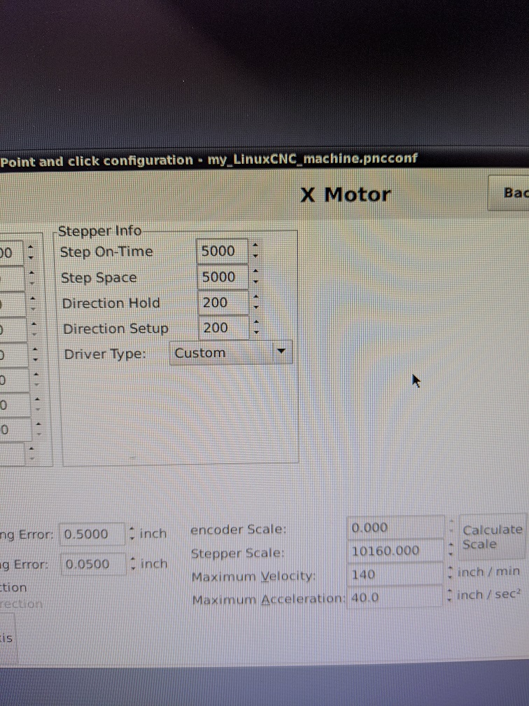

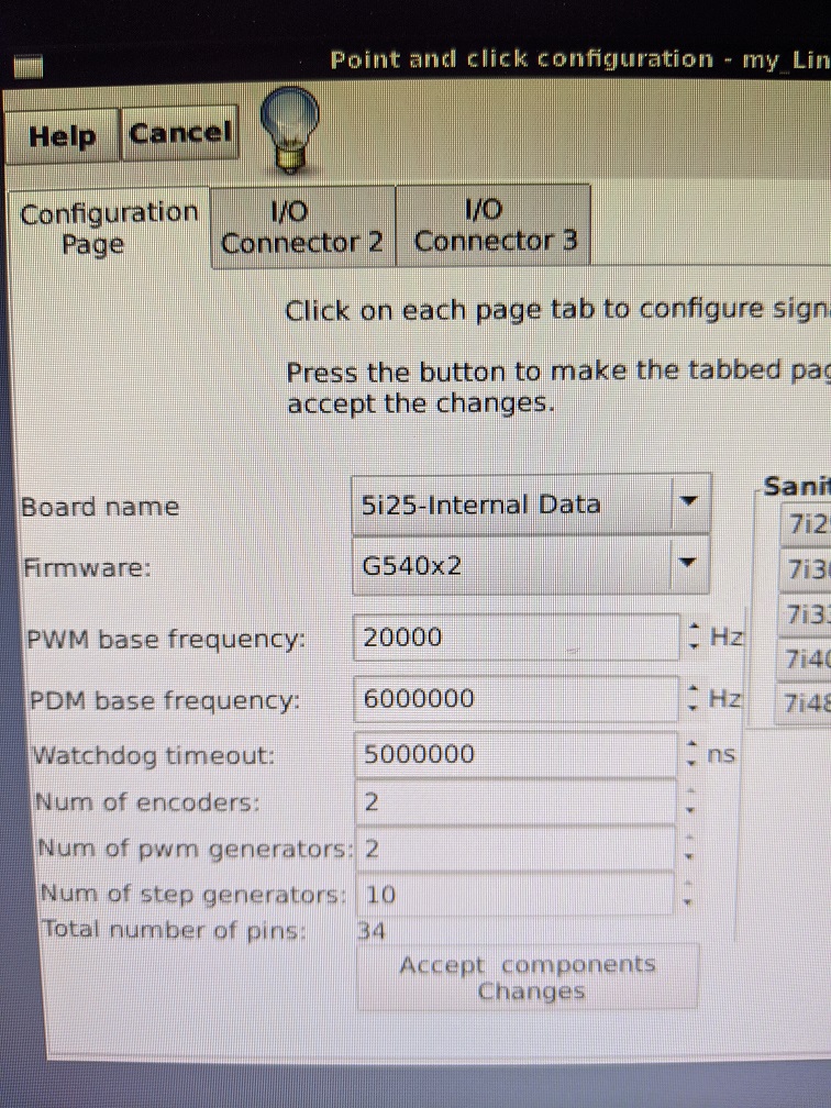

I have a 6i25 running a G540 (basic ballscrews, direct drive, nothing fancy at all) and flashed the board using the Mesaflash utility using the command line. I'm using the latest stable release, a J1900 board, and everything is rather vanilla.
Other than the weird pinmapping and my inability to figure out the limit switches everything runs smoothly.
I used the default 1khz basethread (?) and had a few days of stability but recently had an issue with a complex program which forced me back to simply using a parallel port due to the risk of failure.
I apologize for pasting it all--I think a third through it goes over how the system encountered latency and had to shut down but obviously my understanding isn't particularly deep.
This is what I found most relevant in an attempt to save one time from going through the entire dump:
(I'm guessing that I can lower down how many times per second everything is updated--but the docs don't elaborate much and my knowledge is apparent from my post)
Please excuse the photos I took of the screen.
I simply used the defaults the wizard provided--only "interesting" thing I can think of is I'm using a 5mm per turn ballscrew and have the units set to inches.
task: 1409597 cycles, min=0.000019, max=0.123975, avg=0.010411, 15 latency excursions (> 10x expected cycle time of 0.010000s)(I'm guessing that I can lower down how many times per second everything is updated--but the docs don't elaborate much and my knowledge is apparent from my post)

Replied by tommylight on topic Mesa Card 6i25. Linux CNC Error during program operation
step time = 500
step space = 5000
direction setup 20000
direction hold = 20000
servo period must be 1000000 or 1 million
And you have very bad latency issues, so try disabling everything related to power saving, speed step, hyperthreading, virtualisation, etc in the BIOS.
step space = 5000

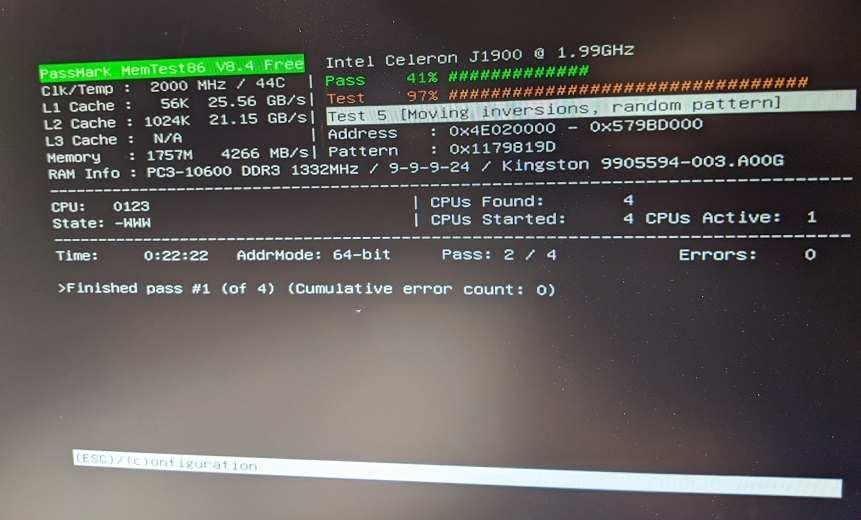

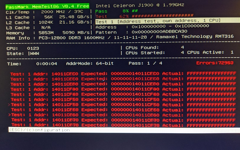

I think we've found the problem and it took less than a few minutes of memory testing.
All it took was adding an additional stick of ram and not realizing that it could be causing an intermittent problem--which has wasted 10+ hours of time, and resulted in me collecting another G540 to my collection.
Attached are screenshots of both machines with Memtest86--test your memory is my only advice at the moment for others!
