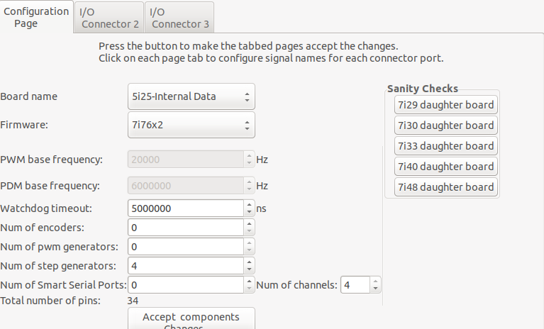

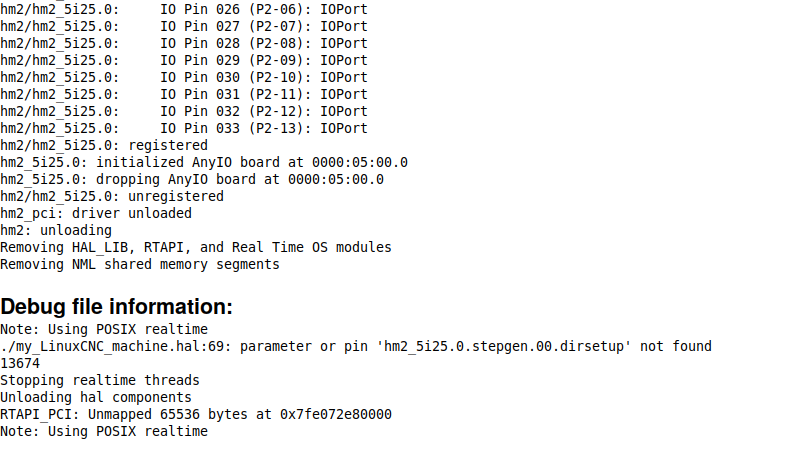

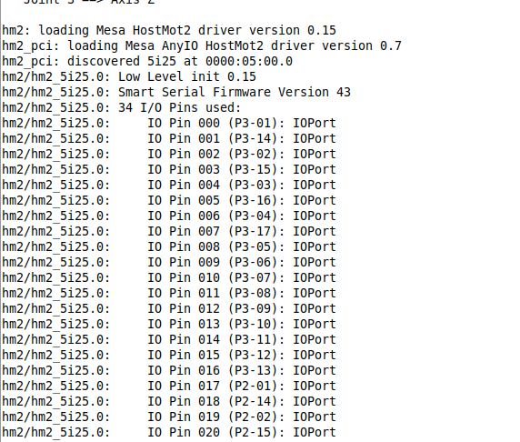

Hello, I am using a 4 stepper motor machine and the mesa 6i25 card with a 7i75 breakout card and the gecko drivers used are the G214V. I wanted to do the pncconf wizard to configure my mesa card and I chose the 7i76*2 firmware as I have to connect the step, dir,fullstep, enable, error of each driver... but I get the following error. Can someone help me?

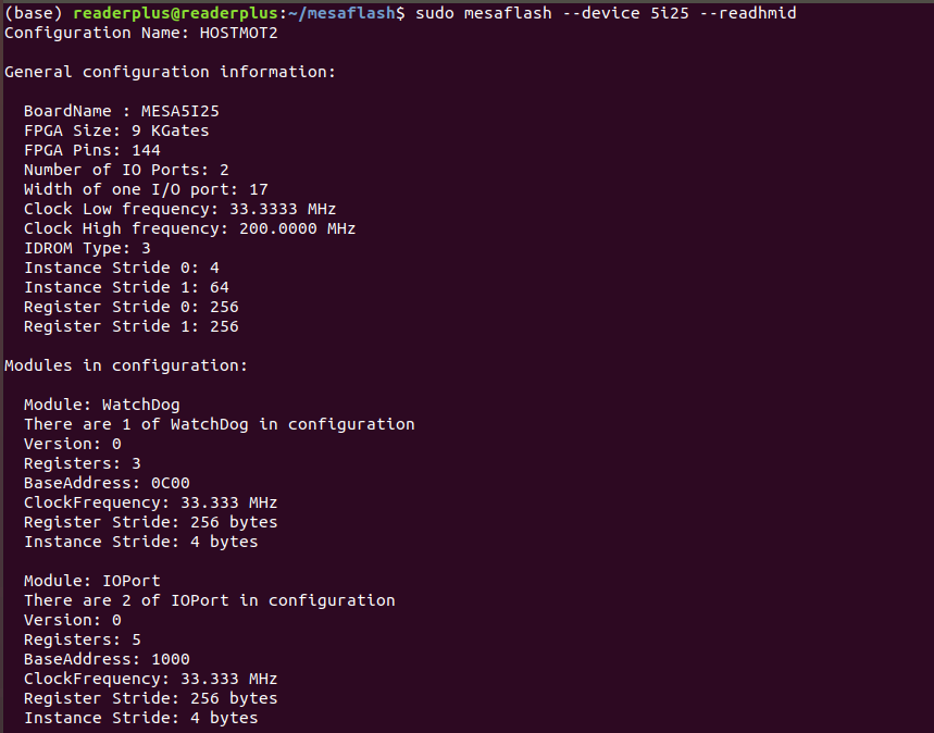

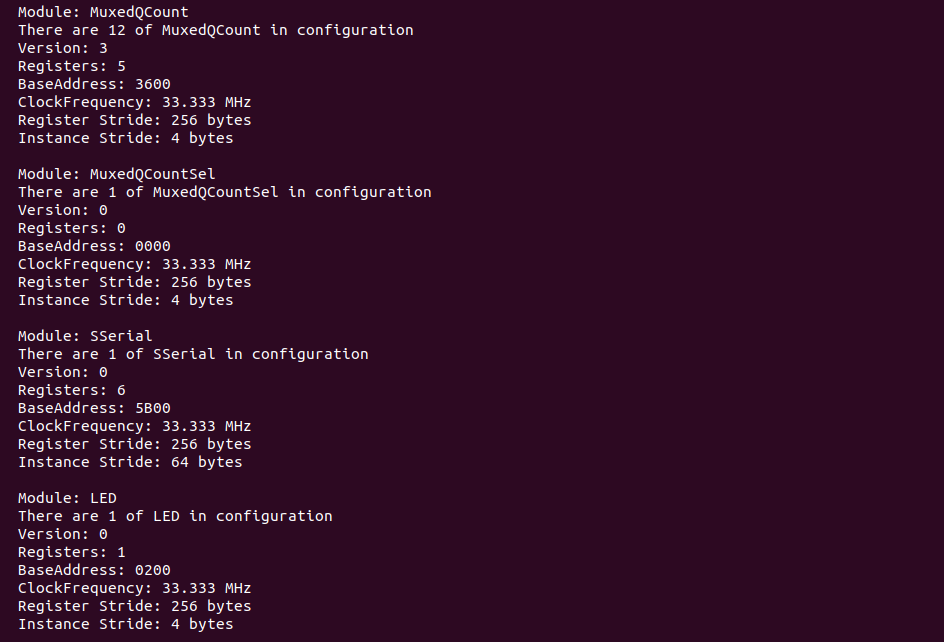

What firmware is loaded on the 5I25?
what does
sudo mesaflash --device 5i25 --readhmid
report?
what does
report?

05 Nov 2020 22:48 #188455
Replied by PCW on topic pncconfig error
You may need to install mesaflash on your system
github.com/LinuxCNC/mesaflash
Bottom of page has install instructions

- Online
- Posts: 18071
- Thank you received: 5309
05 Nov 2020 23:20 #188462

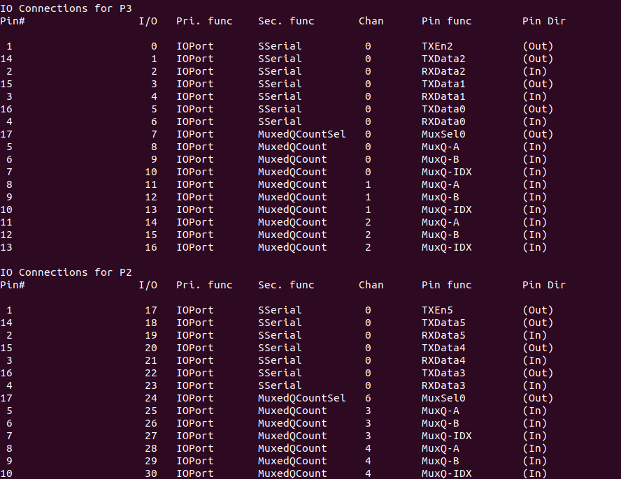

OK that's 7I77 firmware
For a 7I75 I would probably choose firmware with stepgens but no SSerial like 5i25_g540x2.bit
