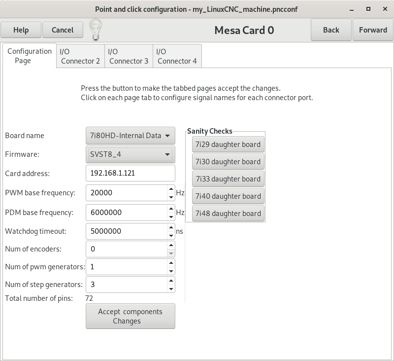

now a new set of errors (attached report). when i got an error from the stepgen associated with the charge_pump, i removed it to see if it would help, but then i got the same error for the stepgen 00. fortunately, i haven't connected this to my machine yet.

Replied by PCW on topic Mesa 7i80HD-16: startup errors
It appears that the configuration you have loaded in the FPGA card has no
stepgens present

12 Dec 2020 10:14 #191730
Right but that does not mean you have the correct firmware installed in the 7I80
What does:
mesaflash --device 7i80hd --readhmid
report?
What does:
report?

12 Dec 2020 10:31 #191733
by travis036
Replied by travis036 on topic Mesa 7i80HD-16: startup errors
i think i assumed that the pncconf flashed the FPGA... how do i flash the FPGA card?
with mesaflash
