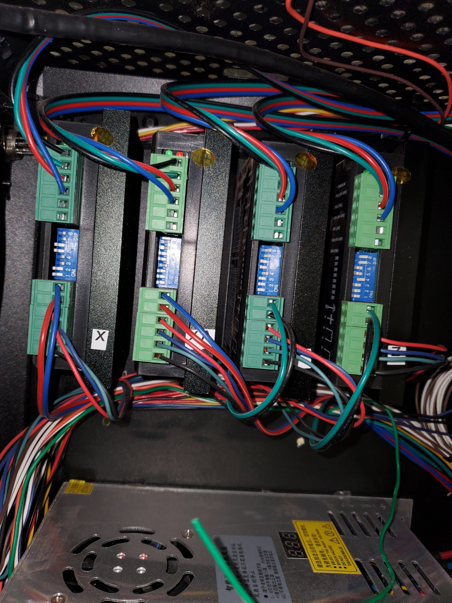

I am trying to use the Test/Tune Axis button in pncConf to move the steppers. Changing settings in there as stated above and using the enable button and run or + -
- Jalapeno56
- Posts: 101
- Thank you received: 17
02 Feb 2022 23:33 #233844
by Jalapeno56
Replied by Jalapeno56 on topic Cannot get stepper motors to move
I changed the homing requirement, no change. Changed homing velocity to 200, no change.
- Posts: 21981
- Thank you received: 7481
03 Feb 2022 00:04 #233846
Replied by tommylight on topic Cannot get stepper motors to move

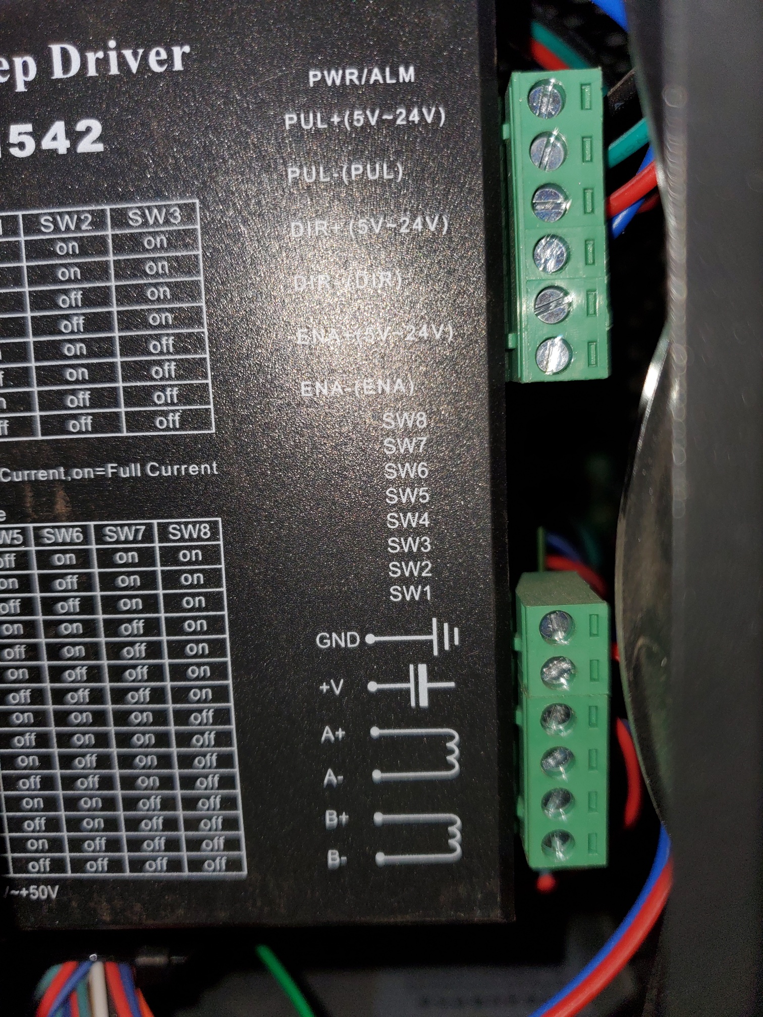

Upload a picture of wiring here.
- Jalapeno56
- Posts: 101
03 Feb 2022 01:15 #233851
by Jalapeno56
The pics you asked for are attached. I have followed Norberts connection sheet and double checked all connections after re-install of my 7I76e.

As the DM542T does.
Replied by Clive S on topic Cannot get stepper motors to move
Does that drive have a switch on the end to change from 24v to 5v, if so make sure it is on 5VThe pics you asked for are attached. I have followed Norberts connection sheet and double checked all connections after re-install of my 7I76e.
As the DM542T does.
Last edit: 03 Feb 2022 10:36 by Clive S.
- Jalapeno56
- Posts: 101
04 Feb 2022 00:24 #233932
by Jalapeno56
@Clive S: there is no switch for voltage on these drivers.
