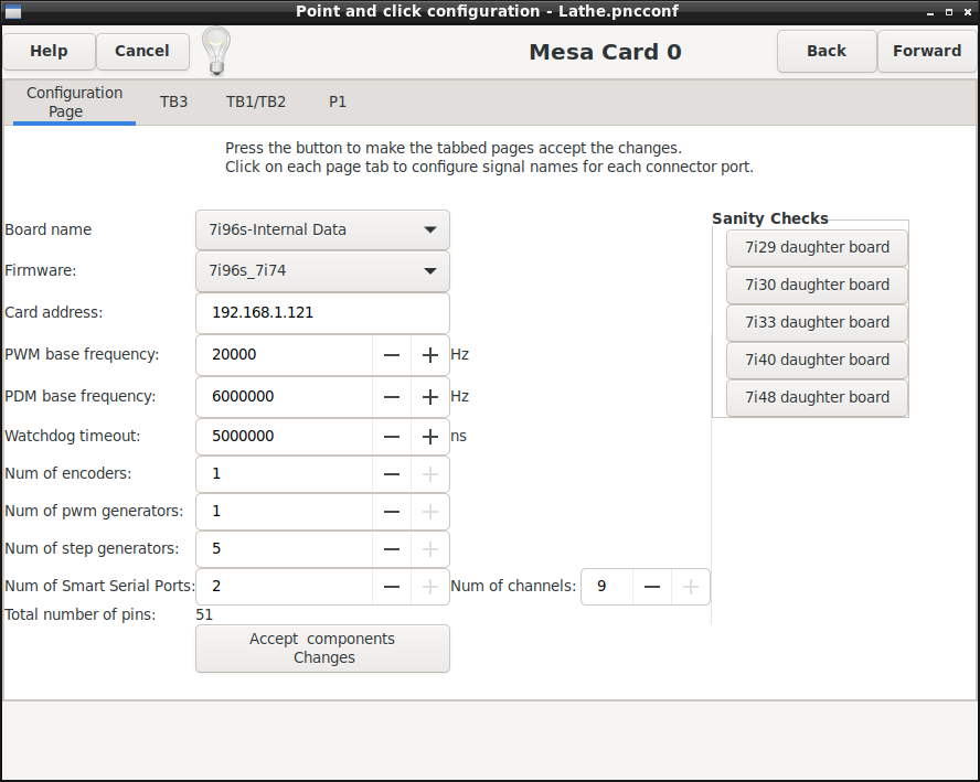

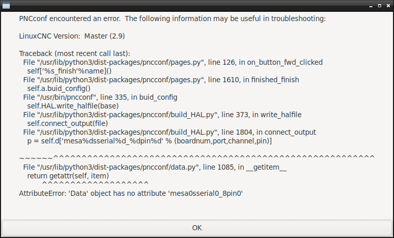

I am new with Linuxcnc and I am attempting to use a Mesa 7i96s board to run a CNC. I am using Linuxcnc version 2.9 with Debian 12 Bookworm on an RPi 4B. I am attempting to create the ini and hal file with PNCconf but once I finish filling out each of the steps and press "Done" I receive the error below.
PNCconf encountered an error. The following information may be useful in troubleshooting:
LinuxCNC Version: Master (2.9)
File "/usr/lib/python3/dist-packages/pnccof/pages.py", line 126, in on_button_fwd_clicked
self()
File "/usr/lib/python3/dist-packages/pnccof/pages.py", line 1610, in finished_finish
self.a.build_config()
File "/usr/bin/pncconf", line 335, in build_config
self.HAL.write_halfile(base)
File "/usr/lib/python3/dist-packages/pnccof/build_HAL.py", line 373, in write_halfile
self.connect_output(file)
File "/usr/lib/python3/dist-packages/pnccof/build_HAL.py", line 1804, in connect_output
p = self.d
File "/usr/lib/python3/dist-packages/pnccof/data.py", line 1085, in__getitem__
return getattr(self, item)
AttributeError: 'Data' object has no attribute 'mesa0sserrial0_8pin0'

can you give details of what you selected on the mesa page? did you add a sserial card?
- MCSeifert
- Posts: 8
10 Sep 2023 22:40 #280438
by MCSeifert
Replied by MCSeifert on topic PNCconf encountered an error

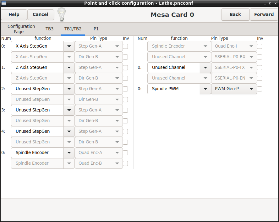

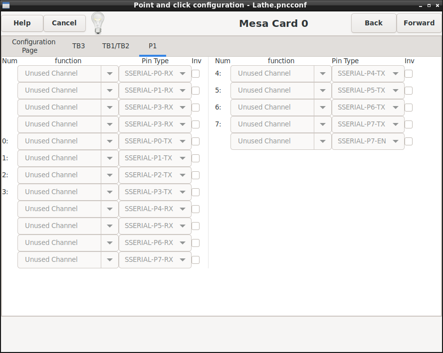

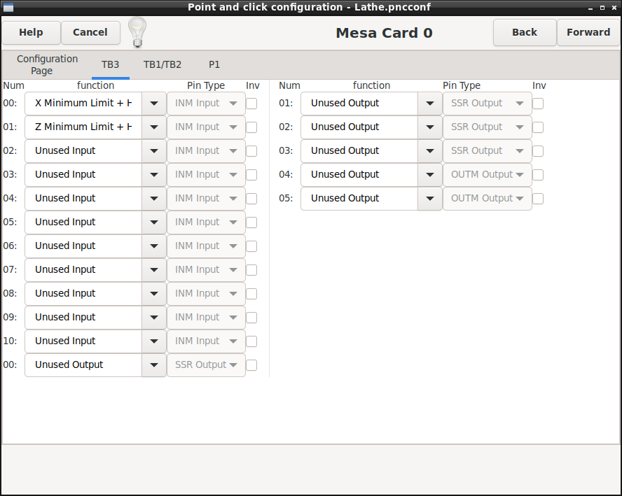

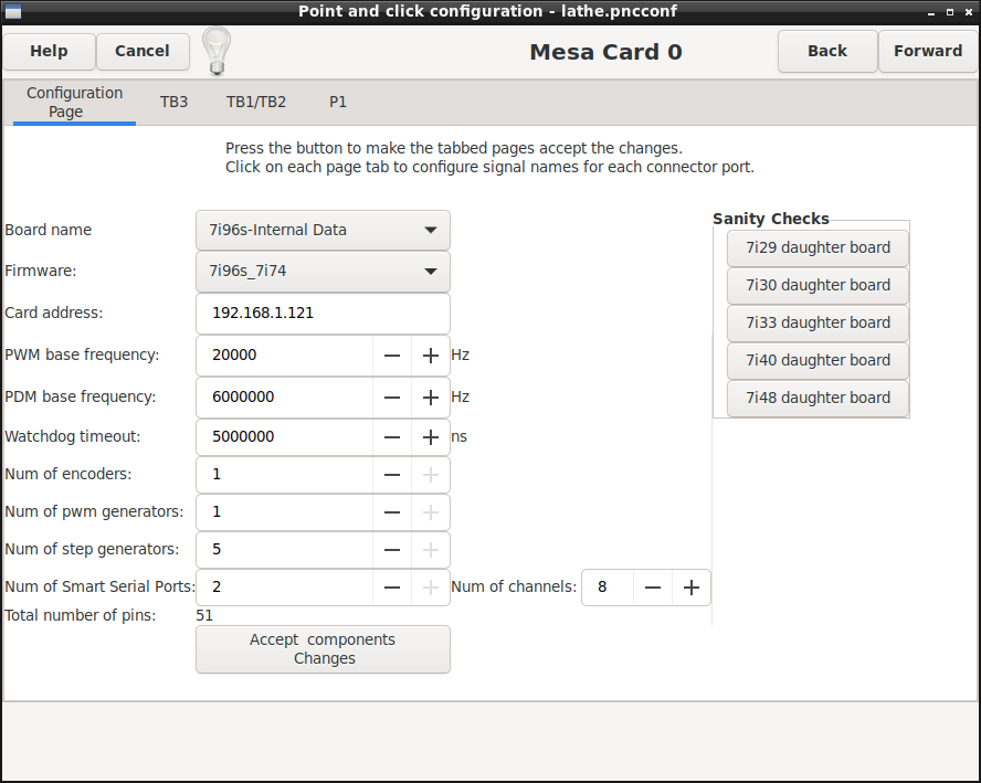

I have attached screen shots of what I did on the Mesa Card page. I did not add a sserial card just X Z and spindle information.

Strangely the first screen shows 9 channels of sserial - I think that should be only 8.
In my system i can't set it to 9 at all.
Try setting it to 8
Try setting it to 8
