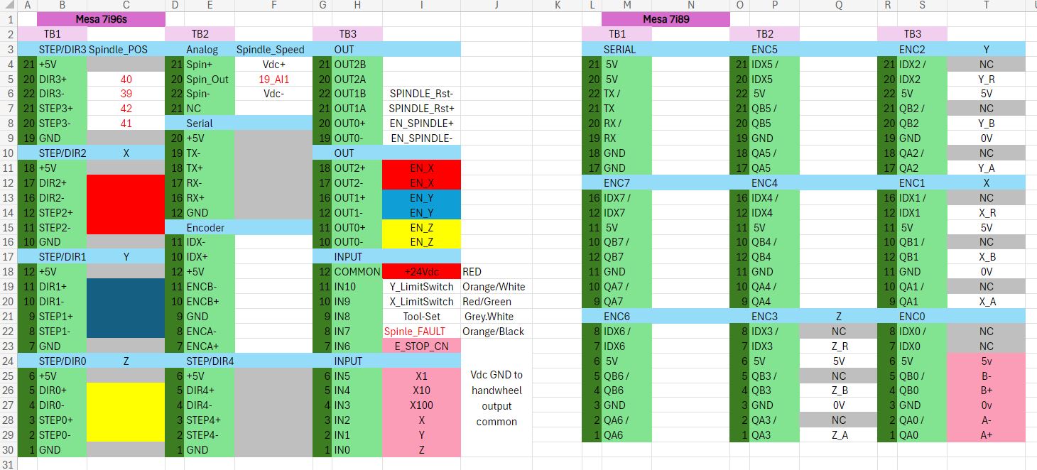

by JohnnyBeluga
7i96s + 7i89 analog spindle and mpg troubles was created by JohnnyBeluga
ChatGPTCertainly! Here is a corrected version of your post for the LinuxCNC forum:Hi!I need some help with my LinuxCNC setup. I'm having trouble adding an MPG pendant and getting the spindle to work correctly. I have tried different solutions, but I'm obviously missing something. When I launch my configuration, I can jog the three axes through the GUI, but the MPG doesn't work. I tried adapting the custom HAL file with an example file and setting up the jog wheel through PNCconf. I'm also struggling with the spindle's analog control. I tested the spindle, and it works as expected with a variable voltage supply, reaching 2500 RPM at 5V.
Any hints or suggestions on what I might be doing wrong or what to check would be greatly appreciated!Thanks in advance for your help!

Thank you for the help, Yes I suppy 5v to TB2 pin 24. I made the changes in the .hal and ini files but spindle still doesn't move.
The jogging work trough the GUI but my MPG pendant doesn't work I tried to adapt the example file avaible for MPGs. The MPG switches part is in custom.hal and the handwheel in the main hal file.

After re-checking I had the wiring changed yeasterday to try the spindle with the variable power supply. I rewired and with your changes it's working well.

# In position mode the axis will move exactly jog-scale
# units for each count, regardless of how long that might take,
setp axis.x.jog-vel-mode 1
setp axis.y.jog-vel-mode 1
setp axis.z.jog-vel-mode 1
# This sets the scale that will be used based on the input to the mux4
setp mux4.0.in0 0.1
setp mux4.0.in1 0.01
setp mux4.0.in2 0.001
# The inputs to the mux4 component
net scale1 mux4.0.sel0 <= [HMOT](CARD0).inm.00.input-04
net scale2 mux4.0.sel1 <= [HMOT](CARD0).inm.00.input-03
# The output from the mux4 is sent to each axis jog scale
net mpg-scale <= mux4.0.out
net mpg-scale => axis.x.jog-scale
net mpg-scale => axis.y.jog-scale
net mpg-scale => axis.z.jog-scale
# The MPG inputs
net encoder-counts <= [HMOT](CARD0).encoder.02.count
# The Axis select inputs
net mpg-x axis.x.jog-enable <= [HMOT](CARD0).inm.00.input-02
net mpg-y axis.y.jog-enable <= [HMOT](CARD0).inm.00.input-01
net mpg-z axis.z.jog-enable <= [HMOT](CARD0).inm.00.input-00
# The encoder output counts to the axis. Only the selected axis will move.
net encoder-counts => axis.x.jog-counts
net encoder-counts => axis.y.jog-counts
net encoder-counts => axis.z.jog-counts
The mux4 component uses a binary code on the
select pins so 2 pins can select 4 different inputs:
SEL1 SEL0 INPUT
0, 0 in0
0, 1 in1
1, 0 in2
1, 1 in3
This should be closer:
I tried to add this to my previous config and then decided to go from the original example hal.
# Include your custom HAL commands here
# This file will not be overwritten when you run PNCconf again
########MPG_Pendant##########
loadrt mux4 count=1
addf mux4.0 servo-thread
# For velocity mode, set to 1
# In velocity mode the axis stops when the dial is stopped
# even if that means the commanded motion is not completed,
# For position mode (the default), set to 0
setp mux4.0.in0 0.1
# The MPG inputs
SEL1 SEL0 INPUT
0, 0 in0
0, 1 in1
1, 0 in2
1, 1 in3
Last edit: 01 Jun 2024 19:38 by PCW.
The following user(s) said Thank You: JohnnyBeluga
- JohnnyBeluga
- Posts: 17
01 Jun 2024 21:51 #302112
by JohnnyBeluga
Replied by JohnnyBeluga on topic 7i96s + 7i89 analog spindle and mpg troubles
It makes sense now. [HMOT](CARD0).encoder.02.count was not really connected to axis.N.jog-counts. I think I finally understand the working principle of mux4 and how to adapt it to my setup and wiring. I rechecked the wiring and the output of the MPG on my oscilloscope. The switches also go high (+24V) when selected and the enable button is pressed.
Should I link the final motion function axis.N.jog-counts somewhere in the main HAL file ?
