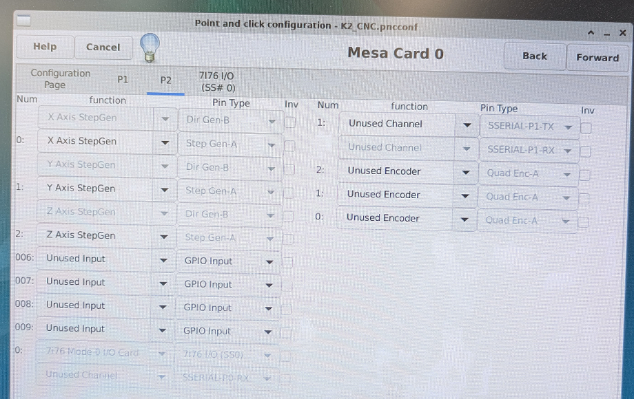

in PNCConf how do I assign a StepGen to the specific pins on the parallel port?
Background
I found myself with a K2 CNC router. The parallel pinouts are non-standard
I was able to get it working in StepConf on an old machine with a built-in parallel port, but I wanted to get it running under the 7i92TM. I have 2 other machines running with these cards. I configured the card and cold-swapped it into one of the other machines and it worked perfectly.
But I must have just gotten lucky and the pin mappings were magically perfect on those other two machines because I can't find anywhere where I can assign the pins to the axes in PNCCONF.
I think it should be P2 on the attached PNG file, but on the far left column it says, "Num" 0, 1 and 2 and it assigns those to the stepgen.
But I can't figure out how to configure the StepGen to the specific pins.
I know it's some simple step I missed, but I'm totally wrapped around the axle on this.

You cannot change the pinout of a specific firmware, you need
to choose firmware that matches the breakout you use.
You can change which stepgen runs which motion axis.
What breakout board do you need to support? For most
breakouts there are specific firmware files that match
their pinouts.
You can check pinouts by looking at the .pin files in the 7I92.zip
firmware distribution zip file (in /configs/hostmot2)
their pinouts.

In this case the control box contains the breakout board
There is no need to re-route signals, you just need firmware that
matches the required pinout.
Firmware is updated with the mesaflash tool, but the first step
is to determine the required pinout of your breakout
Do you have this pinout available?
(a working hal file created with stepconf would include this information)

Yes, I do.
X Step 4
X Dir 5
Y Step 2
Y Dir 3
Z Step 6
Z Dir 7
X Home 12
Y Home 11
Z Home 13
E-stop 10
Is the next step finding firmware that happens to match the above? Or can I use the tool to poke the values into the right place, maybe using
--wpo address value Write hostmot2 variable directly at 'address' with 'value'.
Thanks so much for your guidance!
X Step 4
X Dir 5
Y Step 2
Y Dir 3
Z Step 6
Z Dir 7
X Home 12
Y Home 11
Z Home 13
E-stop 10
Last edit: 13 Aug 2024 22:02 by DougM.
- Posts: 18111
- Thank you received: 5330
13 Aug 2024 22:04 - 13 Aug 2024 22:04 #307670
Replied by PCW on topic Mesa 7I92TM Parallel port pin mapping
7i92t_5abobx2d.bin should work with:
Stepgen0 --> Y axis
Stepgen1 --> X axis
Stepgen2 --> Z axis
Also in pncconf, set the number of stepgens to 3,
and the number of pwmgens and encoders to 0 to
free up the other pins so they can be used as
GPIO if needed.

I still get no movement in any of the axes. I wonder if there's something I am not properly enabling? I didn't setup the Home or e-stop signals.
Thank you for your continued assistance,
Here is the output of readhmid:
Configuration Name: HOSTMOT2
BoardName : MESA7I92
FPGA Size: 20 KGates
FPGA Pins: 256
Number of IO Ports: 2
Width of one I/O port: 17
Clock Low frequency: 100.0000 MHz
Clock High frequency: 180.0000 MHz
IDROM Type: 3
Instance Stride 0: 4
Instance Stride 1: 64
Register Stride 0: 256
Register Stride 1: 256
Modules in configuration:
Module: DPLL
There are 1 of DPLL in configuration
Version: 0
Registers: 7
BaseAddress: 7000
ClockFrequency: 100.000 MHz
Register Stride: 256 bytes
Instance Stride: 4 bytes
Module: WatchDog
There are 1 of WatchDog in configuration
Version: 0
Registers: 3
BaseAddress: 0C00
Module: IOPort
There are 2 of IOPort in configuration
Version: 0
Registers: 5
BaseAddress: 1000
Module: QCount
There are 2 of QCount in configuration
Version: 2
Registers: 5
BaseAddress: 3000
Module: StepGen
There are 10 of StepGen in configuration
Version: 2
Registers: 10
BaseAddress: 2000
Module: PWM
There are 2 of PWM in configuration
Version: 0
Registers: 5
BaseAddress: 4100
ClockFrequency: 180.000 MHz
Module: LED
There are 1 of LED in configuration
Version: 0
Registers: 1
BaseAddress: 0200
Configuration pin-out:
IO Connections for P2
DB25 pin# I/O Pri. func Sec. func Chan Sec. Pin func Sec. Pin Dir
1 0 IOPort PWM 0 PWM (Out)
14 1 IOPort None
2 2 IOPort StepGen 0 Step/Table1 (Out)
15 3 IOPort None
3 4 IOPort StepGen 0 Dir/Table2 (Out)
16 5 IOPort StepGen 8 Step/Table1 (Out)
4 6 IOPort StepGen 1 Step/Table1 (Out)
17 7 IOPort StepGen 8 Dir/Table2 (Out)
5 8 IOPort StepGen 1 Dir/Table2 (Out)
6 9 IOPort StepGen 2 Step/Table1 (Out)
7 10 IOPort StepGen 2 Dir/Table2 (Out)
8 11 IOPort StepGen 3 Step/Table1 (Out)
9 12 IOPort StepGen 3 Dir/Table2 (Out)
10 13 IOPort None
11 14 IOPort QCount 0 Quad-A (In)
12 15 IOPort QCount 0 Quad-B (In)
13 16 IOPort QCount 0 Quad-IDX (In)
IO Connections for P1
1 17 IOPort PWM 1 PWM (Out)
14 18 IOPort None
2 19 IOPort StepGen 4 Step/Table1 (Out)
15 20 IOPort None
3 21 IOPort StepGen 4 Dir/Table2 (Out)
16 22 IOPort StepGen 9 Step/Table1 (Out)
4 23 IOPort StepGen 5 Step/Table1 (Out)
17 24 IOPort StepGen 9 Dir/Table2 (Out)
5 25 IOPort StepGen 5 Dir/Table2 (Out)
6 26 IOPort StepGen 6 Step/Table1 (Out)
7 27 IOPort StepGen 6 Dir/Table2 (Out)
8 28 IOPort StepGen 7 Step/Table1 (Out)
9 29 IOPort StepGen 7 Dir/Table2 (Out)
10 30 IOPort None
11 31 IOPort QCount 1 Quad-A (In)
12 32 IOPort QCount 1 Quad-B (In)
13 33 IOPort QCount 1 Quad-IDX (In)
and here is the current HAL file (after manual edits for num_encoders, num_stepgens and num_pwmgens)
Last edit: 16 Aug 2024 16:18 by DougM. Reason: add reload comment
