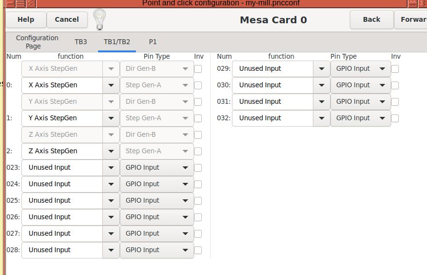

Is there a chart somewhere that correlates the 3 digit I/O number shown in pncconf with their physical terminal on the board? I assume those 3 digit numbers are a number used by the firmware to represent the pin, but on the board, by the time you try and subtract out the power and ground pins, and try and figure out how many actual I/O pins an encoder or serial port uses, it's almost impossible to tell what's being configured. I've been trying to compare with the board drawing from the Mesa 7i96 manual, and also with the actual board, and I'm coming up empty.
I'm referring to the 023 to 032 numbers in this screenshot.

The mesa manual for your card outlines it all.
the physical pins are generally numbered from 1 but the pin numbers start with 0

The .pin file in the firmware package has that info (if you know the firmware it was programmed with) or you can use mesaflash with the readhmid command (after adding the address & such)
example 7i96_5abob_d.pin file for 7i96 if programmed with 7i96_5abob_d.bit file

I don't actually know what firmware I have, nor have I downloaded any. I assumed it shipped with the firmware I need.
The manual corresponds to a specific firmware, no? So the information could/should be in the manual.

mesaflash has provided me with the table I wanted.
Replied by pgf on topic correspondence of unused i/o pins to physical connector location?
No need to apologize. I've been working at Unix/Linux command line prompts since 1980.If not you can redirect the mesaflash output to a text file.
Don't mind me I still spend a bit of time using the command line in Linux. Just find it can be a bit quicker at times.

Although, I don't understand why the pin func for the Stepgens are all "Step/Table1" and "Dir/Table2". I would have expected an index between 1 and 5 (or 0 and 4).
IO Connections for TB1/TB2 -> 7I96_1
Pin# I/O Pri. func Sec. func Sec. Pin func Sec. Pin Dir
TB1-2,3 17 IOPort StepGen Step/Table1 (Out)
TB1-4,5 18 IOPort StepGen Dir/Table2 (Out)
TB1-8,9 19 IOPort StepGen Step/Table1 (Out)
TB1-10,11 20 IOPort StepGen Dir/Table2 (Out)
TB1-14,15 21 IOPort StepGen Step/Table1 (Out)
TB1-16,17 22 IOPort StepGen Dir/Table2 (Out)
TB1-20,21 23 IOPort StepGen Step/Table1 (Out)
TB1-22,23 24 IOPort StepGen Dir/Table2 (Out)
TB2-2,3 25 IOPort StepGen Step/Table1 (Out)
TB2-4,5 26 IOPort StepGen Dir/Table2 (Out)
TB2-7,8 27 IOPort QCount Quad-A (In)
TB2-10,11 28 IOPort QCount Quad-B (In)
TB2-13,14 29 IOPort QCount Quad-IDX (In)
TB2-16,17 30 IOPort SSerial RXData0 (In)
TB2-18,19 31 IOPort SSerial TXData0 (Out)
Internal-TXEn 32 IOPort SSerial TXEn0 (Out)
Internal 33 IOPort SSR AC Ref (Out)
