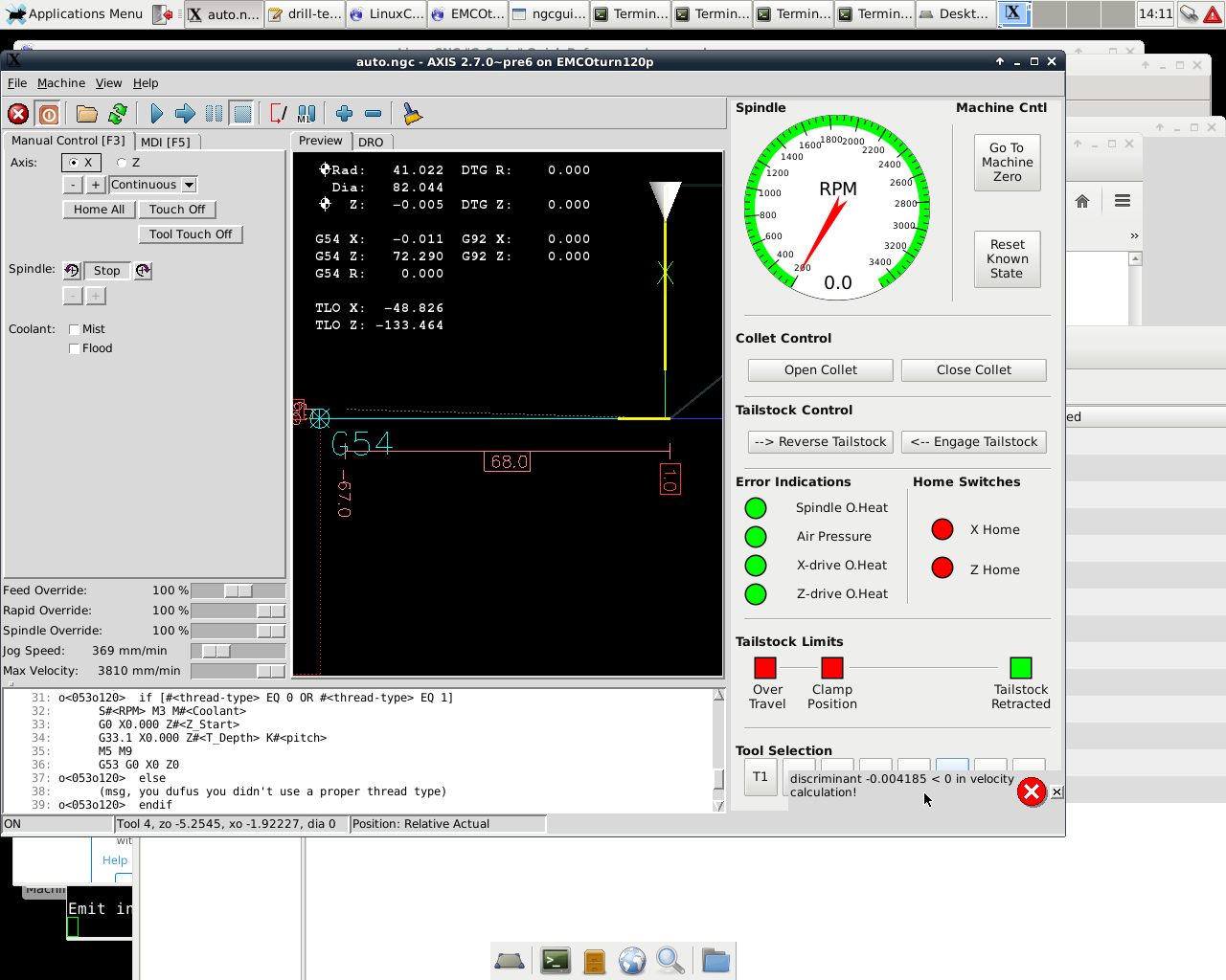

27 Jul 2015 19:58 #60957 by skunkworks
Replied by skunkworks on topic rigid tapping fail advice and "discriminant" err
Could you give us a short gcode example that shows the discrim error? (and your ini file)
If you are energetic - you could try this branch and let us know if it fixes your issue. (it is not perfect yet)
github.com/robEllenberg/linuxcnc-mirror/...gent-improvement-2.7
sam
28 Jul 2015 01:43 - 28 Jul 2015 01:47 #60965 by tome
sam
Sam,
Attached are the ngc file I run and an image of the error it generated. Again, this doesn't happen every time, but does happen quite often.
-Tom
