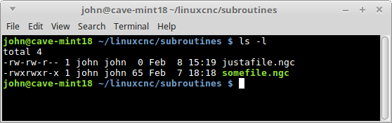

linuxcnc.org/docs/2.7/html/gcode/overvie...de:file-requirements
There is a big difference between wrapping G code with a pair of %% and using M2 to end a file.
Also note that the subroutine file name and the subroutine name must match and the file must be executable and I know I put that in the docs but dang if I an find it now. This is an example subroutine file.
Edit: make sure the SUBROUTINE_PATH = /home/yourusername/linuxcnc/subroutines is a valid path in the [RS274NGC] section of the ini file.
Edit: call the subroutine file like this:
JT
(file somefile.ngc)
o<somefile> sub
G0 X2
o<somefile> endsub
M2Edit: make sure the SUBROUTINE_PATH = /home/yourusername/linuxcnc/subroutines is a valid path in the [RS274NGC] section of the ini file.
o<somefile> call
M2JT

Ok, I made all files executable. It had no effect.
