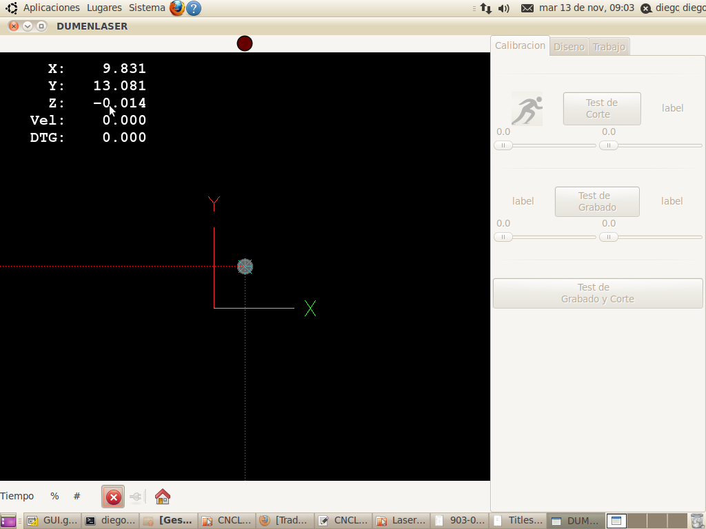

Ok I understand but I want to know for information only. Other question I have a problem with HAL Gremlin. It have a offset position and I don't know why? I adjunt the image with my error
Another question, how I can make cleaning the area of component gremlin? Axis also has his paintbrush

If you triple click the view it will clear.
or a python call to (assuming the widget is called gremlin):
gremlin.clear_live_plotter()
I assume you are rolling your own GUI in python

I tried with triple clic and it don't work. It work with double right clic. My GUI is with touch screen and doesn't exist right clic jejeje. I will try with a button for clean with phyton commands. Thanks

Sorry double right click clears the gladeVCP graphics, unless that been overridden (like Gscreen does)
It using a touch screen you really must program a button to do it.
