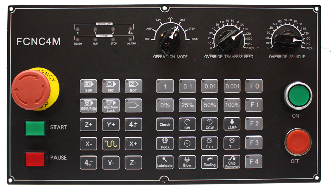

Hello.
This topic is for those that have a Adtech fcnc4m operation panel in there waste bin.
I'm helping a friend to put LinuxCNC on an Bridgeport that use to have DC-servos. He bought a Chines AC-servo system
to upgrade the machine. Included was the Adthec controller and panel. He wanted to keep the panel so we started back engineering
the protocol.
It ended up as a user_comp. The basic functions is working, so I put it here for the community. It is written in C.
So test it, use it, change it or disregard it.
The machine is under mechanical rebuild so it will take some time before it is ready for LinuxCNC.
Kjell Claesson
P.S. There is a open document with some info, and a draft of a man page included. It need some more work.

Nice work in progress
can you make some images on the Mashine Panel
is it the main panel of the mashine you are interfearing with the comp

Hi.
It is the extra control panel. Attache a picture of the panel.
